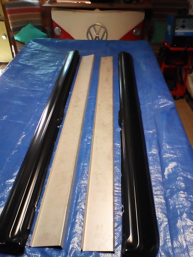

... here you go - I've also got these
- sills.jpg (135.47 KiB) Viewed 698 times

Re: Gimme 5 years
Posted: Wed Apr 15, 2020 7:41 pm
Yeah, know that one. See if you can get a bit of fence wire and poke through from the holes in the front through to the hole at the outer leg to sill attachment or vice versa. There is often rust in the firewall behind the apron if you go looking. You want to pump the subframe full of fish oil after it is painted.
Re: Gimme 5 years
Posted: Wed Apr 15, 2020 9:08 pm
by rosco
Errol62 wrote: Wed Apr 15, 2020 7:41 pm
Absolutely, Clay - and don't forget to fit rubber bungs into the two outrigger holes on the stonetray/front subframe section - they are wonderful entries for crap getting in and rusting everything up in the corners... make sure the drain holes in each corner underneath are kept open too...

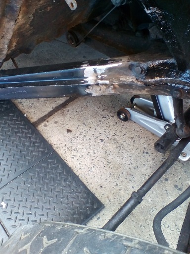

put in a new driver's side outer subframe leg
- 1.jpg (153.96 KiB) Viewed 638 times

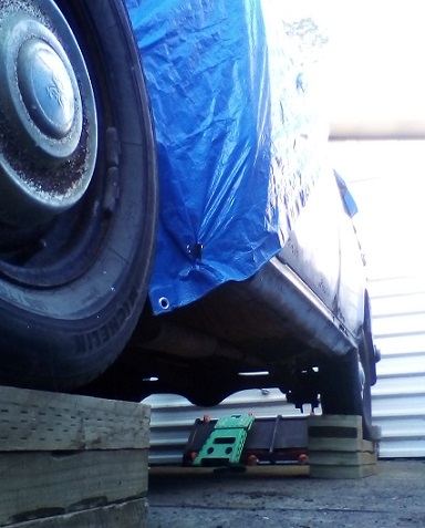

I put the back wheels on blocks as well. That'll be it's resting place for a while and I need my ramps for other cars.
- 2.jpg (122.19 KiB) Viewed 638 times
