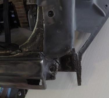

The sill itself wasn't too bad. I used offcuts from the left outer sill that I replaced to make the patches. While I had the holes open cleaned out the cavity as best I could and sprayed a fair amount of Penetrol around.

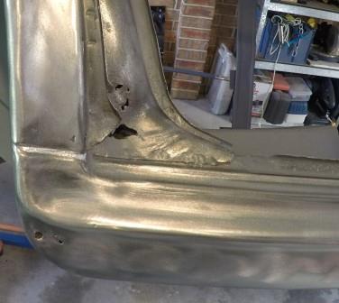

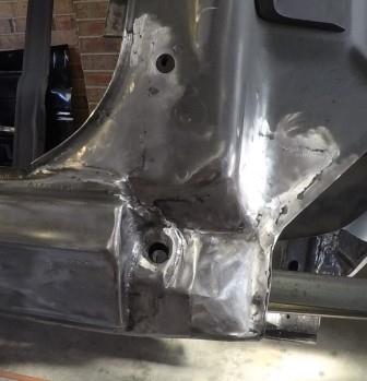

Bottom of the A pillar wasn't great, not as bad as the passenger side and at least I salvaged the bolt hole.
RH A Pillar fixed.JPG (34.92 KiB) Viewed 1340 times

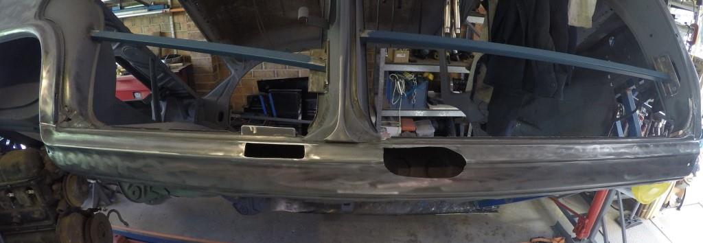

Still have to address a few small areas in the dogleg and then tackle the rear quarter mess.

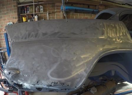

RR Qtr.JPG (39.13 KiB) Viewed 1340 times
A patch panel will fix the visible issues but what the picture doesn't show is that the back half of the panel is very dimpled. I might attempt some panel beating to start with - You Tube makes it look pretty straight forward... :think: but I do also have a full rear quarter cut I could use. Bit nervous about doing a large replacement job though.

Hi Dave, good to hear from you🙂. Yes, I saw that dimpling a few weeks ago and it's pretty savage. Agree it is still probably less of a task than doing the cut. Impressive metal work as always.

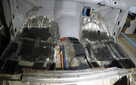

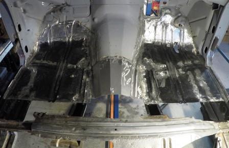

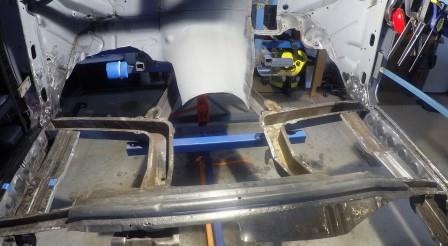

The rear qtr panel has scared me off for now so got onto to the lack of flooring...
No floor.JPG (40.11 KiB) Viewed 1262 times

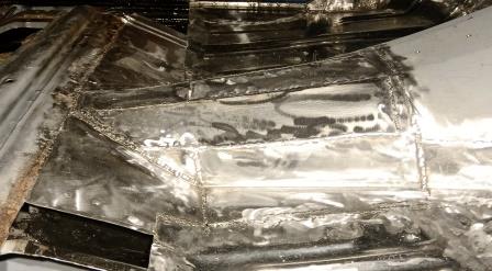

Rares pans went into with some massaging. And I did KBS all the support structures.
Rares pans.JPG (41.01 KiB) Viewed 1262 times
Did some patchwork for the footwells. Beads aren't quite the same size and despite trying to creep up on my patch shapes still managed to get it wrong. So not perfect but finessing with heat, relief cuts and hammer it's good 'nuff. All be covered anyway.
Foot well patches.JPG (40.97 KiB) Viewed 1262 times

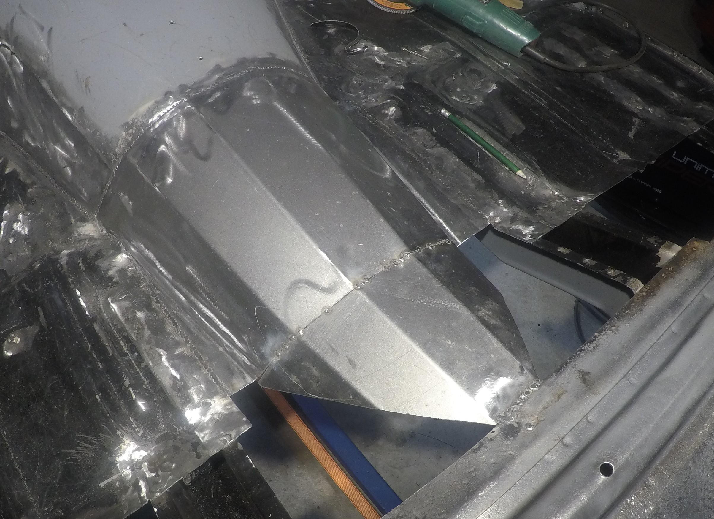

And the first bit of extending the tunnel. Not fully welded in yet but worked pretty well.
Dave

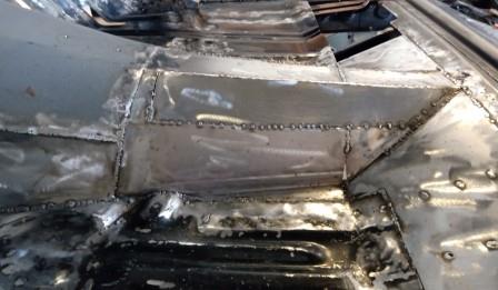

So the first bit of transmission tunnel went well. But after I added on the second bit I wasn't so sure...
Tunnel wrong angle.JPG (975.44 KiB) Viewed 1171 times

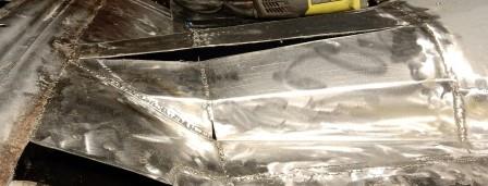

The tail of it was kicked up at an angle to finish in the right spot at the crossmember. I had done the tunnel in two bits as my bender is only 300mm wide. And with hindsight I should have welded them together first before coz I obviously didn't get the right angle to start with. It looked like it only dipped 20mm at the join and I tried to convince myself there would be room for the Hydromatic (but I don't really know). In the end it bugged my so much I had to fix it.
Tunnel fix.jpg (23.68 KiB) Viewed 1171 times
Pretty easy in the end. I just cut away the top panel from each side and cut the top panel where I had welded the two tunnel bits together. This let me push it up into the correct position and cut and butt it into place. Then shaped new side panels and welded them in. Lots of welding all up but better result.
tunnel sides.jpg (29.52 KiB) Viewed 1171 times
tunnel finished.jpg (32.1 KiB) Viewed 1171 times

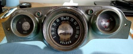

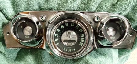

While I was contemplating what to do with the tunnel I dug out the instrument cluster
Instrument cluster b4.jpg (24.55 KiB) Viewed 1171 times
Instrument cluster 2.jpg (31.34 KiB) Viewed 1171 times

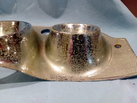

There was some nasty oxidation (??) on the chrome and while there is still some pitting it cleaned up nicely
cluster finished.jpg (34.48 KiB) Viewed 1171 times
