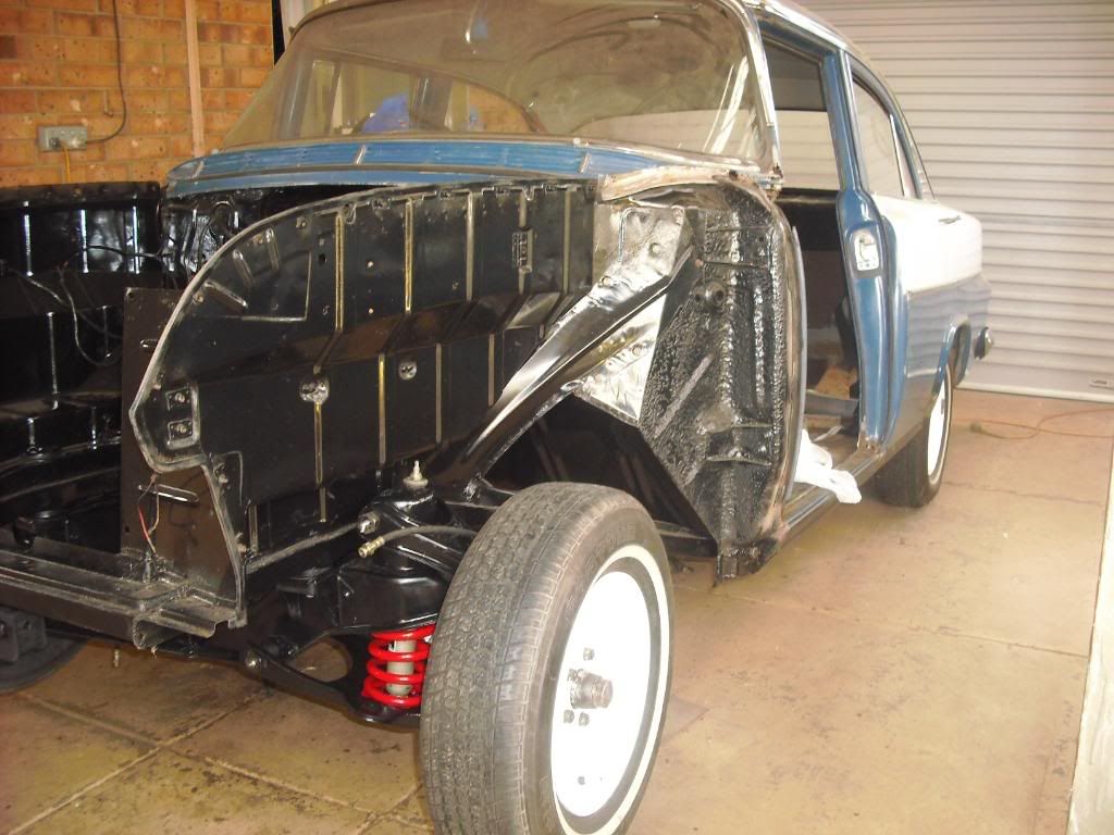

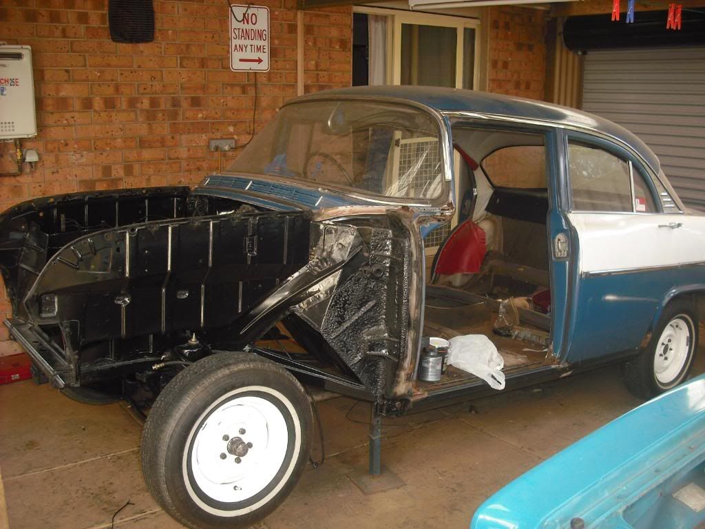

Hey guys, try not to be too hard on old Pauly at Pedders he is a mate of mine and alswys looks after me extremely well and does a good job. This is the first time he has had to do a job like this since he has lost quite a bit of weight. Before he said he was able to put his weight behind it and make it all work but now he struggles and he was a bit unsure how to takle it. Your right though it didn't compress the spring down enough.
Front end is all back in and she is back on all fours! :D

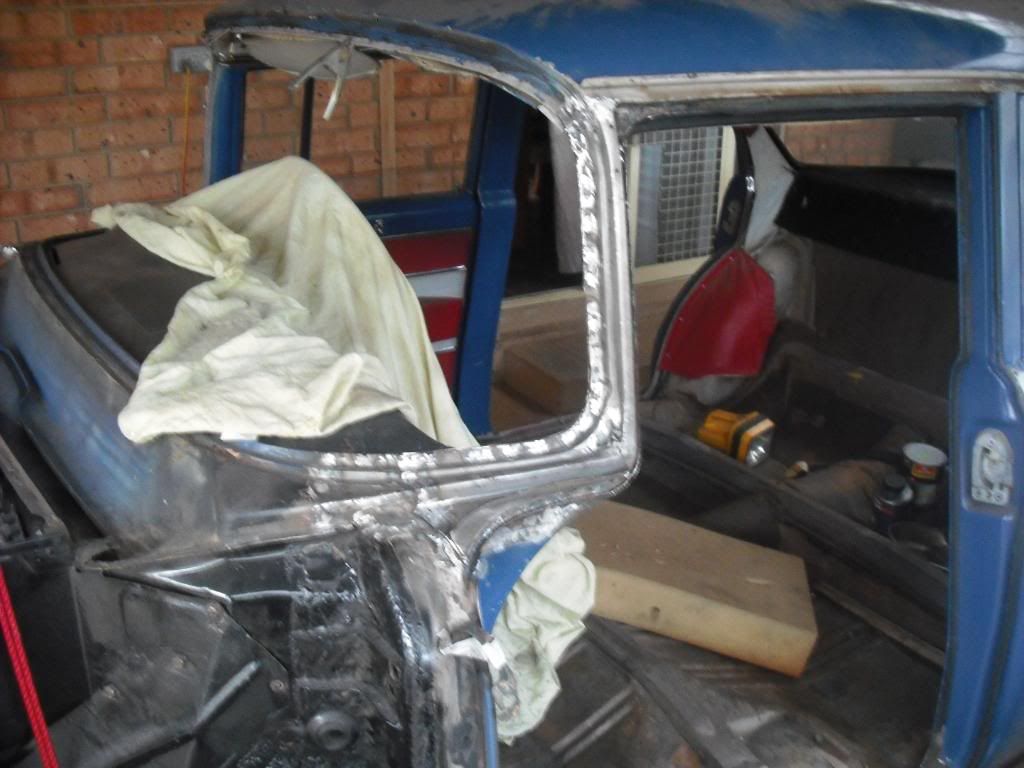

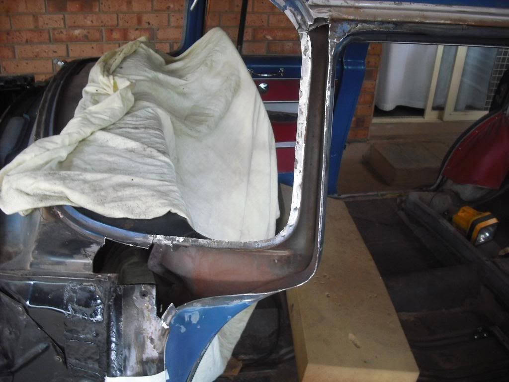

Then it was time to takle the nasty bit around the windscreen.
All the rusted crappy bits cut out
And the new piece from the donar section (Thanks Dave!) welded in.
