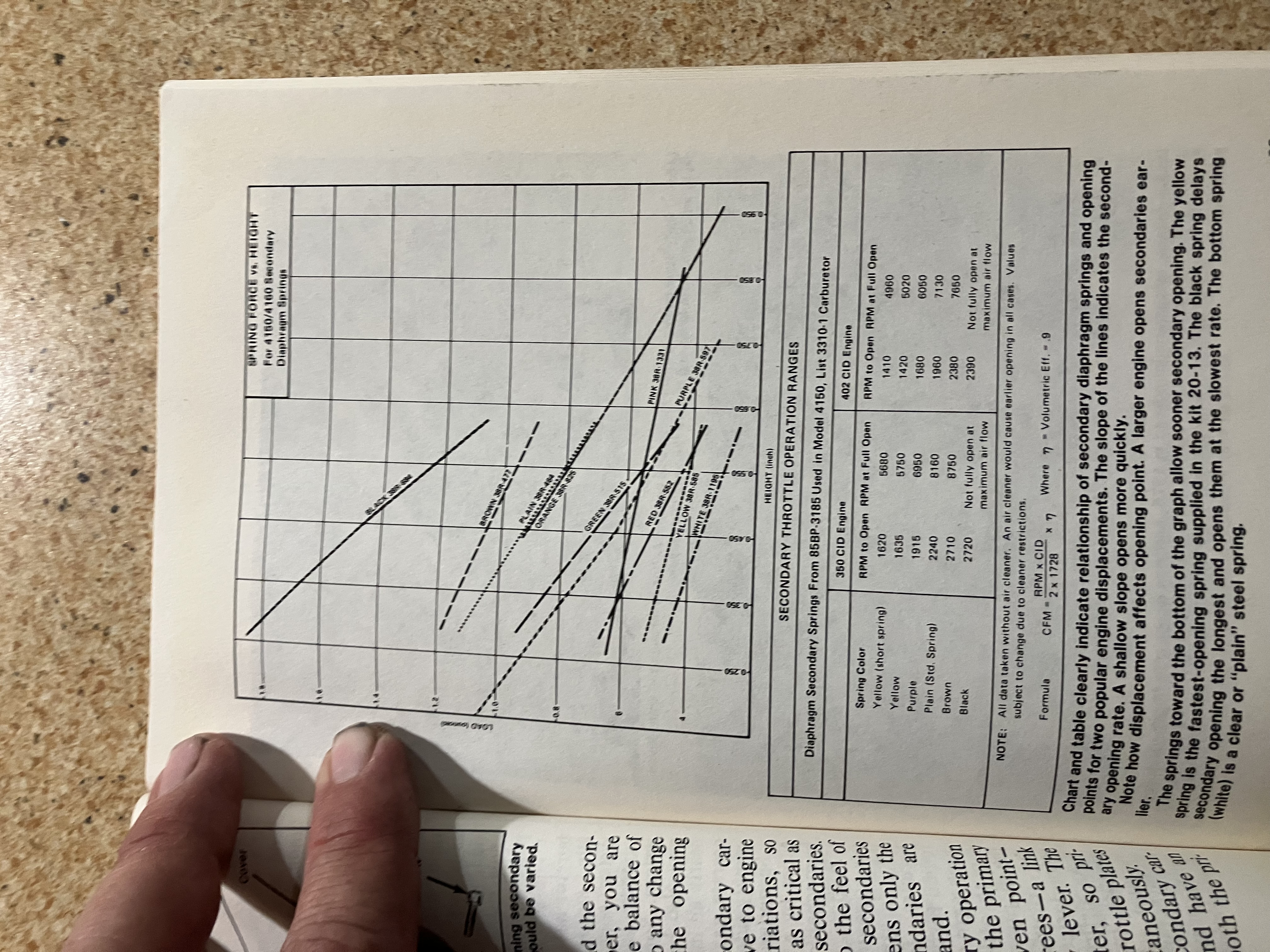

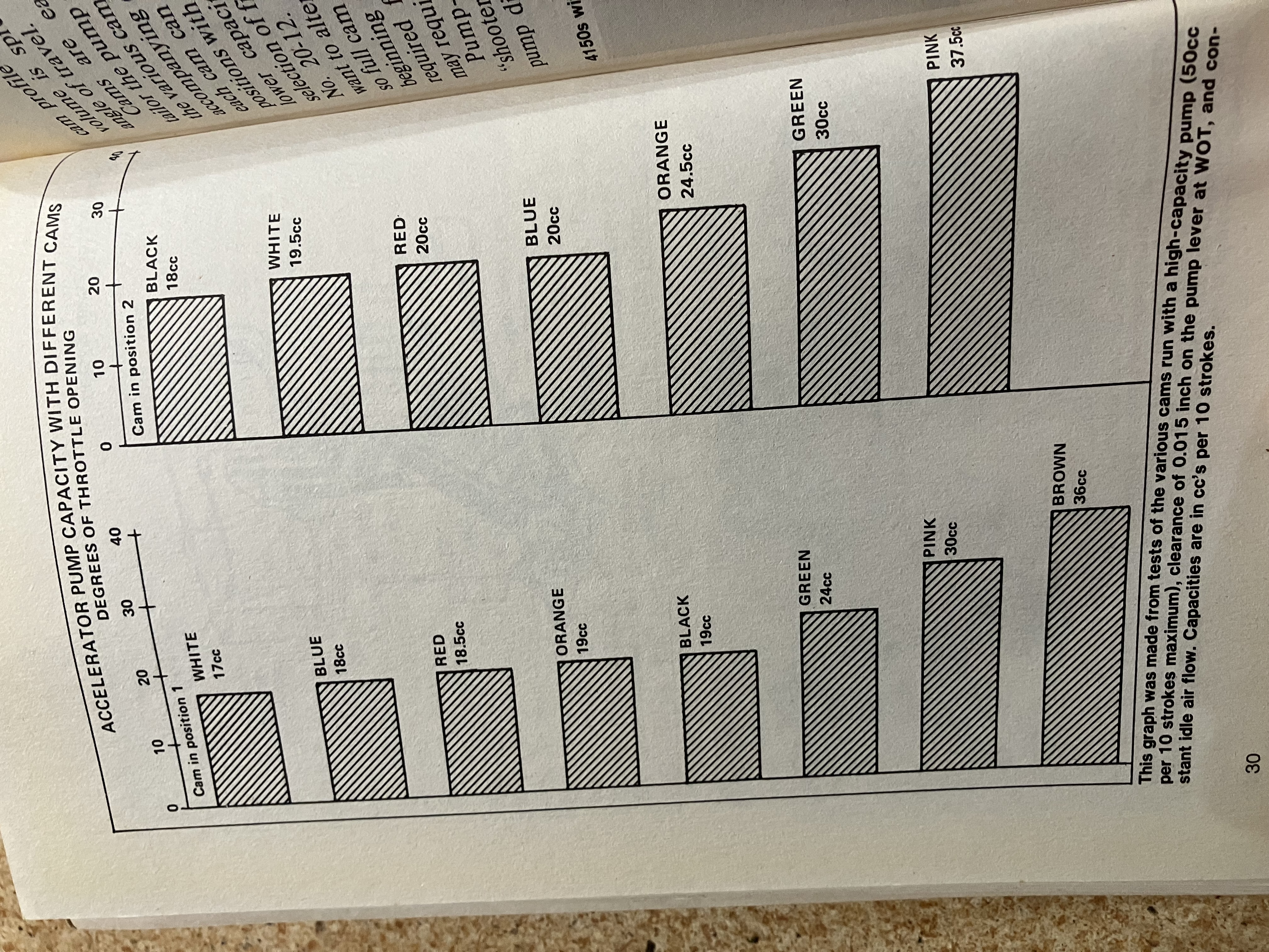

Secondary jets are 60. Unsure how to identify the pump spring.
Re: Blue Six induction
Posted: Sun Feb 02, 2025 6:56 pm
Or pump cam, which is in the first hole for lower idle speeds.
