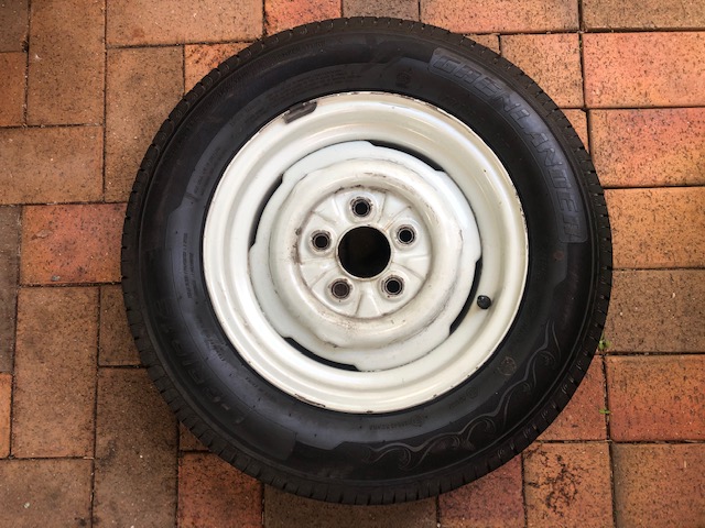

I’m positive that VB VK ran mainly 14x6JJ.
Rim I was told was HR recently, 1960 13x4” not in the mix above. The guy was sure it was early Holden pattern, but then he was pretty confident that it was HR. It did look 4.25”. Could be from a Vauxhall or something else of the era. Now I recognise these rims as they have non identical raised pressings between the luggoles. Never seen these before or at least didn’t recognise them.

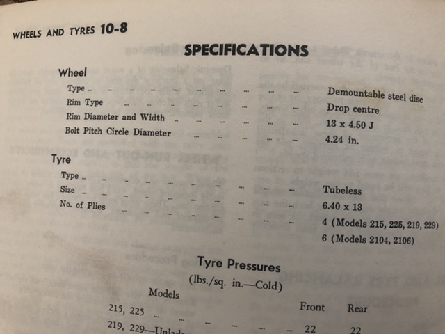

If it’s a typo, then it’s a consistent typo in the workshop manuals.

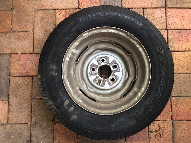

Pictured below are the standard FB/EK wheels.
Back spacing: 3 9/16”" (90mm)
Front spacing: 2 1/16” (52mm)
Offset +¾” (+19mm)
Flange to Flange: 5 5/8” (143mm)
Centre bore: 2½” (63mm)

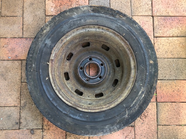

Unknown rim (Torana perhaps?) from under the house
Back spacing: 5 5/16”" (135mm)
Front spacing: 11/32” (9mm)
Offset +2 31/64? (+63mm)
Flange to Flange: 5 21/32” (144mm)

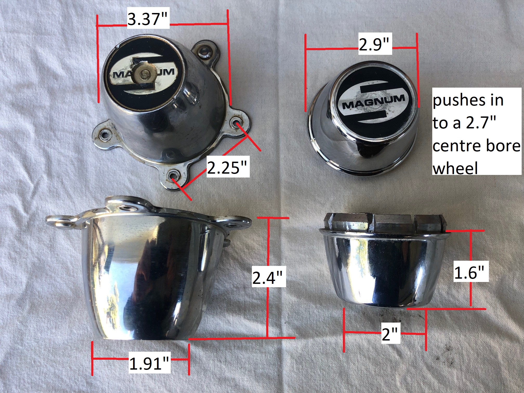

Some more Sampson info.
I've been hunting some centre caps. I have some push-in ones, but really want the 5-self tapper versions - some of my wheels are already drilled, I have a habit of losing push-in caps, some drag strip scrutineers don't like caps, and the push-in ones don't clear the meth monster front hubs.
I have a bunch of leads from my want ads from people who repro the caps, or at least ones similar. I was holding off though as a gentleman on the Ozrodders forum had original caps to send me. As far as he knows, there are two sizes of caps - large and small. The ones he sent me are the large ones. Photos below of both my push-in ones and the large 5-self tapper ones.
The large caps fit, but look a little bulky. They also (just) touch the wheel nuts, and I'd have to drill a second set of holes (the caps are 2.25" lug-to-lug, whilst my wheels have been drilled 1 13/16") The gentleman also had a single Delta cap (see below). This is the correct 1 13/16" lug-to-lug, but not tall enough to clear the front hub grease caps. I need something at least 1.6" deep to clear the hubs, unless I can think of a funky way to make a low profile grease cap.
So not sure yet if I will run the large Sampsons. Will do a ring around of the various contacts and see what I can find. At least now I have a good set of dimensions to work with.
