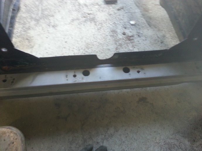

under radiator support couldn't believe some cowboy has just bogged over this .

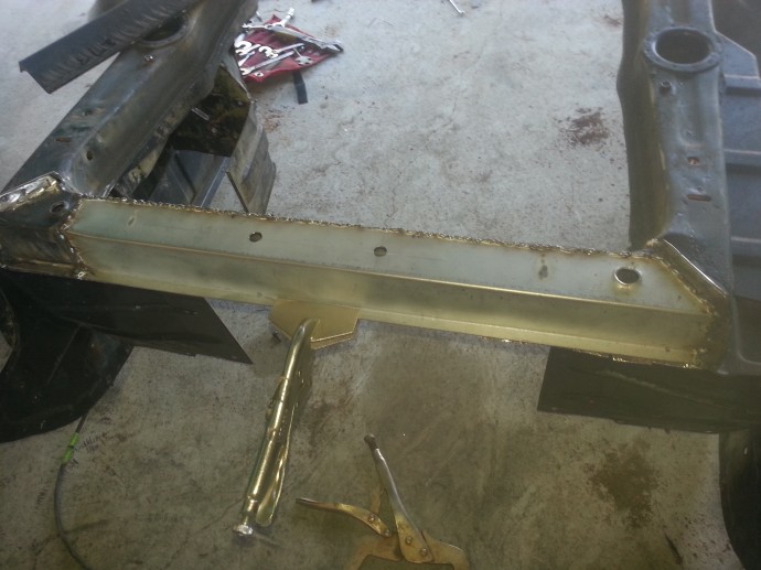

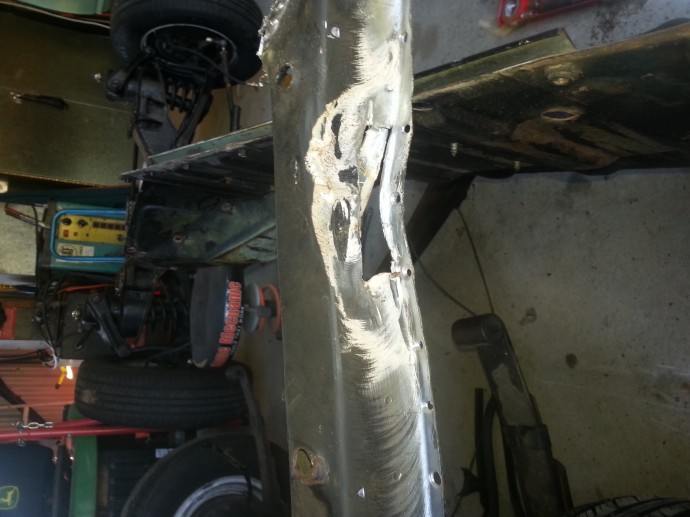

new section made
new section made
well today planning on finishing up welds and sand front clip back to bare did go out and buy a sand blaster but waste of time compressor just not big enough using some 3 inch quick change discs on the die grinder for the little nooks and nannies seem to be working well.
unfortunately work is getting in the way of this resto might have to change tis i think.

Great work Fishyweare.. exemplorary, in fact.
I am like an old worn out record - please! - put some blanking plugs in those two outrigger access holes when you finish putting it back together.
I still see many who have not done this. It's the biggest issue the subframe will ever have - crap gets washed/blown down through those two holes and can't get out.
It's an uphill climb backwards to get over/around the crossmember mounting bolts - and stuff just stays in there and rusts out the front corners.
When you had the subframe cut ope - you would have seen quite a bit of crap in there...
I drilled extra drainage holes along the bottom and in the corner to allow any water to get out... but leaves, rodent remnants and anything else which goes down those holes will become a poultice to entice rusting .... I lost my original sub-frame to this.
Yes, bog - hidden behind and under the lower baffle - grrrrr...... might have been a backyarder - but I wouldn't put it past a panelbeater either.
Big job to get to the front of the subframe and replace the section as you have done.
I'm guessing it ran into something and they just bogged it up then fitted replacement parts and sprayed it - bewdy! job done!

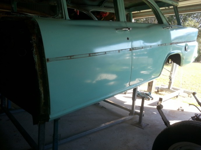

managed to do a little bit more this week

Fishy that drum is a later flat faced drum and you shouldn't use them with the standard rims. The standard drum is dished so it will mate up to the standard rim correctly. If you try and bolt a standard wheel rim up to a later drum you will distort the rim at its mounting face.

Bugger will check rims to see if any distortion yet cause I don't know how many years its been on there for.
what about the weights are these to balance the drum them self or ment to be on a particular side of the car . I am sure they are just to balance the drums but just need clarification.

Pretty sure they are just to balance the brake drum , cant imagine they would balance the axle or front hub with the drum ......
