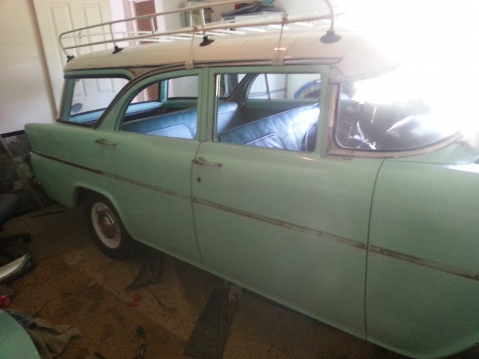

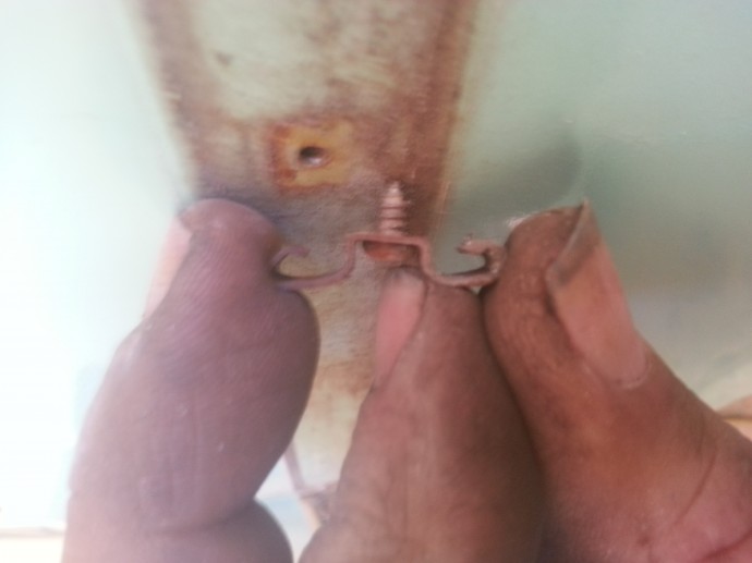

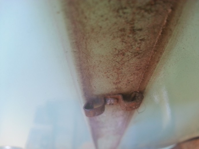

Started striping all trims and surprised on how easy everthing was coming off.
Remember how they go back on
One side done
One side done
Re: Wagon rebuild
Looks neat, why the reduild? Rust?

Trev while the motors out couldn't help myself best time to do it . I just wanted to make sure the gremlins haven't got to her

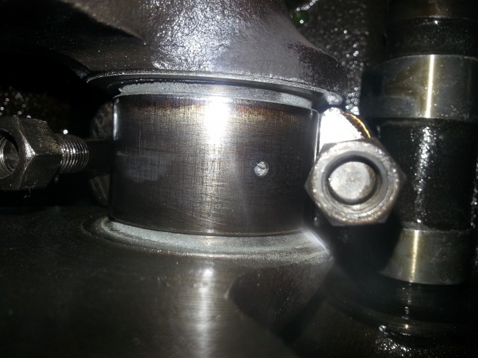

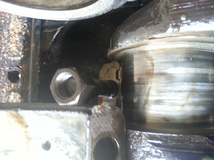

stripped motor down to find two very dry connector caps unfortunately bearings sitting at 30 thou and piston 60thou stamped on pistons, so stripped down a j Block which was looking way better so off to engine builder for a better look .
at time of typing this unsure if I am going to go the mild grey . was going to bolt the hydra backup behind it ( which I have no problems with the hydra) but since been looking at trimatic so went out and bought a HZ 1 tonner as a donor now thinking should I also bolt the 202 in as well ?I have a HR frontend lying in the shed but reading all the post regarding correct setup a little confused it has come out of a donor FB and tyres are really flogged out on sides which tells me it was never setup properly so may approach that as I go .
the plan was a mild grey same as I had done for my sons car except bolting on a Thomas with twin su's . now really unsure on which way to go. :boringg:
must of been really hot to dry up the oil

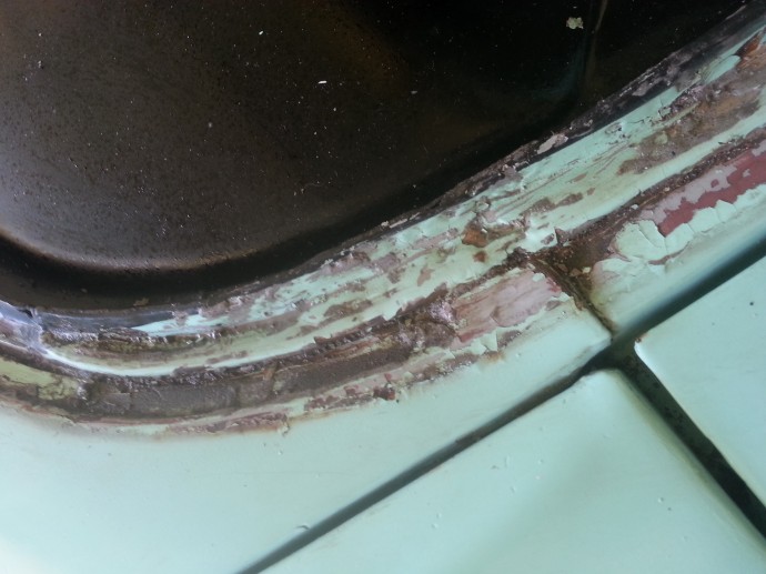

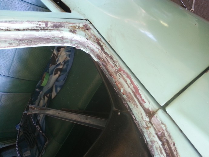

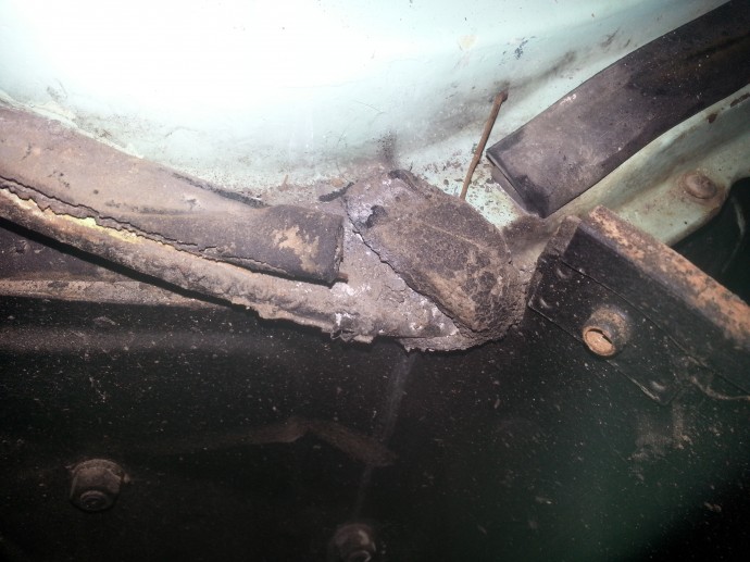

windscreen out and was expecting to see some horror but all good bit of surface rust on lip but nothing to worry about. YET.
windscreen out all looks pretty good .

Fishy was there an oil supply problem with the engine?
Fishyweare
Posts: 119
Joined: Sun Sep 08, 2013 5:51 pm
Re: Wagon rebuild
Post by Fishyweare »

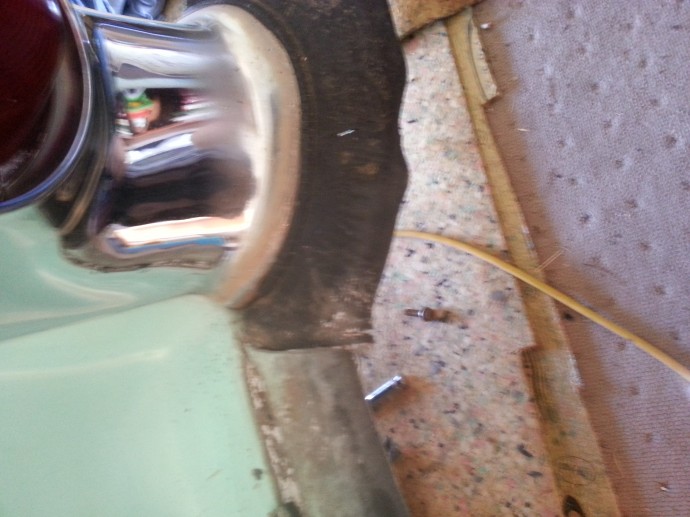

does anyone know if these seals are in the full rubber kits? noticed also there is a gasket between guard and body as well.
Fishyweare
Posts: 119
Re: Wagon rebuild
Craig Allardyce wrote:Fishy was there an oil supply problem with the engine?
Craig i don't believe so when i took it to the engine builder his thoughts were at some stage oil must of been low at some point of the engines lifetime , as all bearings showed a fair bit of wear sump was pretty clear of sludge thinking that maybe one of the journals had blocked up .but with saying that oil pump is been checked for wear as well.
was going through your build and considering fitting a full flow kit for the oil system if i keep the grey in it did you have to put any restrictors in your oil return Craig?

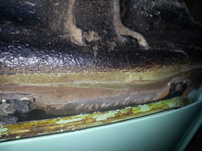

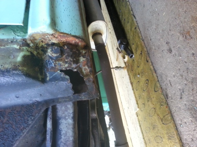

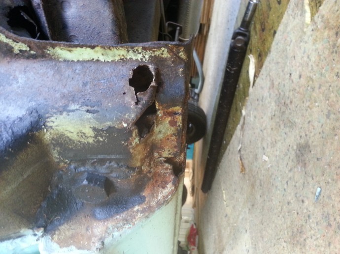

at last iv'e fond some rust .well thats not too bad .
found the gremlin
found the gremlin
