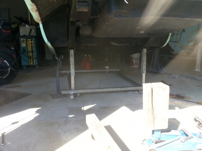

well removed all drivetrain and lifted car up higher onto a dolly trolly to wire wheel under carriage
should be higher enough  hmm maybe 4x4 wagon.

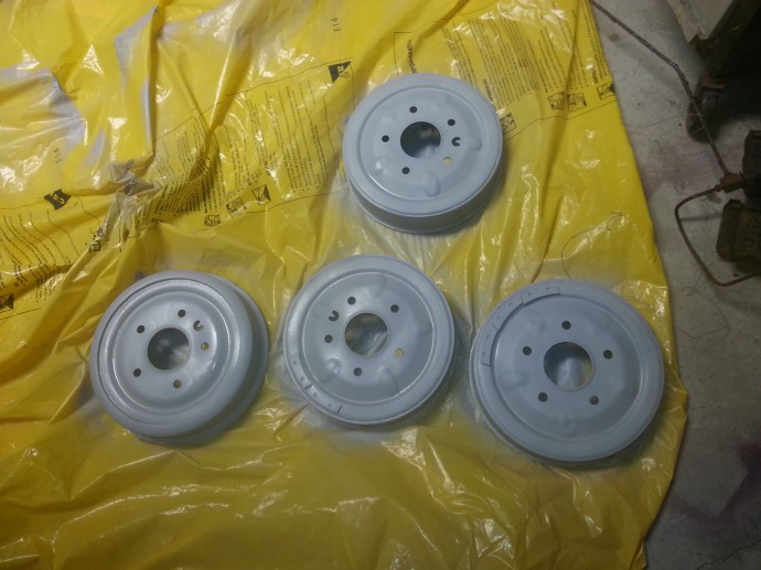

have noticed i have 1 different brake drum any idea ?<br />i made a rookie mistake and didn't mark them know not sure which is which regarding weights is the horse shoe shape cut outs for rear ?

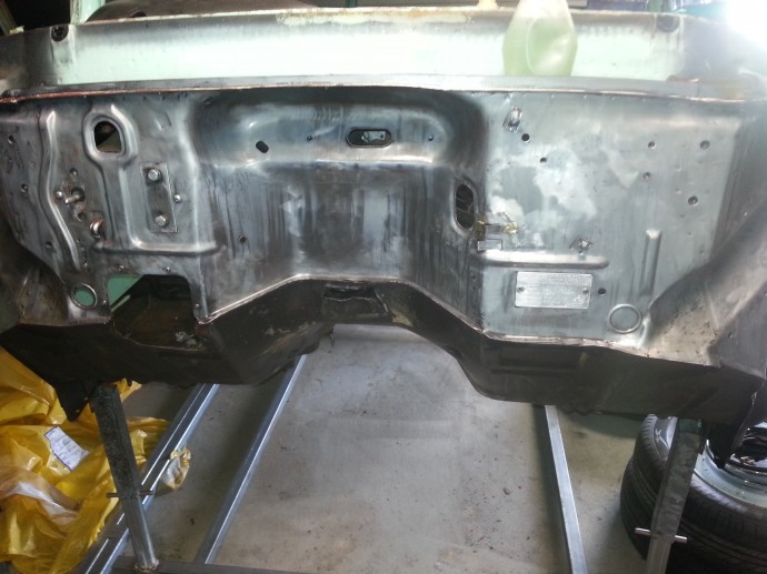

finished repair to radiator support and primed.

Fishy that drum is a later flat faced drum and you shouldn't use them with the standard rims. The standard drum is dished so it will mate up to the standard rim correctly. If you try and bolt a standard wheel rim up to a later drum you will distort the rim at its mounting face.

Bugger will check rims to see if any distortion yet cause I don't know how many years its been on there for.
what about the weights are these to balance the drum them self or ment to be on a particular side of the car . I am sure they are just to balance the drums but just need clarification.
cheers
Paul
Posts: 14271
Re: Wagon rebuild
Pretty sure they are just to balance the brake drum , cant imagine they would balance the axle or front hub with the drum ......

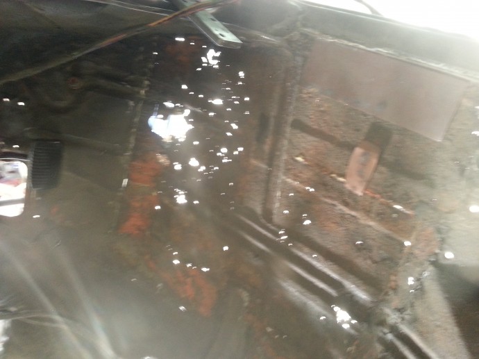

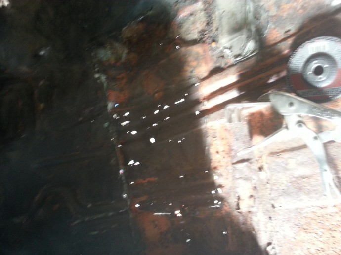

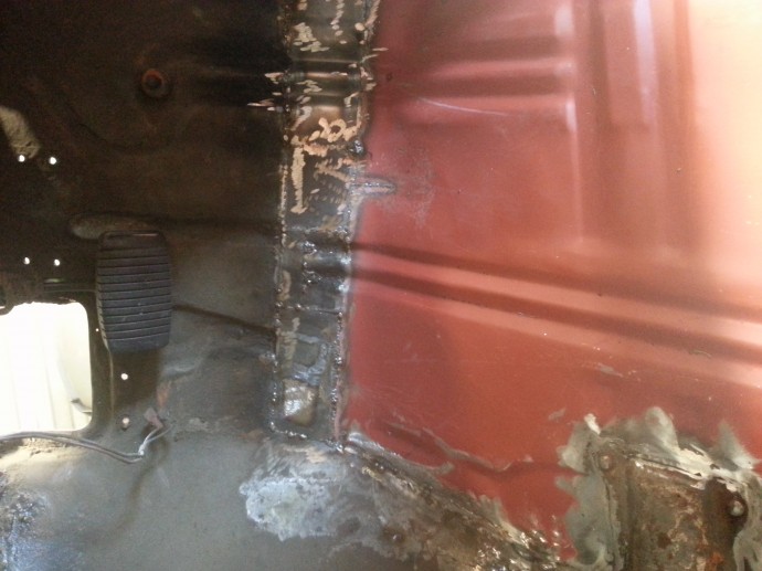

Time for an update i think, well finished underbody back to bare metal and found some nasty sections which had been packed with bog and more bog wouldn't have known until ripping the wire wheel over the sections front floors from inside had new floor sections welded in but the old floor were never taken out talk about a shit job . so bought some replacements from Taylors but unfortunately they were all too small so had to make up sections for the front and rear of the new sections took a bloody long time to fab but am happy to say all done now just need to run a bit of filler over welds

floor sections removed
driver's side
driver's side
passenger side
passenger side
sections added to front and rear

X2 - I do like to see permanent work..... you won't ever see this floor again once you cover it.
I was told to use a "welder's etch" where the new steel is fused into the original - it has zinc in it and its main purpose is to prevent electrolysis... brought about by the different metal.
Of course, this would be accelerated if any salt were to come in contact with it - which is unlikely, but if you want to ensure that the new steel doesn't begin to attack the old - just behind the heated original steel... a light coat of this special coating will electrically join the two and prevent any possible anode/cathode electrolysis... you probably know all this.
I did this to mine when I welded in the trans hump - then over-coated the entire area in primers then multiple top coats of epoxy enamel.
I did this both above and below the floor line.

yeah Rosco inside and out will be zinc primed then 2 pac primed before paint .
