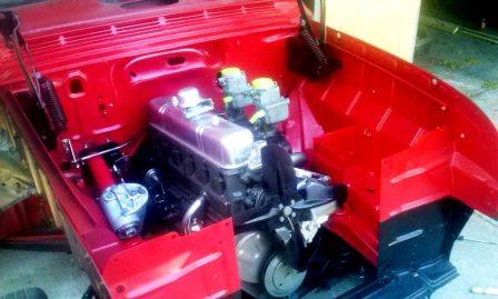

Got the 132 powerhouse in without too much grief, except for the accelerator arm catching on the corner of the manifold preventing the right side stud fitting into the support bracket, will require some sort of mod :think:
Didn't have chains, so I slung it with ex RAAF cargo straps rated at 500lbs.......that I "borrowed" :wink:
So here are some pics of todays effort even got the missus to help :thumbsup:
Cheers n Beers

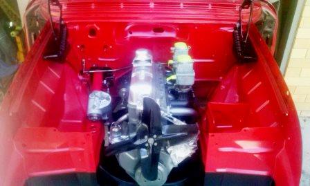

The mod that is required!

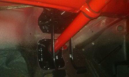

Found the pic of the pedal box and steering column installation after refurb and painting.
Got to get that bloody big spring though :eh:

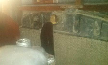

The EJ model is in good nick but as I found out the fan protrudes above the radiator, :thumbsdown: So I temp fitted the FE-EK radiator and noticed the fan will cut through top hose when it is fitted :roll:
Apologies for the long thread, but need to paint the picture. Is there a smaller fan I require or has it go something to do with the engine mounts / mounting?
Feedback is appreciated. :thumbsup:
FE-EK RADIATOR (Notice fan position)
EJ RADIATOR
EJ RADIATOR

its the wrong fan for a grey. The blades should be about the top of the thermostat housing

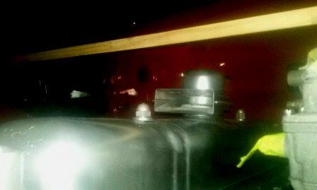

Take the air cleaner off, put the spirit level or a flat bit of wood across the bonnet drain channels (the U-shaped bits on the guards that you store your spanners and loose bolts in when working on the car). Measuring down to the top of the rocker cover breather I get 50mm.

Using piece of 10mmx10mm pine as mt straight edge, I get about 35mm from bonnet channel to top of breather and approx 55mm from bonnet channel to the top of the front rocker cover, and approx 10mm from bonnet channel to tip of fan!
My fan is approx 200mm from centre to tip

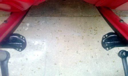

I have an FJ serial numbered grey using fb/ek rear engine mounts and FX/FJ front mount to accommodate the timing cover and out rigger, as per my forum pics.
The front of the support member has provisions to mount both radiators I have, the EJ and FB / EK.

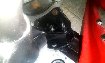

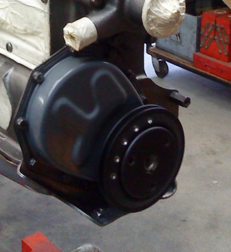

That front mount plate looks to be wrong or modified. The height from the mount to the balancer looks a lot larger than normal.
Usually the bottom edge of the balancer is just near or below the lowest edge of the mounting plate (depends on which balancer). That one looks like its been changed. From memory the outriggers on a FX/FJ were vastly different to FE onwards.
I think your engine is tilted back too far because of the mount plate. Could be why your manifold is hitting too.

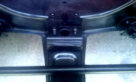

It has been modified (not my doing) here is a pic. Amounting plate has been made and welded to the fron of the original mounting position?
:roll:

I think your on the right track :thumbsup: I do have a plate from my other bits n pieces (they all came with the project) I've got the removal tool but I had to hit the balancer on, I did not feel comfortable with this, but read that this can be normal? Anyway..... looks like the plate change has to be done.

This looks like the plate that needs to go on, Fu@# knows what was going on with the plate that came with the engine. Well another challenge and venture where I haven't been before. Tips are welcome :D
