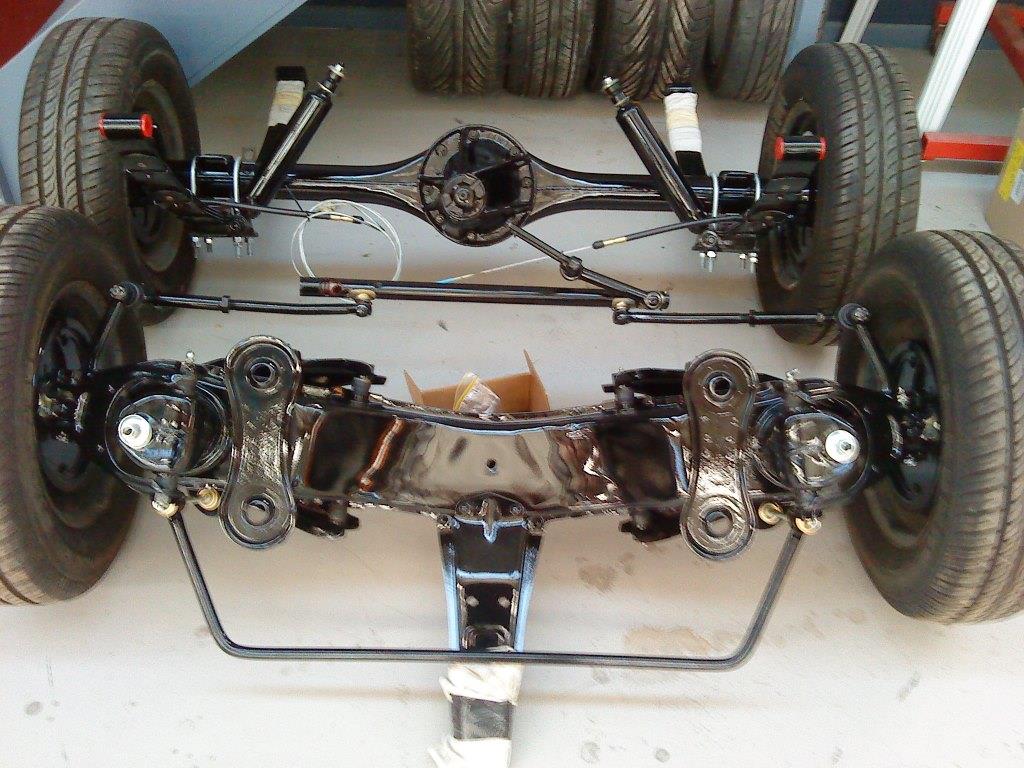

Front and rear ends ready to fit.

Thanks Tim,
I thought about the change in ride harshness but am prepared to put up with that as opposed to having to change the rubbers when they become displaced and cracked, especially the rear shackle rubbers.
The red nolathane bushes are going to be replaced with Whiteline synthetic elastomer bushes which are quite flexible, I just didn't get around to swapping them over before taking the picture.

Got them from Whiteline. Ordered them direct off the Internet thru their website. Be careful as the front shackle bush is listed as a different type and does not fit FB EK. They have confused them with HD HR and they don't fit. You'll have to order 2 rear shackle kits to ensure you'll have enough for both ends.

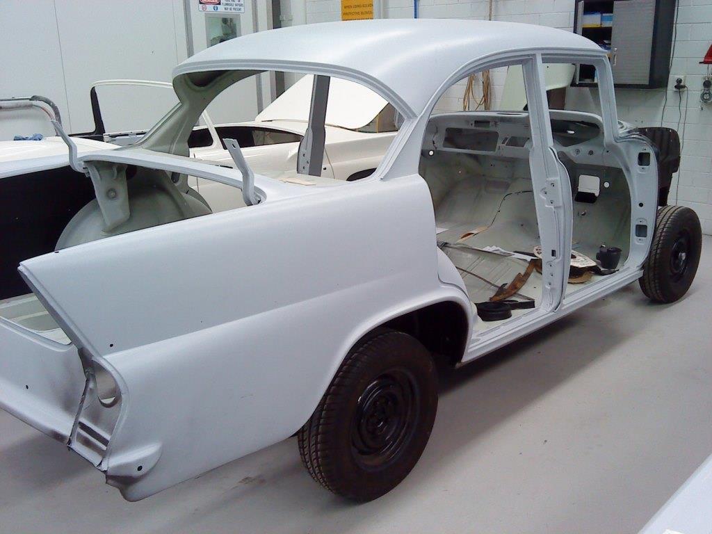

Well its been nearly 8 months and she's back on her wheels!!!!.............finally :clap:
Posts: 14274
Looking good mate :thumbsup:
