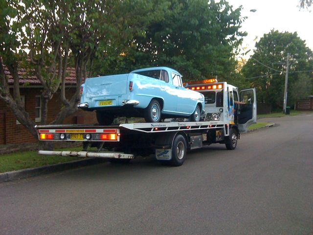

G'day all.
WOW???? the saga continues!
Ok just to recap!
replaced:
• Water pump
• new thermostat
• radiator recored
• professional engine flush
• radiator filter
so after all that it was still running on 195 - 200
so I shipped her off to the Mechanic (courtesy of NRMA Roadside membership - pays for it self in triples) Mechanic noticed:
• timing was out. fix
• Did a infared reading- said temp gauge was out by a little, so new gauge installed
• the exhaust had a little leak after the manifold ( this is interesting. said that the hot air coming from the exhaust was also contributing to the increase in temp)
• So full new exhaust system ( it need 1 badly any way)
So finger crossed after all that ??? exhaust system is being installed tomorrow then the mechanic is going to check a few other thing & we'll c what happens...
jezzzz???? who would of thought... such a complicated thing???
over n out.
