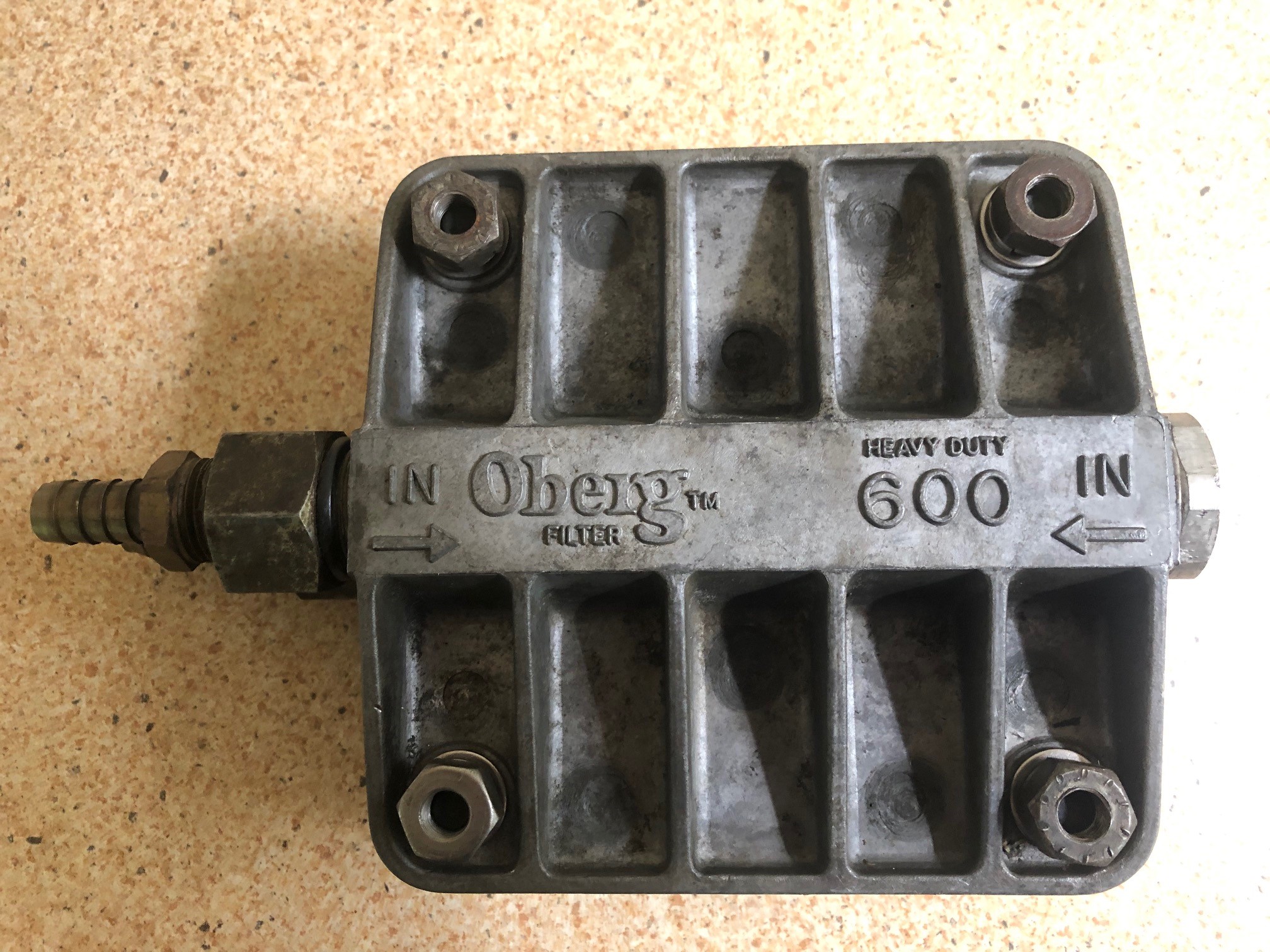

I have now completed the remote oil filter setup done.
Filter now near to auto trans with straight lines and space to do a filter change. My first choice of location would have required the oil lines to bend 90 degrees. I did chase up a couple of formed rubber lines but at $30 a piece too dear for me.

Looks very tidy Roger. Prolly easier to change now than the original position.

Nice looking job that one, where did you buy the remote filter housing?
Is it 1/4 NPT fittings?

The remote filter kit is from Outlaw Speed shop in Rosewater.
The fittings are 1/2" NPT
Very happy with bracket I made, sits neatly and is bolt in.

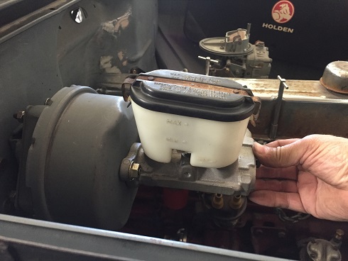

I have made a change to reservoir as the master cylinder I purchased to fit to the Gemini booster leans too far back.
Ok when used in the car it was designed for XA-XB so I spent sometime at the local U Pull IT wreckers and found the VT Comodore has the same spacing for the front and rear circuits.
A little trim here and there and it sit good. Just need to sort out how to hold it down as the tab with screw does not align. Also need a bracket at the front to support it. Cheers,
Re: Ammo's Ute
I seem to recall there is a reservoir that will fit straight on and fix that issue Roger, just can't remember what its off ....
