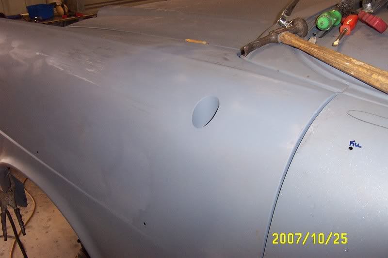

Anyway while I was working on the front guard repair I thought
I'd throw in a recess for the electric aerial. :idea: Just for a bit
of custom work.
Didn't want the car to look to plain. :wink:
Malcolm W.
Posts: 13569
Just throw a hole in the guard eh Malcolm ?
Did you borrow one of Harkos holes ??? :lol:

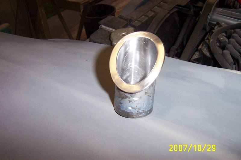

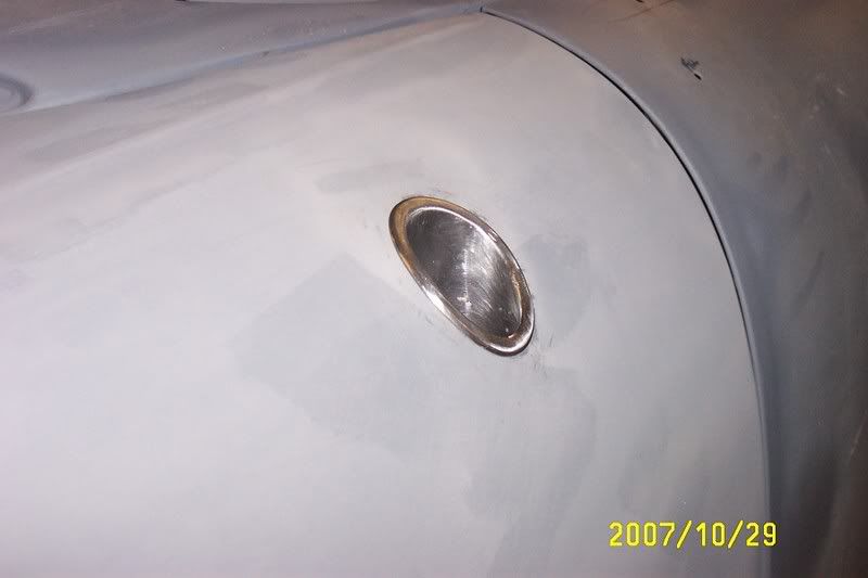

Just thought I'd add a bit of bling to the aerial hole.
I did this in an old FJ I had years ago and it looked pretty trick,
so I thought I'd try it again.
The trim is made out of exhaust tube that fits inside the tube
used for the aerial insert. Fitted into the hole and marked
around to give the curve, then cut to shape and a flat plate
welded to the top. Then trimmed out to suit. Finished product
looks good and fits perfect. Just has to be sent away to get
chromed now.
Malcolm W.
Wow, great touch.
