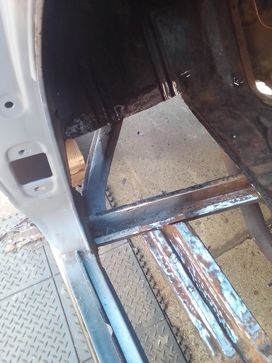

Re: Gimme 5 years
Posted: Sat Oct 03, 2020 5:17 pm
by 62ekute
inner and outer sills are in and getting ready for the floor - but I overshot beer o'clock - not even time to clean up

Re: Gimme 5 years
Posted: Sat Oct 03, 2020 5:24 pm
by BILLY BLACKARROW
[quote=62ekute post_id=247670 time=1601709472 user_id=10199]
Cant be doing that 6 demerits :grinnn: :grinnn:
Re: Gimme 5 years
Posted: Sat Oct 03, 2020 6:19 pm
by Brett027
Job looks very neat. New bits are fun😄
Re: Gimme 5 years
Posted: Sat Oct 03, 2020 9:29 pm
Good to see you’re back into it Patrick. Nice work, very tidy as Brett says and all done in the driveway?!
Clay
Re: Gimme 5 years
Posted: Sat Oct 03, 2020 9:53 pm
by 62ekute
thanks fellas ... yep, it was 25 degrees today - no more weather excuses (for now). I reckon I'll knock over the grinding and welding before it gets too hot ... and yeah, still in the driveway (with some rubber mats for the old knees). I'm keen to start putting things back together - inspired by other people's projects coming together ... but it would be more sensible to do some spannering before the guards go on - we'll see

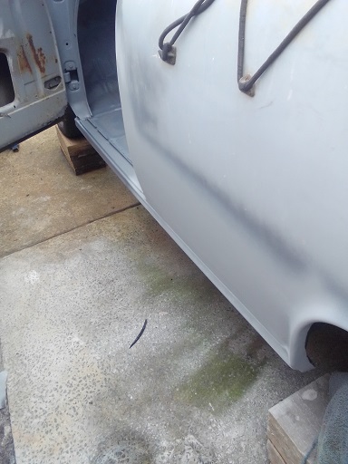

Re: Gimme 5 years
Posted: Tue Oct 13, 2020 4:31 pm
by 62ekute
thought I'd tidy it up so I could move onto something else - final shaping can come later
passenger side 15.jpg (67.89 KiB) Viewed 638 times

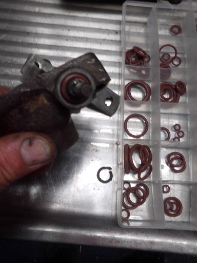

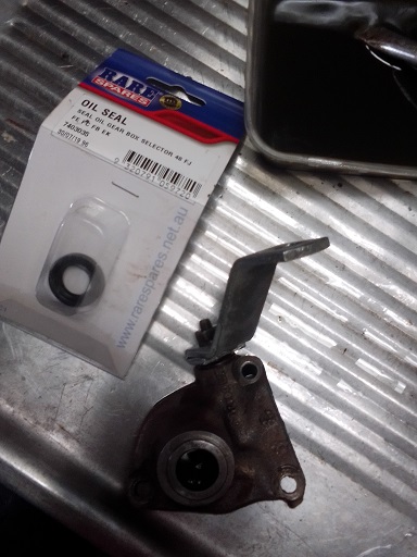

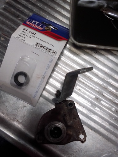

ahhh, something different...I dropped the oil out of the gearbox - it was cleaner than I expected, though the previous owner had been collecting bits and pieces, so probably also changed the fluids.
The gearbox had been dripping oil while sitting in the driveway so I put a new seal on the selector shaft
gbox seal 1.jpg (73.83 KiB) Viewed 610 times
and a viton o-ring here
gbox seal 2.jpg (66.26 KiB) Viewed 610 times

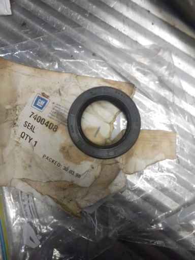

and took the driveshaft off and put in one of these (this was one of the spare parts that came with the car)
gbox seal 3.jpg (71.48 KiB) Viewed 610 times
Re: Gimme 5 years
Posted: Wed Oct 14, 2020 3:10 pm
The vertical shaft was leaking on mine. I put an o ring in but still leaking. I have to cut a washer from some old leather satchel.
Re: Gimme 5 years
Posted: Wed Oct 14, 2020 5:36 pm
by 62ekute
Hi Clay, yeah the o-ring I put in is pretty chunky so hopefully it will seal - I've got a whole box of various sizes to try out if it does leak (or yeah, try
something else). btw the o-ring is 'viton' which can handle oil. Patrick
