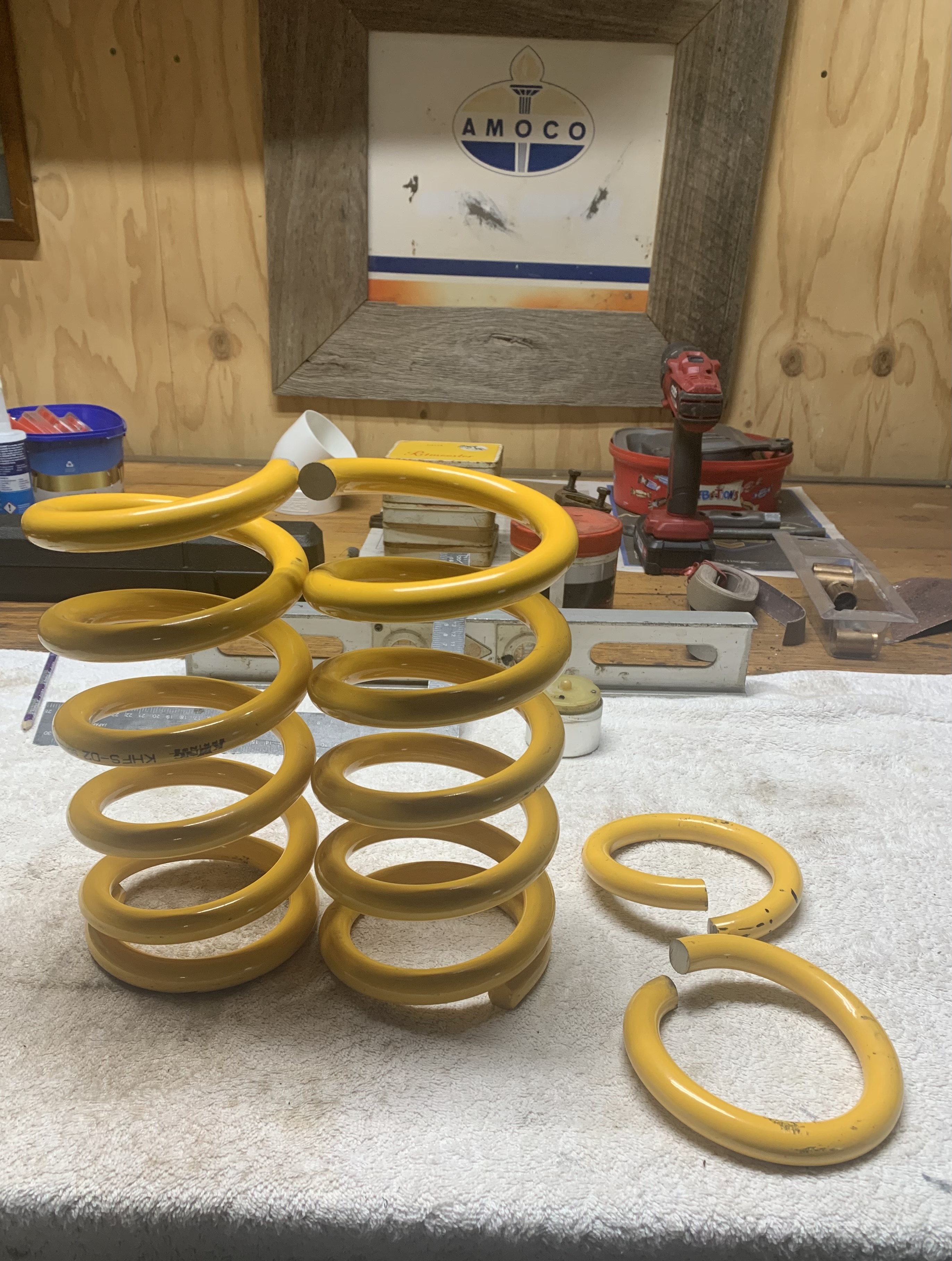

Been in contact with spring manufacturer and I will have a go at cutting down the springs. They advise it is a ratio of 2:1, so a 20mm cut is expected to lower car 40mm.
Now have springs out and will start with a small cut ensuring I don’t overheat steel and reinstall, fit wheel and check measure. If need be repeat.
I think I need to lower it 50 - 60mm, but see how it goes.

If you cut them with a 1mm cutting disc you wont affect the temper of the steel

Blacky wrote: Thu Aug 21, 2025 8:51 pm If you cut them with a 1mm cutting disc you wont affect the temper of the steel
Thanks Blacky, good advice. I did see on a YouTube video suggesting springs could also be cut with a hacksaw……. But that sounds like work :roll:

Cut 25mm off springs and reinstalled. I think the car needs to come down another 15-20mm and that should do it.
Springs trimmed 25mm
The car has been lowered approx 45mm after the first cut.

Took another 10mm off spring length. That is the limit as the spring only required a small amount of compression with jack to fit lower control arm bolt.
Will do a road test tomorrow.

Good result - it may settle a little over the next few days mate - maybe adopt a wait and see attitude ?
Posted: Sat Aug 23, 2025 8:53 pm
Looks great Stephen. I wonder if they are a heavier gauge spring, or are they original spec?

King springs say they are a direct replacement but you can see by the Stephens photo on page 13 that they are heavier gauge.

The King Springs I fitted were standard height plus 20mm lift as I wanted to solve front tyre scrub. The wire dia is 3/32” bigger than what was in there originally. Probably should have gone for standard springs and saved myself all this fiddling :roll:
After the two spring cuts here it is. I’m happy with how it stands and I have increased the tyre / guard clearance. With new stiffer springs I am hoping to have solved the tyre scrubbing. I won’t know until I get on some undulating roads at 80 km/hr.
