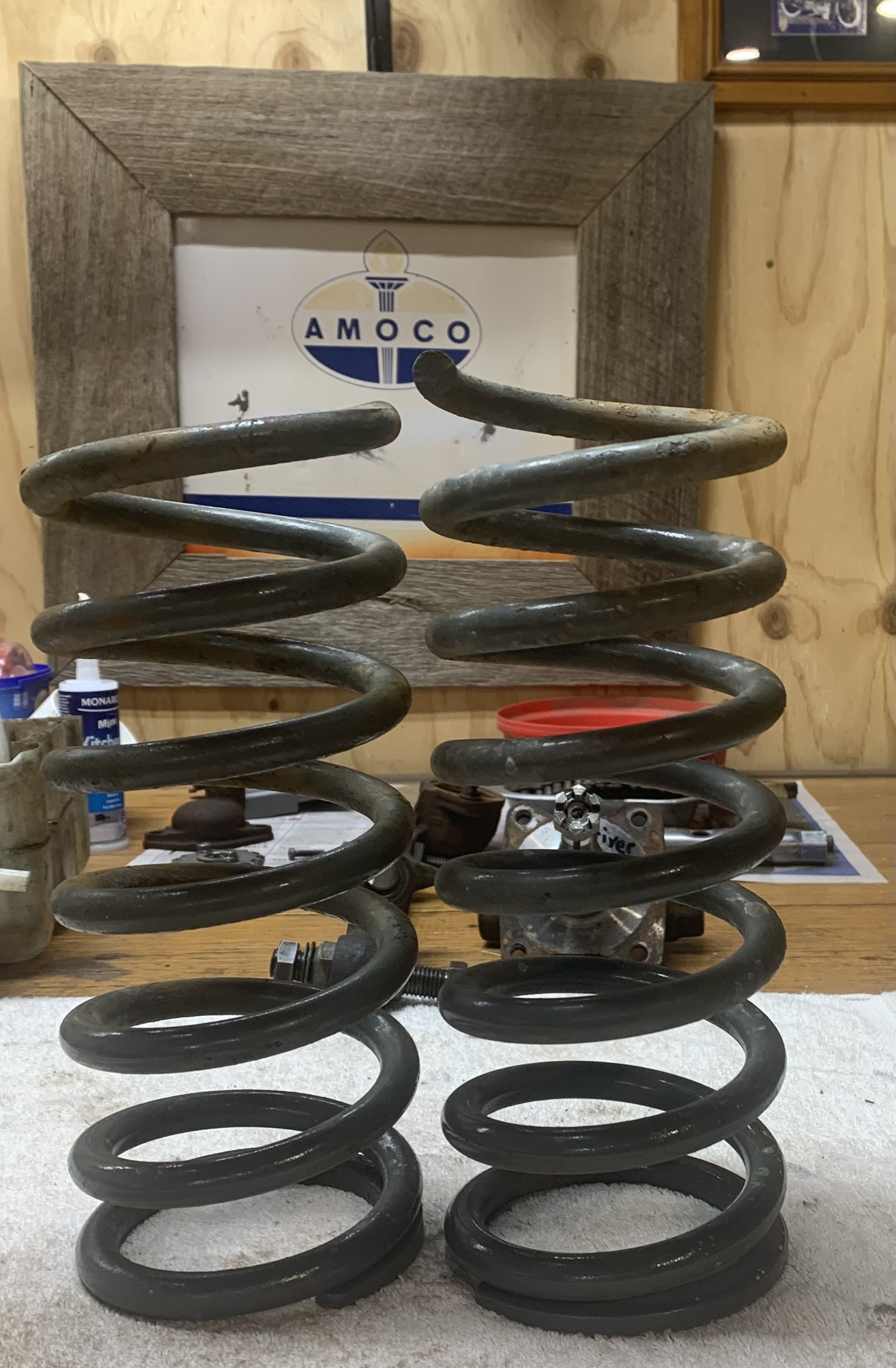

I ordered a pair of King Springs. Before removing the old I checked tyre pressures and measured the car height at each corner to the floor. I also measured from the wheel hub to underside of the guard as per info from King Springs. A pic of the one spring removed alongside the new.
The old spring has a free length of 11 9/16”. The manual says free length should be 12.5” (sedan) or 12” (van, station sedan & Ute). The part no on the old spring is 7412466. Can anyone advise with a parts manual what the old spring is from?
The wire dia of the old spring is 9/16” whilst the new spring is 21/32”.

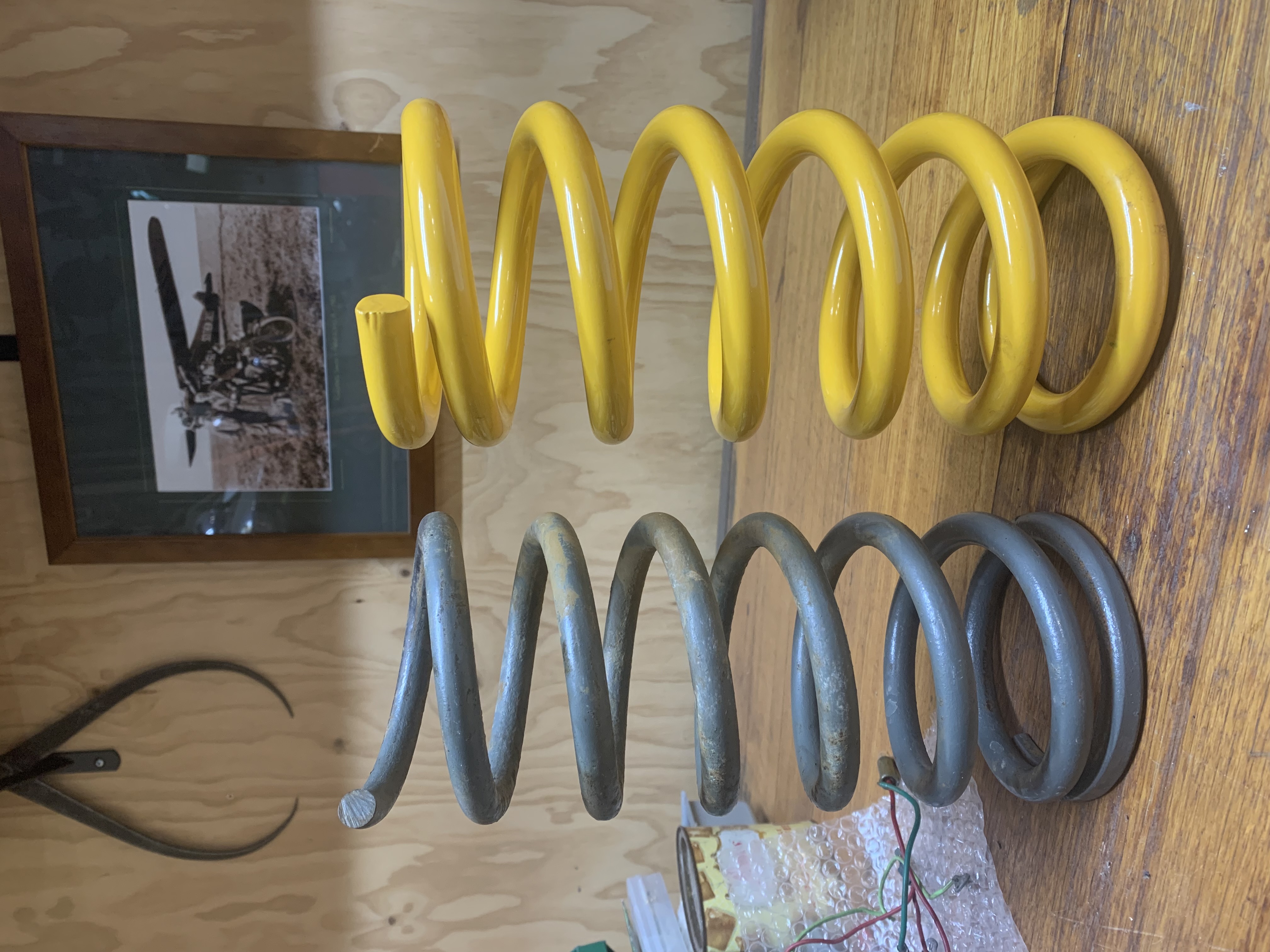

Pulled the spring from the passenger side that has a different part no from the above. The passenger spring is part no 7419137, which according to Clay’s info is a sedan spring. See picture of the spring comparison of the mismatched pair.
This probably accounts for the different tyre to guard clearance I had as per earlier post.

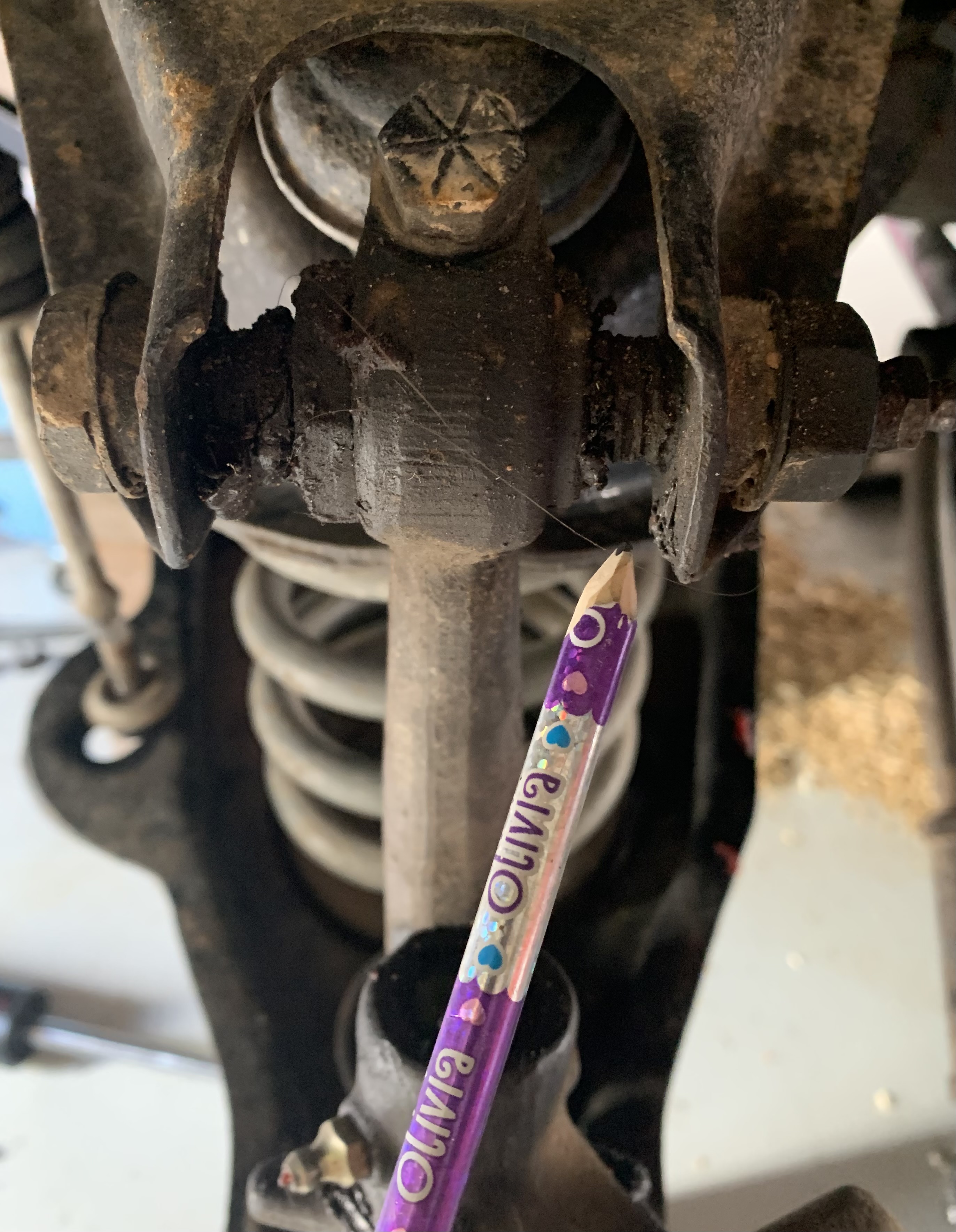

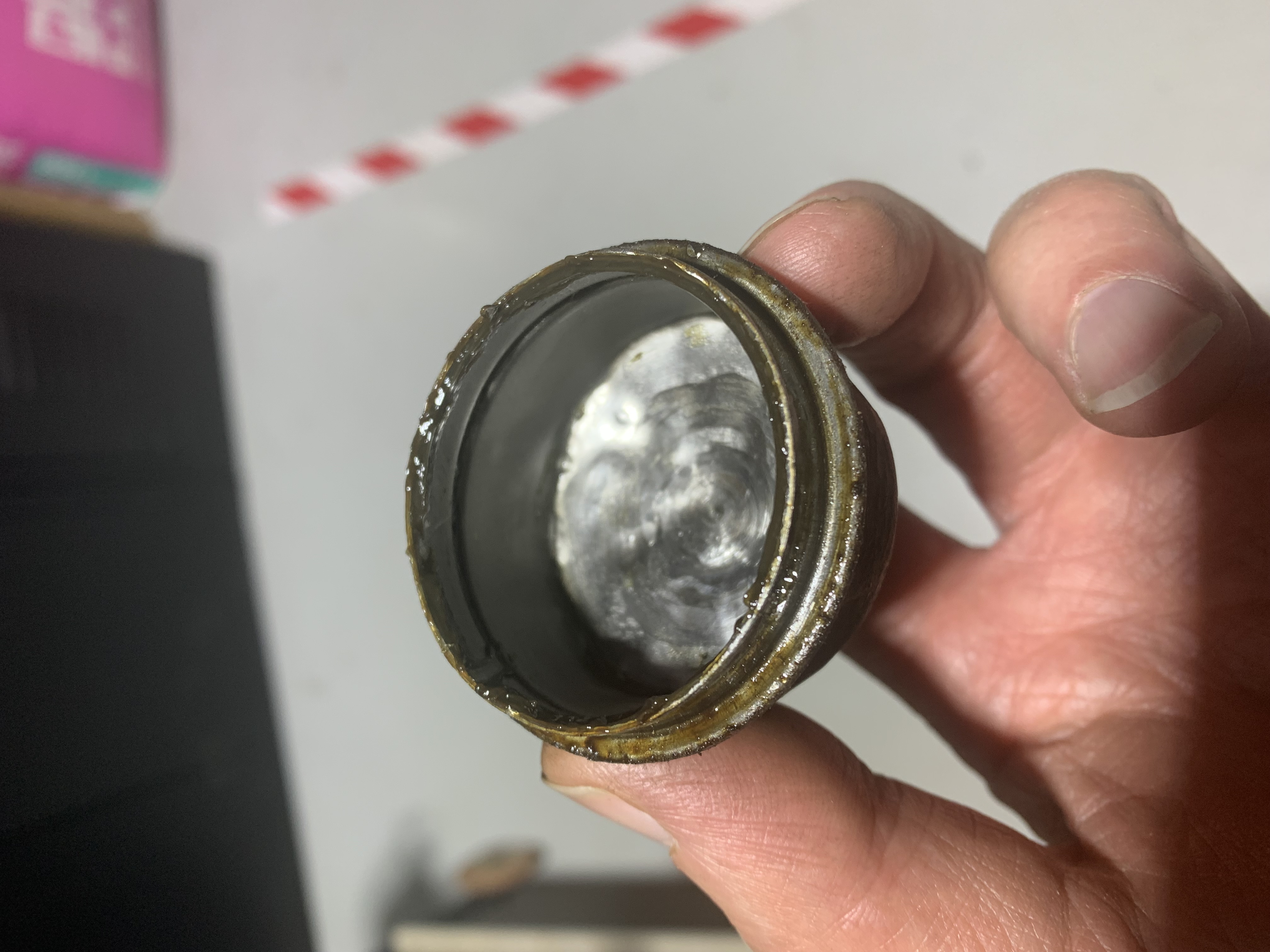

A couple other odd things I noticed was some washers missing, rubber grease seals and a shortage of grease in the wheel bearing cap. See picture of the cap prior to cleaning. Grease must have been in short supply!!

by In the Shed
Absence of the rubber grease seals where pencil is pointed.
Posted: Sat May 31, 2025 12:22 am
Yes, my ute had mismatched springs, both foriegn to the car, also.
You can use old heater hose, or go to car parts plus, for those seals.
