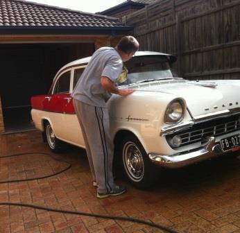

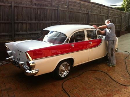

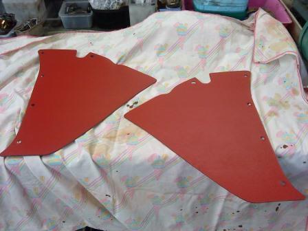

Todays little update.
Got some colour matched paint to do the kickboards. Pretty happy with the results.
Todays milestone was giving the car its first wash. The car has turned out pretty well water tight with only a couple od spots letting a few drops in. Just need to sneak up the door strikers a bit.
