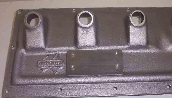

Ended up trying some breather mesh in the alloy side plate and annoyingly it is a dismal failure. Looks like the side plate will have to come off for a bit of rework. In comparison to the old tin one it looks like the baffle plate not being sealed against its top edge is allowing splashed oil to run down the inside of it then directly to the breather tube hole. Also the baffle plate is nowhere near the length of the old tin one.

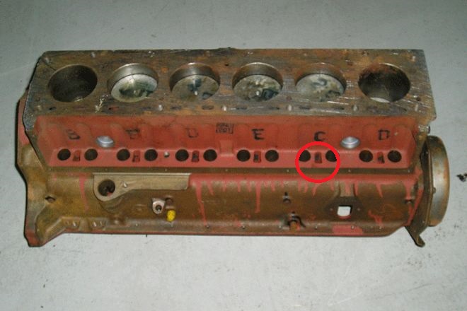

I have spoken to Aussie speed about the side plate and they of course never have heard of this problem before (oil out of the breather). My fix is to make up a longer baffle plate the mimics the original one and have it tig welded in place. I think most of the oil is coming from the return oil gallery just below the breather plate. The camshaft sits below it and it has oil thrown on it from the conrod squirter hole. I think there's a fair bit of oil being thrown around in that area for cam and lifter lube which is collecting in the area above via the return gallery port. Also the spigot that the breather pipe goes into has an internal lip which is acting as a catch area. It needs to have a drain groove in it to allow any oil to drain out.
After that there's still the door trims and stainless to polish and fit, realign doors and adjust strikers, and redo the boot seal and its a goer for the wedding. Once the wedding is done its prep time for the Nationals! There's still a few accessories to be refitted such as tow bar, vacuum windscreen washer unit, gear lever lock, and whatever else I haven't done. So far the build time has been 15 months and its been flat out in all that time. Hoping to kick back a bit soon and enjoy it all.
original baffle. Note the length of the plate and oil drain holes at lower edge. Top edge of baffle is closely fitted to side plate wall.
Offending lip that needs a drain

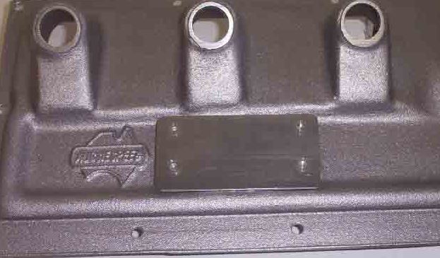

Offending breather baffle now fixed. Another good test run and no oil dripping from the breather pipe.
Its funny how these after market mobs think that their shortcut cheaper versions are as good as what the manufacturer had already spent thousands on developing. Pays to be cautious with this stuff. Reminds me of all those alloy rocker covers for red/blue/black sixes out there with no baffle plate for the PCV valve. I couldn't count how many people I know that have complained about high oil consumption, blowing smoke, then ultimately pinging and running on and the resultant damage from that.

Shitty little breather plate removed and casting cleaned up.
New plate made and tig welded in place. Pretty well mimics the original.
