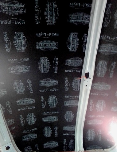

Re: Gimme 5 years
Posted: Wed May 27, 2020 3:09 pm
by 62ekute
I stuck the insulation on the roof - plenty of time now before the headlining goes in - to make sure it doesn't sag. It's really sticky and lightweight so should be good. It took one sheet of 1200 x 900 x 6mm.
One front piece of 1200 x 520mm (with some tabs to go under the centre brace where they would fit)
...and one rear piece of 1200x 320mm (curved to 270mm) and then some off-cuts on the ends because the roof is a bit more than 1200mm.
I started at the centre-line (and got the tabs under the centre brace) and then worked towards the doors - I doubt you could re-position this particular product even if you tried immediately.
Cutting it into lots of small pieces would have been easier.
Patrick

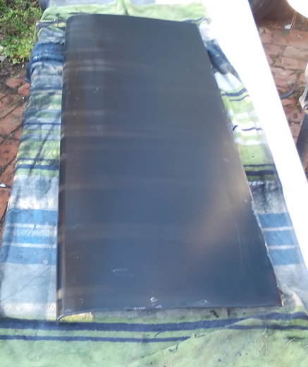

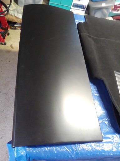

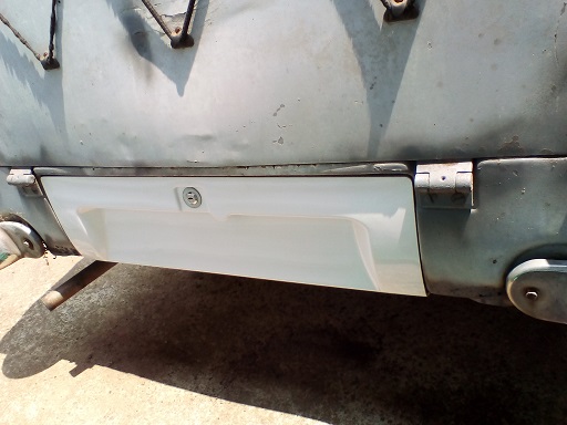

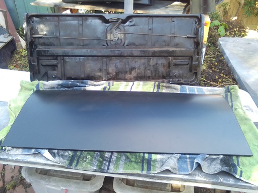

tailgate skin arrived - - - and the sun came out this afternoon so I tinkered
tailgate 1.jpg (60.57 KiB) Viewed 640 times
The tailgate was pretty beat up and had some previous putty patches cracking up
tailgate 2.jpg (118.57 KiB) Viewed 640 times
I took the old skin off and tidied the rest up a bit - nothing fancy, just tapped it into a 'better' shape
tailgate 3.jpg (84.51 KiB) Viewed 640 times
Got finished at beer o'clock - paint can wait for another day
tailgate 4.jpg (70.54 KiB) Viewed 640 times
