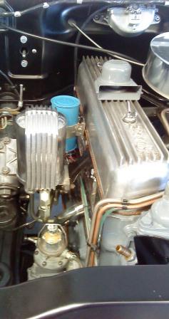

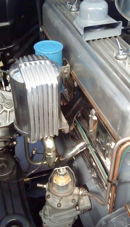

Really hate to be picky but the Z9 filter is used a lot by F**D.
Graham
Great job on the car
Posted: Mon Sep 02, 2013 6:15 pm
by Craig Allardyce
Thanks Graham,
I'm really surprised it took this long till someone would say that! I had no real options as the Z9 was the only filter available with an anti drain back valve and an anti syphoning valve (vertical mount), plus the thread size had to match the filter housing. GPM, micron and beta efficiency ratings were another issue with the full flow conversion.
Anyway I was a bit over with the potential free advertising for Ryco and the fact that the filter sticks out look a sore thumb so I ordered a billet cover for it. Looks better I think and matches the rocker cover. Think I'll have to polish the rocker cover a bit more though.

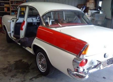

Whitewalls on today...woohoo!
Kitted out master cylinders and ready to bleed brake and clutch. Purple brake fluid????????? Looks a bit gay but it should brown off (Silicon fluid). All mechanical finished underneath bar oils in box and diff.
Still waiting for my outer door seals......getting annoyed with this part as I need to fit them before the doors go on.
Temporary trim should be ready to fit Friday week. Not much more left but a lot of fiddly shit to tidy up and finish.

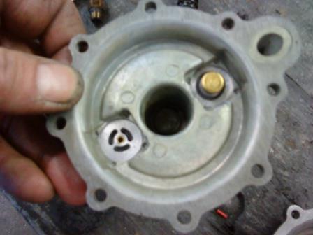

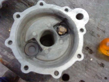

Its been a big week as I've finally got the car driveable. I had a few dramas with the brakes due to leaks from the silicon fluid but all sorted now. Clutch was a real bastard to bleed as the master cylinder piston would not return after full travel when bleeding down the slave cylinder. After much stuffing around it was vacuum holding it down so I had to be patient with the piston returning after each stroke. All the interior is finished now but I'm still waiting on outer door seals. Betta Auto rubbers sent me a mix of outer seals with two different types of profile on the lower section that runs across the scuff plate. I discovered this after fitting the first one. After some calls with them it seems that they cannot supply the lower section as per the original profile and are searching for another rubber supplier. The only one they can supply is a new type with a "K" profile. In their words its a double lip. In my words its useless as it doesn't have a flat section on the inside face of the lower profile and cant be glued to the scuff plate properly. Well that was some months ago now so you can guess how happy I am with that! Now I'm looking for a refund and the possibility of going for Rare Spares Seals and we all know what they're like.
Another problem cropped up too. No vacuum wipers. My new Trico Motor is stuffed straight out of the box. Looks like the vacuum flap seal is passing. Probably dried up from age. I also found the vacuum pump kit I bought has the wrong valves. The spring tension on the valves is too tight to allow the pump to draw enough vacuum. I ended up pulling it down and removing the new valves and found some old ones that weren't leaking down and fitted them. Wipers are good now with 12" Hg at the motor with only the pump supplying vacuum (manifold disconnected). I've temporarily fitted an old motor that worked ok so I'll get to sorting the "new" one out later.
If you bought a kit with these valves in them don't use them in the vacuum pump!
Leave the old ones in if they don't leak back, or source new ones of these type.
