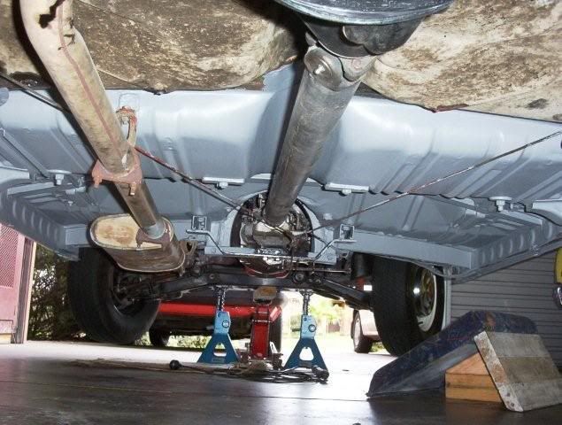

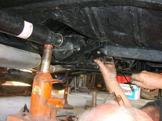

Here's mine prior to final cleanup... Still nowhere near as clean as Rosco's :oops: :oops:
Pics aren't the clearest but the cars a little on the low side :twisted: :lol:

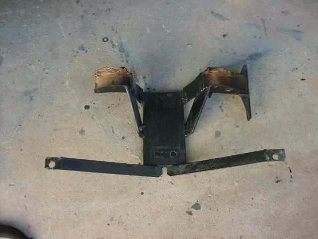

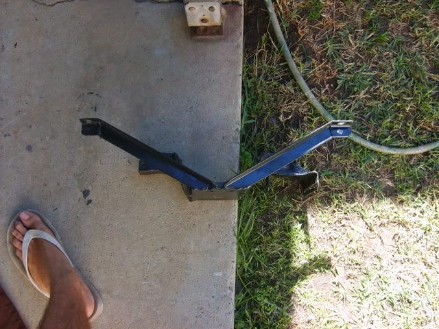

Hi
Here are a couple of pics of the rear gearbox mount
we made up to fit the 2 speed powerglide im also
having trouble with the drag link (ek) hitting the sump
on full lock.
i have moved the steering i think they call them
bump stop's out and it sovled the problem but it doesnt have
as big of a turning circle as it used to i may have to put a crs
tunnel in so i can lift up the engine a bit more .I modified the
original tunnel but not enough if i lift the motor any higher it
will start hitting :x
