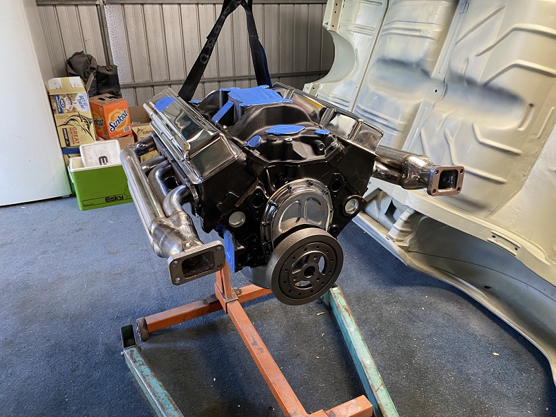

Purchased the Twin turbo kit back in 2010 when we were dollar for dollar with the US for the sedan project but Ammo's ute got in the way.
During the visit from the engineer, we agreed that there is not enough room in the engine bay so I may need to mount these towards the back of the car.
This will mean more pipe work but I think it is doable. There is room under the rear set area that I could use.

NSW can be no better, depending on the engineer. 341.5ci for a NA V8 was all I could calculate my way into. The 40-thou over 327 in the wagon goes 333ci. It was proposed that I would have to remove heads and prove capacity, until the engine builder (a bloke the engineer trusted) sent the build sheet.Blacky wrote: Sat Jun 17, 2023 11:38 am SA regs are definitely way easier to work to than WA - the rattler with a supercharged 202 is JUST under the limit over here, and if you go V8 naturally aspirated the limit - depending on who you talk to - is 327![]()
Interestingly, I was offered any capacity I wanted provided I passed a beam test. Visions of Merlins danced in my head until I was quoted $4k for the beam test, and couldn’t find anyone at the time who had passed on in an EK. I chickened out.
I dream of twin hairdryers. Might need antilag if they are mounted that far back, though it sounds horrible when used.
