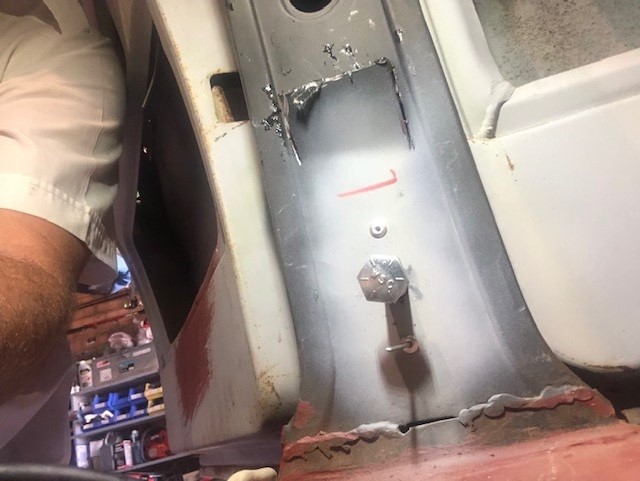

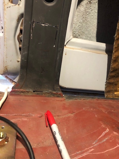

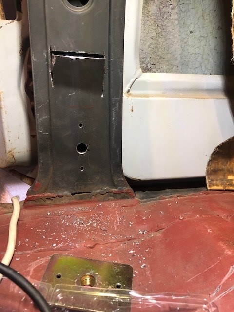

Finally found some time to take a good swing at a couple of things. think ive got the front end all sorted with new sway bar setup in, and all of the seatbelt attach points now mounted (with thanks again to Harv). Just gotta learn how to weld, then it will be into the mockup, engine ready to go in.

Well , they are in there :thumbsup: if you cant weld you gotta know how to grind :lol: :lol:

Looks like a result Craig
