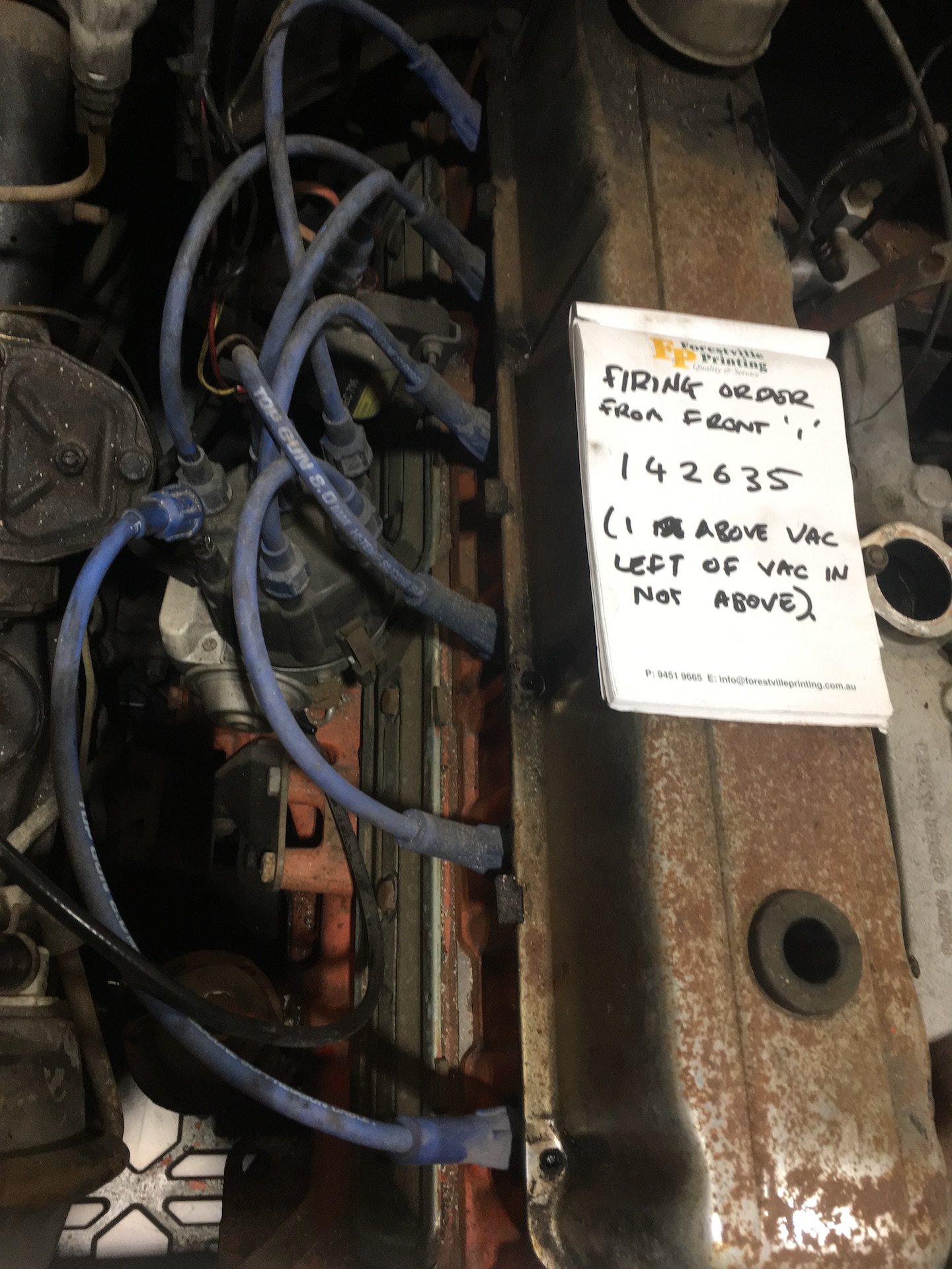

So first things first. Take notes. Don’t remember what I was on about with the vacuum stuff but the firing order is right. I think!
Electronic distributor luring in there, Stromberg carb removed.

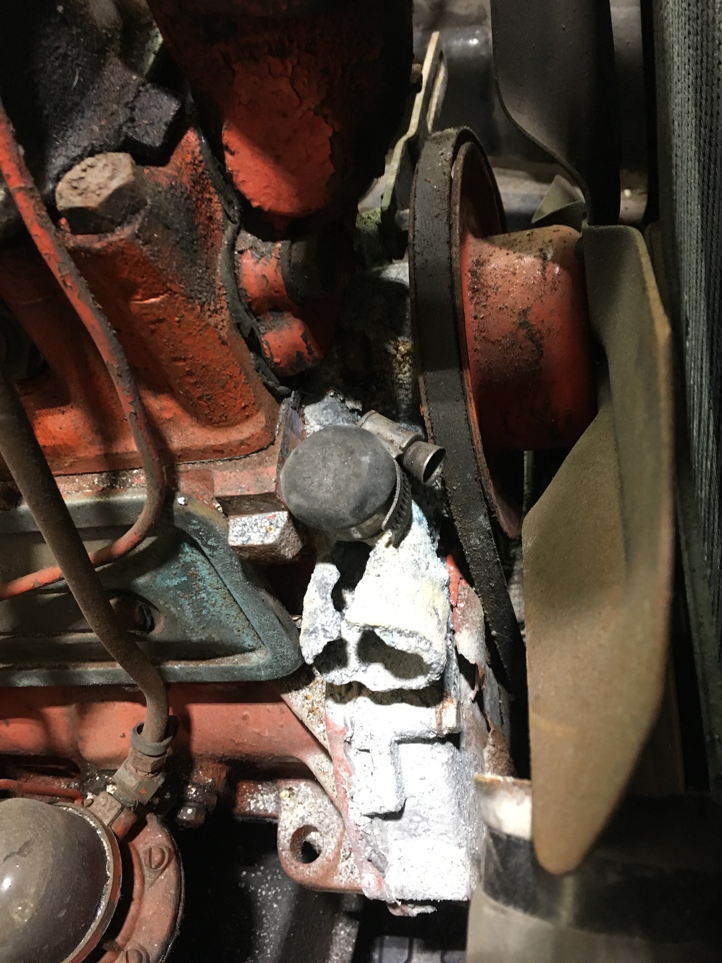

Bonnet off. Rocker cover too. Water pump was in flakey pieces. Should have drained it. Easy to get a new one. Engine only had about 10000K's on it after a reco so that was pretty lazy on my part

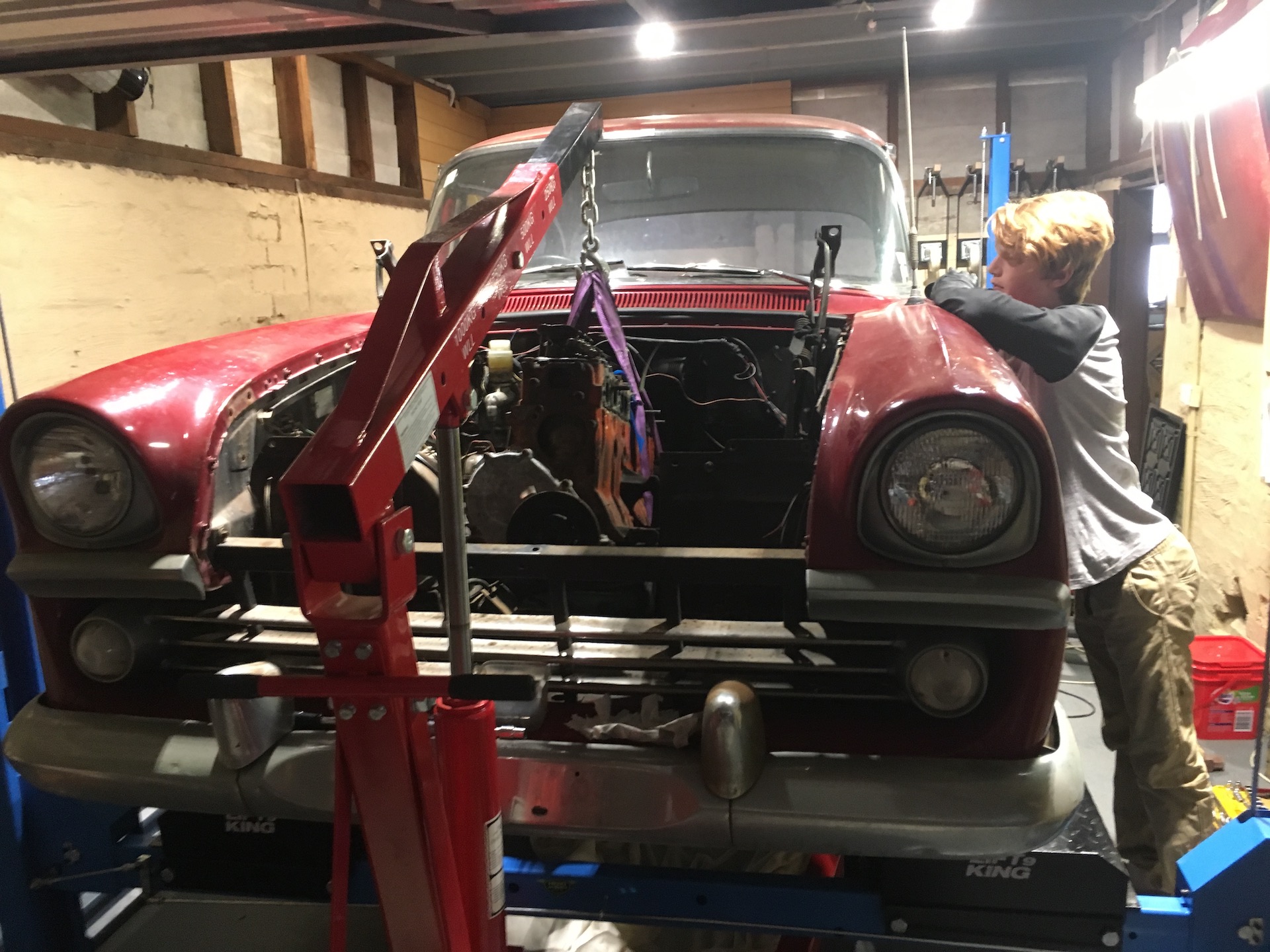

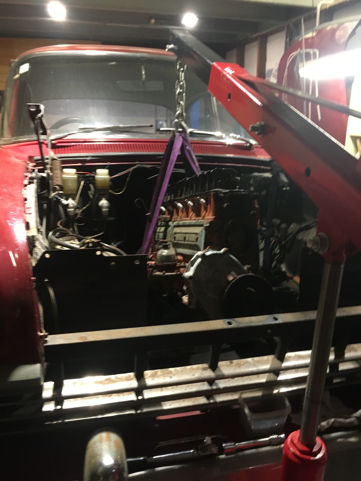

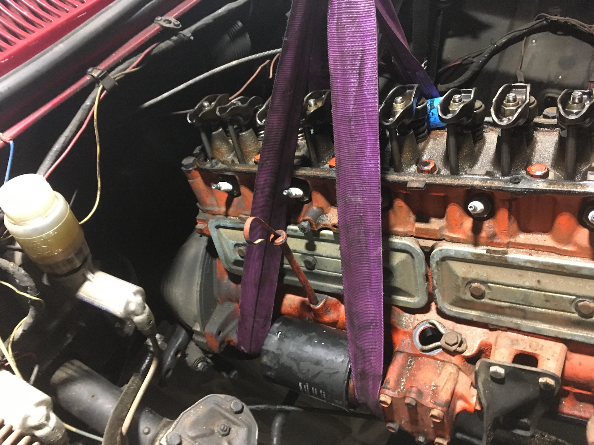

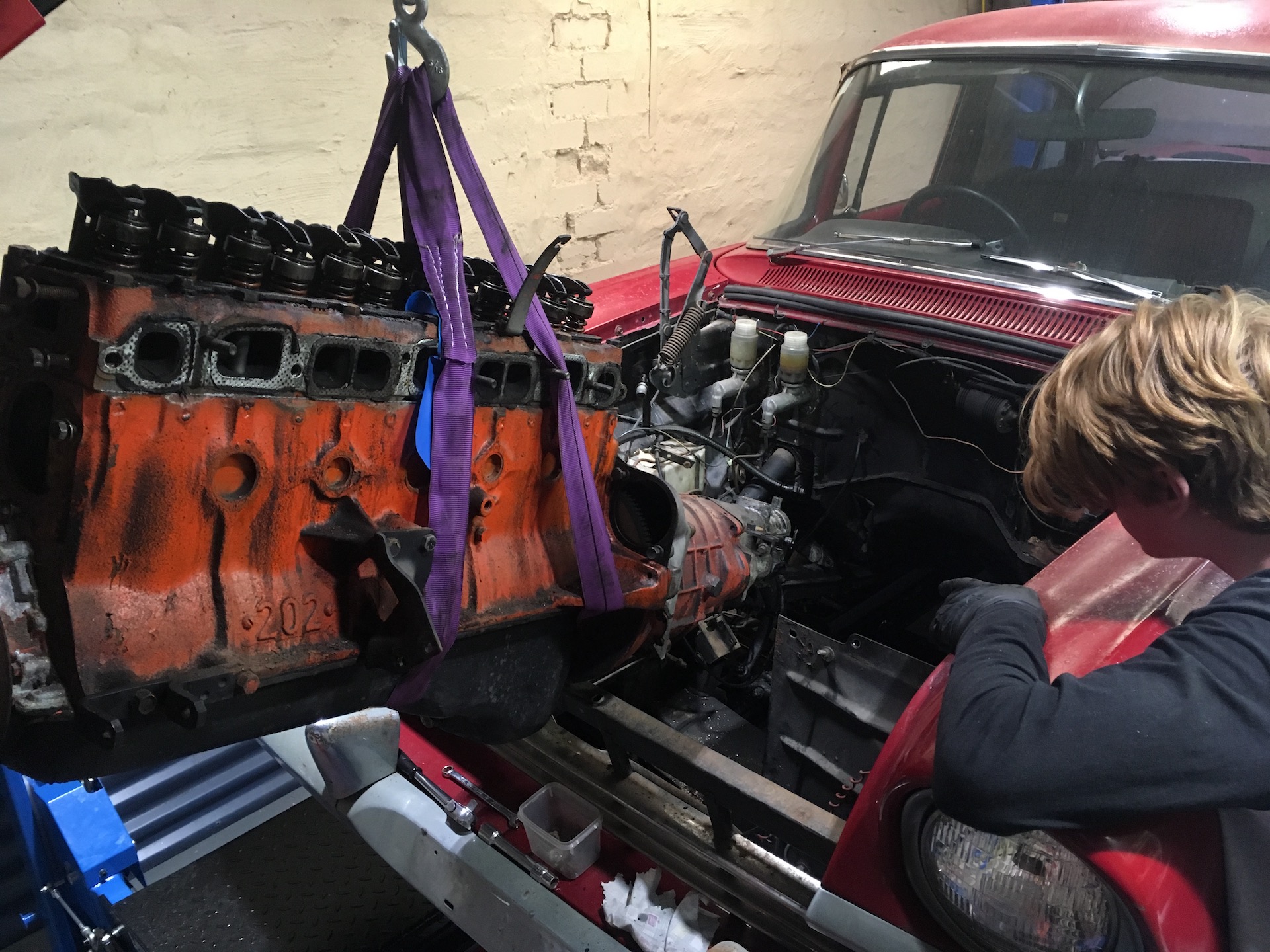

Unbolt the drive shaft, cut the exhaust (all welded), and it’s time to get the gumtree hoist into action

153634 repeat 153624. Looks like the leads are right but notes are wrong.
Thanks for the pics.

Ha! I don't know where I got that from then! Good startErrol62 wrote: Tue Nov 10, 2020 8:07 am 153634 repeat 153624. Looks like the leads are right but notes are wrong.

142635 works if you count them backwards in a loop if that makes you feel betterfunkyscooter wrote: Tue Nov 10, 2020 8:30 amHa! I don't know where I got that from then! Good startErrol62 wrote: Tue Nov 10, 2020 8:07 am 153634 repeat 153624. Looks like the leads are right but notes are wrong.

Advantage of hoist. Lower car when engine won't go any higher.

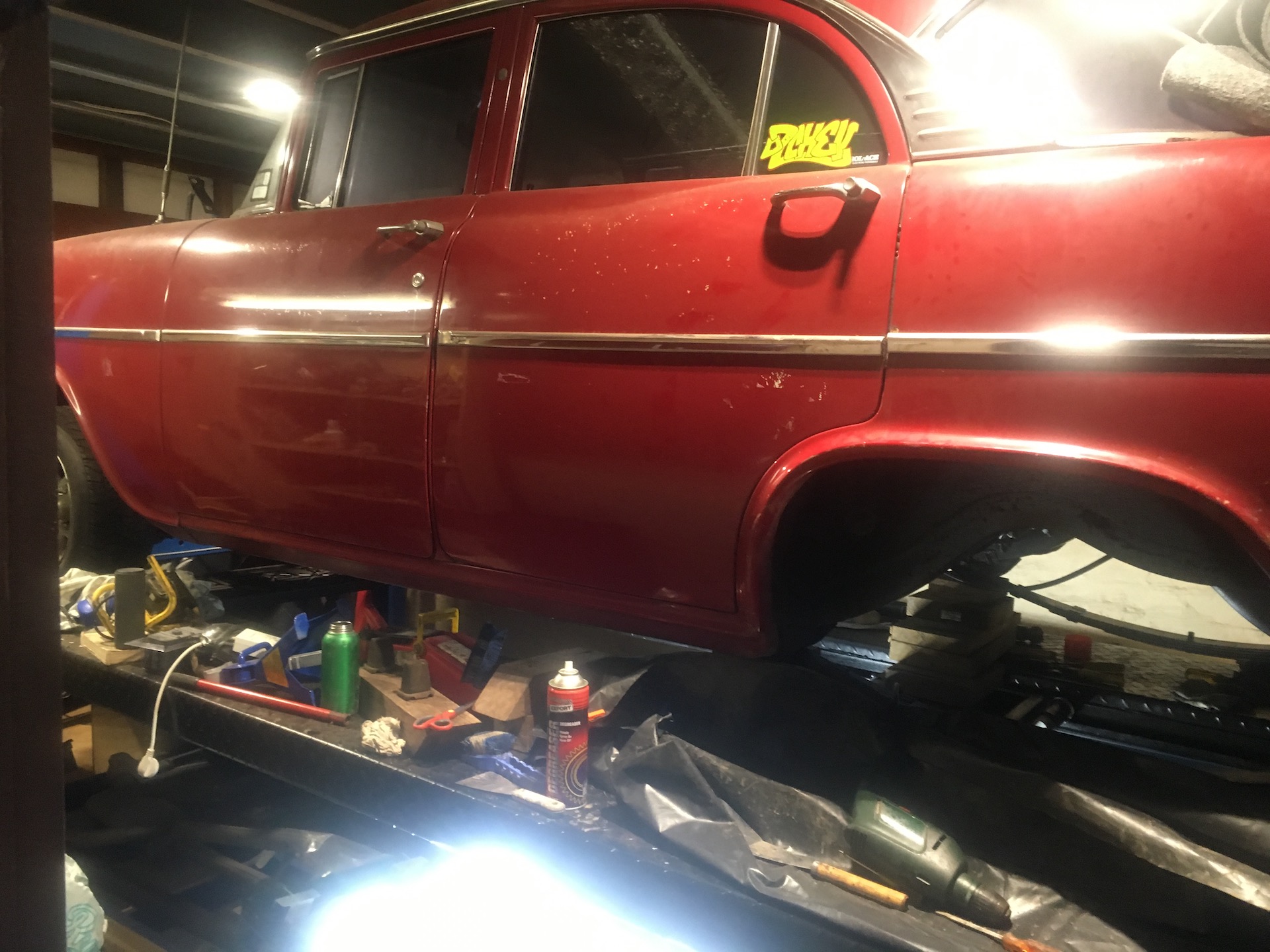

Re: Ol' Rusty - FB/EK Sedan
Diff out.
Notice the OzChev sticker on the rear door. Had the car 3 years clueless and its my Dad who's looking at the car for the first time and goes "Who's OzChev"
EDIT Gaps on the back door look right - but the trims not lining up. Must remember to fix that.
