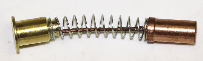

Harv wrote: Fri Oct 16, 2020 11:45 am https://www.ebay.com.au/itm/ORIGINAL-ST ... xyXDhSf~m6
:wtf:
I hate that thieving arsewipe and I have never met him .............. :evil: :evil: :evil: :evil: :evil:
Re: Horn contacts
Posted: Fri Oct 16, 2020 11:55 am
by FJWALLY
Cripes! It doesn't even look right - has a secondary spring inside the main one.

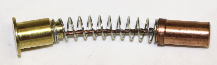

Has anyone ever tried the kits? 55-58 impala - all looks same except the contactImage
Re: Horn contacts
Posted: Mon Oct 19, 2020 4:01 pm
by gpi
that one is a solid rod...
this one looks closer...
https://www.ecklers.com/full-size-chevy ... 509-1.html
