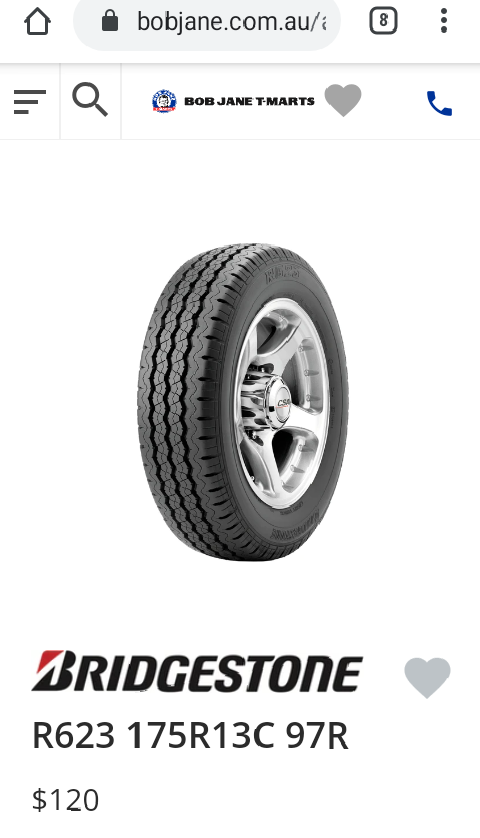

My current plan is to put Bridgestone R623 commercial tyres on the ute. I've had them on some vans and utes before
Re: 6 inch fb rims
Posted: Sun Jul 26, 2020 10:29 pm
They sound and look good Patrick. 608mm diameter says they are 80 profile. My local bloke is a Bridgestone select dealer, though you wouldn’t think it.
