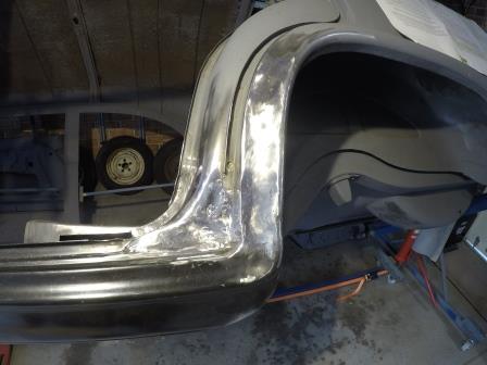

Posted: Sun Aug 09, 2020 10:01 pm
by Orange Betty
Well it's been nearly a year - progress has been slow - but progress nonetheless. Finally put the new Rares left outer sill on after having to remake the bottom on the A pillar and dogleg.
They were this:
Dogleg 1.JPG (35.71 KiB) Viewed 1203 times
OB LH lwr A pillar.JPG (80.43 KiB) Viewed 1203 times
Did the Frankenstein patch on the A pillar and some modification to the outsill bolt hole flange:
Frankenstein patch a pillar.JPG (34.46 KiB) Viewed 1203 times
and ended up with this:
A pillar 3.JPG (36.45 KiB) Viewed 1203 times
B pillar was easier and even managed to insert a seat belt mounting plate in there for later:
B pilllar.JPG (39.8 KiB) Viewed 1203 times
Dog leg wasn't so easy with all those panels meeting up and folding in on each other but I'm happy with the end result
Dogleg 2.JPG (39 KiB) Viewed 1203 times
and sill is welded on:
Sill final.JPG (34.75 KiB) Viewed 1203 times
And the subframe and door still fit!
Door fit.JPG (40.09 KiB) Viewed 1203 times
Good news is that the drivers side doesn't look nearly as bad so I think I will get away with A pillar and outer sill repairs in-situ.
Dave
