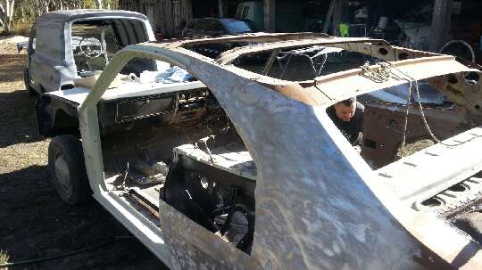

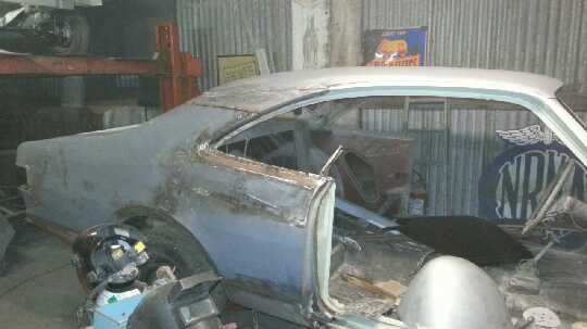

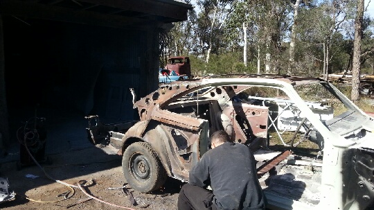

Got the car all cut up today. This would have to be the biggest resto i have ever done. I hope i pull it off.
Im mounting all the other guys shit work on the wall. The wall of shame. Im so tempted to take the parts to his work and dump it out the front
Re: ht monaro
Posted: Fri Jun 21, 2013 8:06 pm
by bootlegger

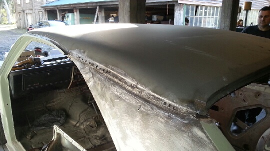

The roof is tacked on.
We deliberated about leaving the roof off so we could go to the sumernats and show everyone our tits.

Yeah mate. I just wanted to ask about fb door trims. Im not a machine. There are two of us working on this project.
He cut to car up and i fitted the roof. Most of today i spent getting the eh van ready to paint.
Now watch it rain for a week.

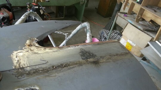

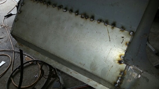

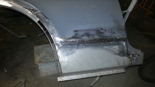

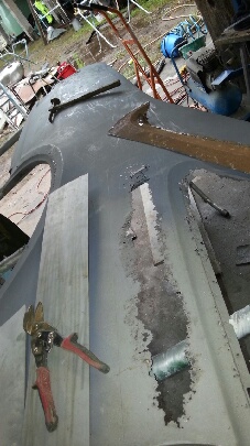

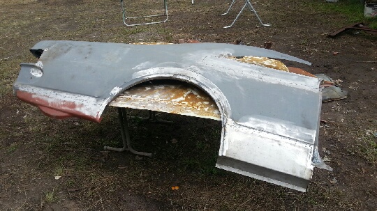

It took three full days to repair the replacement quarter panel. Im finding im going back to oxy welding more and more now. If i can get behind the panel to hammer weld it seems to come out better plus there is almost no grinding. This panel apart from rusty was also really smashed up near the tailight. I must have put twenty or thirty shrinks in that area to get it back into shape.
It feels pretty good now and will only need a thin skin of bog to get it right.
It would be nice if new affordable repo ones were made.

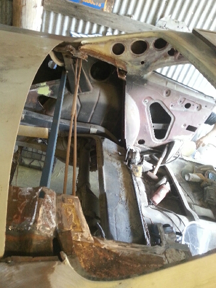

Either way yesterday i trial fitted it.
Next week ill rebuild the lh quarter then dismantle all the panels off and paint them inside before welding on.

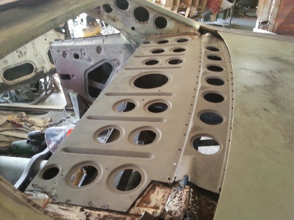

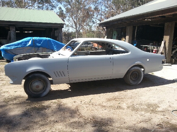

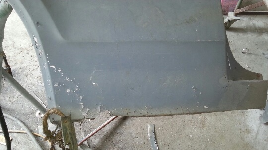

Since completing my eh ive got stuck into other projects. This ht heartbreaker is finally getting there.sice last posting ive replaced the rh quarter inner panel. Fitted a second hand parcel shelf and rear panel. Even though the owner supplied me with repo ones they didnt even come close to fitting.
A rusty scond hand section was split, blasted, repaired and fitted to the car.
Off course once all welded in the back window didnt fit so I had to split the panels and enlarge the opening a couple of mill.
The next job was to make the bootlid and the chrome gutter moulds fit. Again several hors were spent playing around with it.
All the panels are done except the rh front guard which as all the other panels has been destroyed by the previous beater.
The car is now in hifill. Its going back to the owner to be completely assembled to make sure it all fits together right.
Once the primer hardens right up over a couple of months it will come back for paint.
