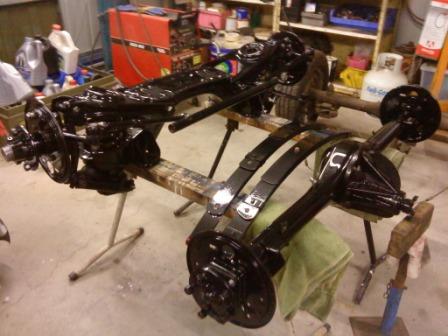

Rear springs all finished and ready to be fitted.

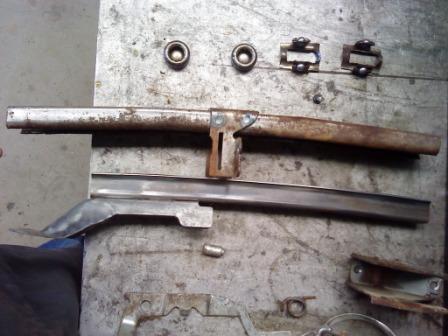

Decided to tackle my front door hinges and replace the hold open spring plates.
Firstly drilled out old rivets and punched them out to remove the old broken plates. It then took some brain scratching to work out how I was going to do the rivets. I eventually made up a small adapter for my old Coxhead brake lining riveting tool. Its a bit fiddly at the start getting it into the inside of the hinge but overall it only takes a couple of minutes to do. It took longer working out how to do it in the first place. :shock: :shock:
Pretty happy with the outcome :D :D :D
Diff housing studs fitted up and rear axle bearings fitted. Just got the diff centre to paint and fit.

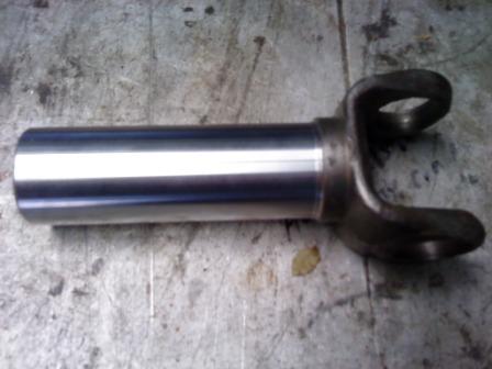

Got the driveshaft yoke back after having it metal sprayed and remachined back to orig size

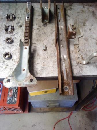

Made a start on stripping and repairing seat slides

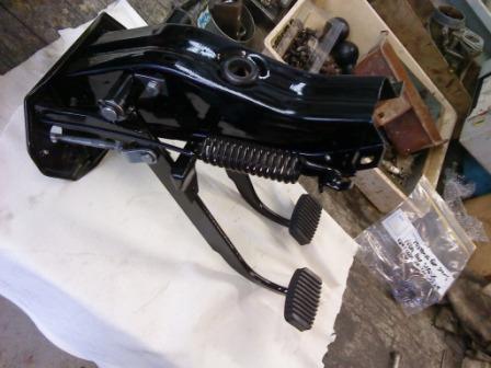

Pedal box finished and ready to go.
Finally got diff and front end finished. Just brakes to sort out.

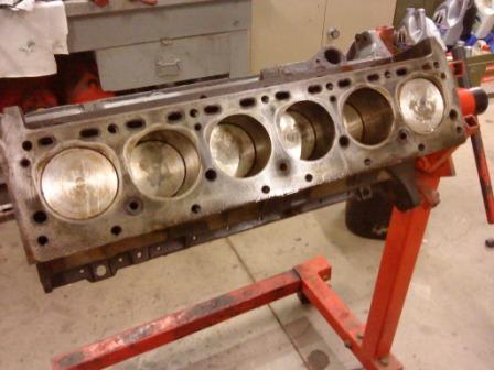

Finished decarb of piston crowns for what little was there.
Now time to start setting up for the full flow oil filter system.

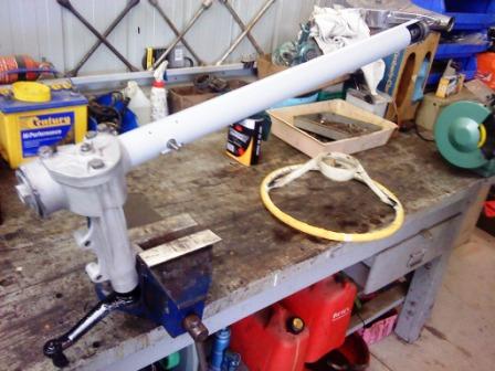

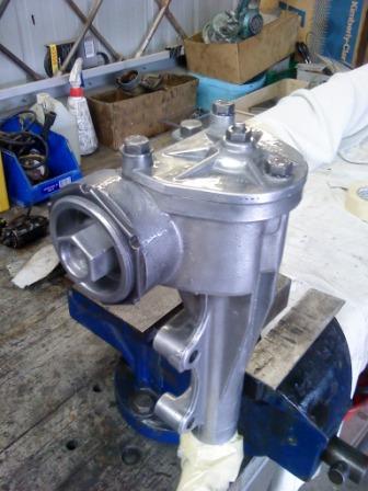

Had a hell of time doing the steering box up mostly with getting out the old outer bearing race in the top of the box out. Needed some trickery with the Mig welder to put some spot welds on the race so I could shrink it to get it out. Just a shitty spot to access without removing the column tube off the box.
Box polished and clear coated. Column tube to go.

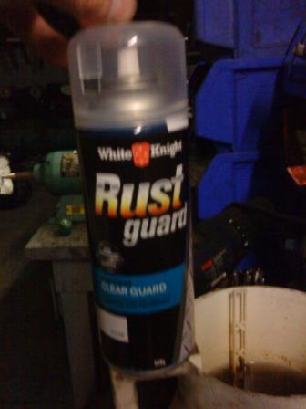

Question - what brand/type etc clear coat did you use on the steering box? It's OK to use straight over the bare mteal? What sort of prep?
Posted: Tue Oct 02, 2012 9:21 pm
by Craig Allardyce
G'day Stewart,
I used White Knight Rust Guard. Its good for alloy, brass, copper, etc to prevent corrosion/tarnishing. I got it at Bunnings.
I had the box soda blasted to get all the old crud off it and then buffed it up with wire decarbonising bit using a drill.
Washed it down with dual purpose thinners a few times then let it dry. Applied the clear coat as per instructions - did 3 coats.
I'm hoping overtime it doesnt go like some laquers i.e. browns off. Its been done for a few weeks now and still looks ok.
Hope this helps.
Cheers. :thumbsup: :thumbsup:

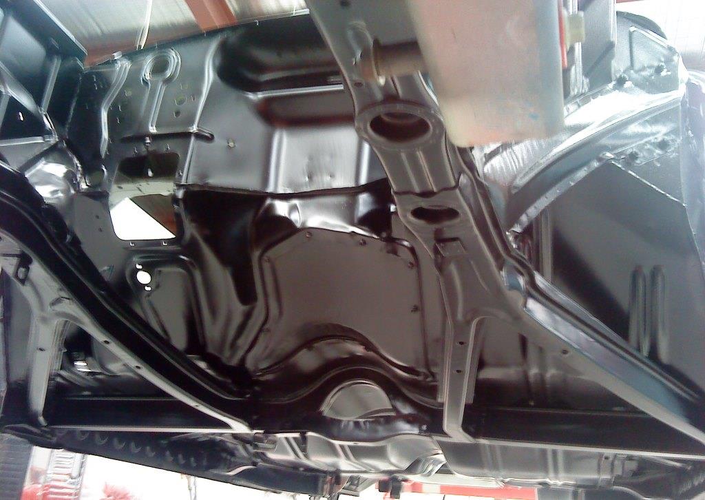

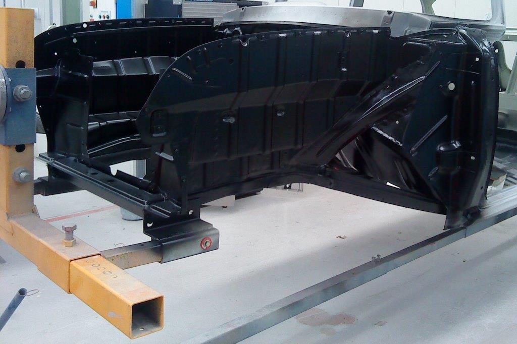

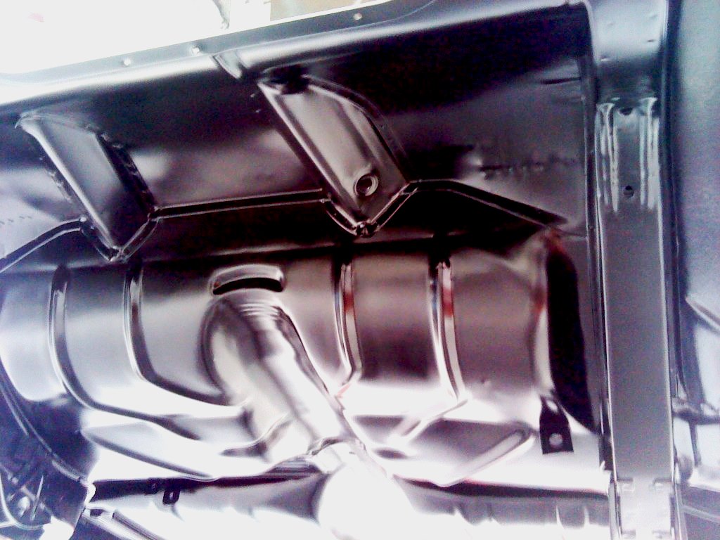

just a few update shots as the paint starts to go on. Finally finished all of the minor body repairs needed and now its time for some colour!
Have done as much as I can do with matching and finding the right colour mix formulas. Starting next week to do some trial mixes of Apache Red. Engine bay and under floor has been done in satin black with stone-guard in the wheel arches and boot areas. Have tried to replicate the areas as would be done in the factory but with some neater edging.
