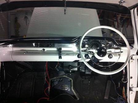

A few more pics for today. Dash, heater, and electrics pretty well done. Also a good side on pic of the engine before I fitted it.
Looks like I'm not the only one here guilty of the sin of having an EK special badge on my FB's glove box.
"Now lets all just calm down here. Yes, a crime has been committed here, but surely there are no real victims here..."
-that's the statement I've prepared in case the police come to drag me off to prison.
Looking sweet as, love the engine, very tidy.Craig Allardyce wrote:A few more pics for today. Dash, heater, and electrics pretty well done. Also a good side on pic of the engine before I fitted it.

Re:
Well spotted Richard. The badge/glovebox lid has always been that way since I've had the car (over 20 years). I knew the previous owner who had it for about ten years and he hadn't changed it. The glove box lid was stripped back on this rebuild and the top and undercoats matched the rest of the car. I wanted to leave it there as I found it as it's part of the cars history i.e. options fitted. In my mind with the amount of options that were done I think this was one on the list too, but done at a dealer well after the original sale of the car.Bluehaze wrote:Looks like I'm not the only one here guilty of the sin of having an EK special badge on my FB's glove box.
I have yet to start on tracing the full history but so far the options found fitted were/are:
Sunvisor
Hood ornament
Front and rear mud flaps
Number plate frames
External rear view mirror
Windshield washers
Thumbprint dress rims
Door scratch plates
High and low note dual horns
Reverse lamps
Boot lamp
Warmaride fresh air heater
Glovebox lamp
Hood lock
Gear lever lock
Rear seat speaker
Hub cap medallions
Holden Deluxe radio
Locking petrol cap
Vanity mirror
Oil filter (removed for full flow set up)
White steering wheel
Handbrake light
Power brakes (after market VH44 booster)
Tow bar
and the rare one for a FB; Heavy duty radiator package
There is however one other "crime" that you missed. I've fitted EK stainless trims on the dash
