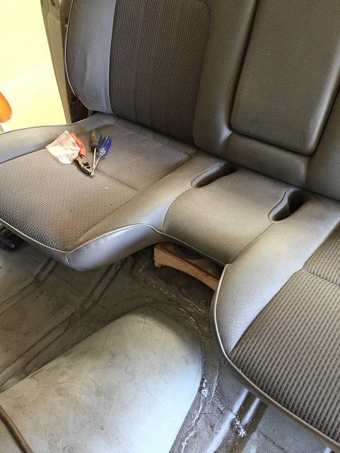

under seat.JPG (135.84 KiB) Viewed 786 times

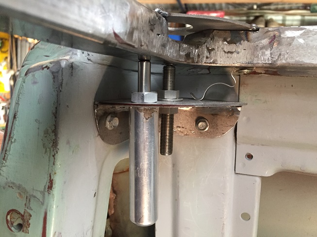

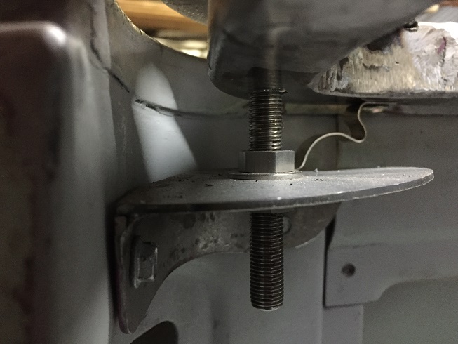

Sorry Clay, the hard cover will have black vinyl finish, possibly padded but not a polished finish.
I rejigged the poppers to the back corners to improve the lift. A little more the clean up the welds, etc.
hold down 1.JPG (103.98 KiB) Viewed 761 times
I have sorted the gas struts and just need to weld the mounting lugs.

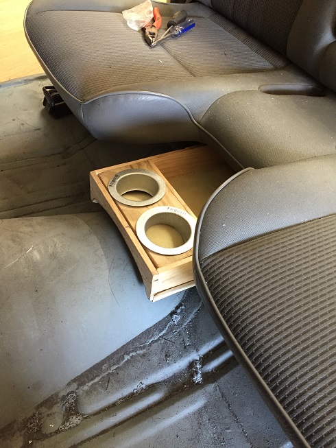

It has been a little while since I post any progress on Ammo’s ute but I have completed a few things of late.

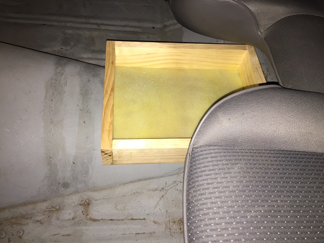

Under seat sliding tray required the lowering of the floor hump for clearance and manufacturing some brackets.
I’m happy with the results.
Undertray 2.JPG (129.19 KiB) Viewed 732 times
Undertray 1.JPG (141.7 KiB) Viewed 732 times

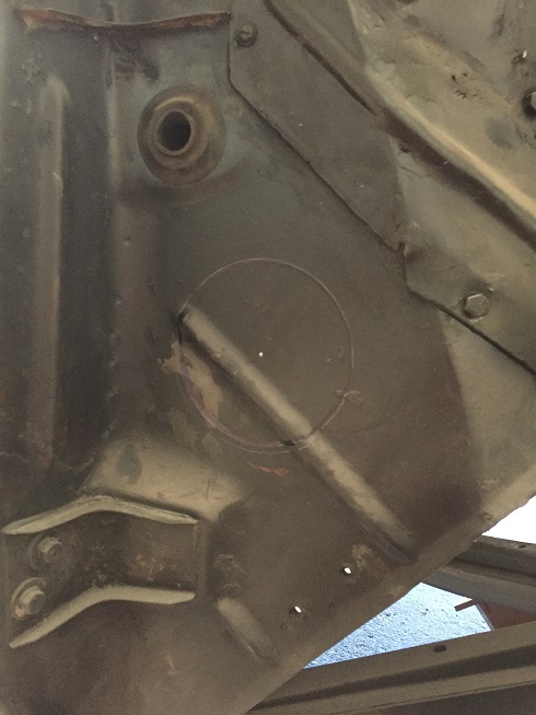

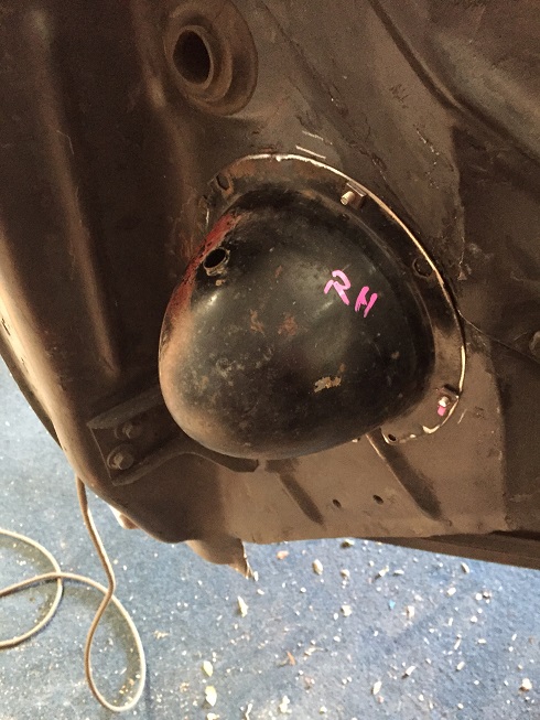

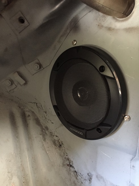

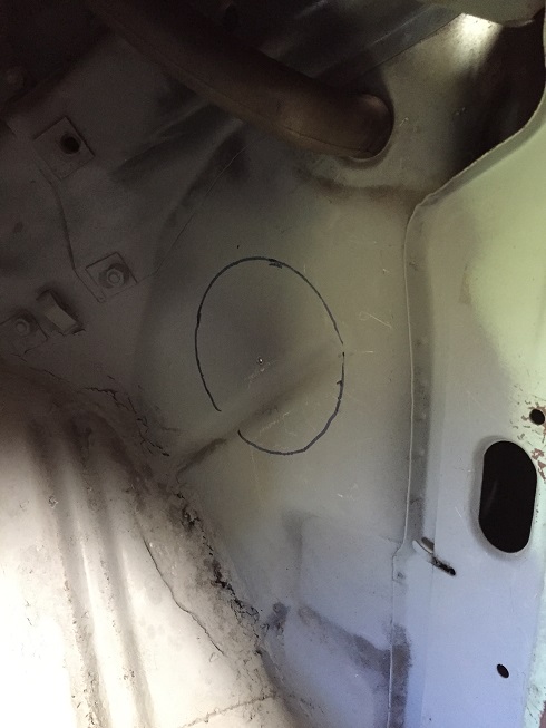

I was not going to put in a radio as such but as the ute is for Anne-Marie I softened.
Reluctantly cut holes in the inner guard and added spare headlight buckets. Not new idea but a goody.
Speaker 1.JPG (100.85 KiB) Viewed 732 times
Speaker 2.JPG (82.1 KiB) Viewed 732 times
Speaker 3.JPG (133.11 KiB) Viewed 732 times
Speaker 4.JPG (92.49 KiB) Viewed 732 times

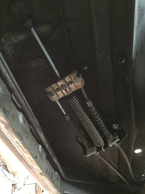

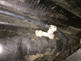

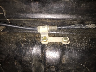

I have completed the bloody handbrake setup.
Ended up using a combination of short RH cable and change the knob to suit the balance plate.
The LH side is a part original and Laser for the wreckers.
It would have been easy to do a centre mount or even easier to leave the original setup but I now have the cables tucked up to the body.
brake 1.JPG (130.59 KiB) Viewed 693 times
brake clamp.JPG (46.63 KiB) Viewed 693 times
clamp 2.JPG (52.66 KiB) Viewed 693 times

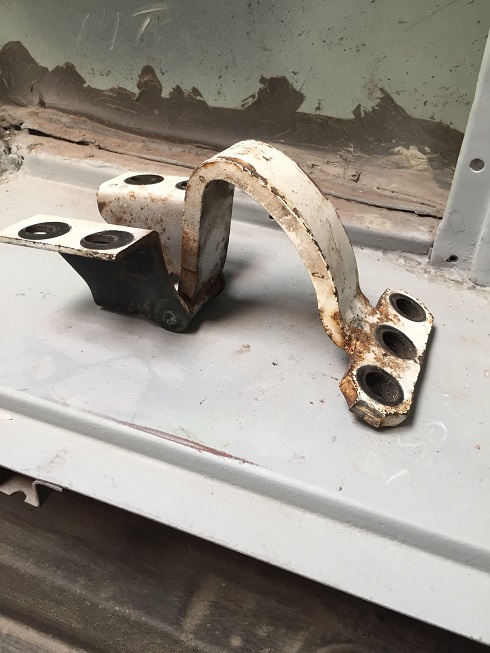

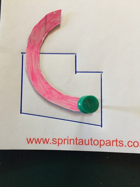

Little progress on the tailgate hinges but I did try using the upper tailgate hinge from a HQ van.
These there too big and did not have the correct arc.
HQ upper hinge.JPG (112.62 KiB) Viewed 693 times
I when back to cardboard temples
step 1.JPG (87.5 KiB) Viewed 693 times
step 2.JPG (83.31 KiB) Viewed 693 times
I have some thick walled pipe to cut, bend and shape so hopefully I will have hinges shortly.
