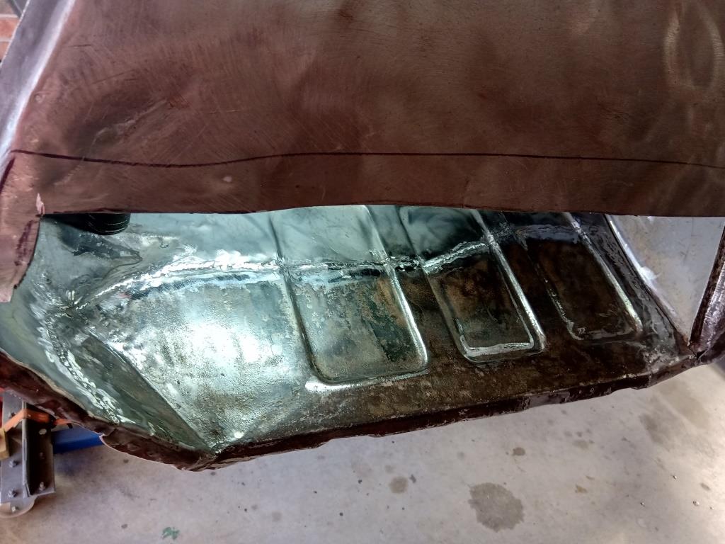

Well it's been awhile - again... But started work on the right rear qtr panel
RR Qtr.JPG (69.97 KiB) Viewed 7680 times
I have the Rare Spares lower patch panel so cut out a section to reveal the inner swiss cheese
RRQTR inner dmg.jpg (57.13 KiB) Viewed 7680 times
Donor section not perfect but salvageable
inner donor patch.jpg (65.62 KiB) Viewed 7680 times
fixed inner.jpg (113 KiB) Viewed 7680 times
Now just trying to get the Rares patch to fit.
