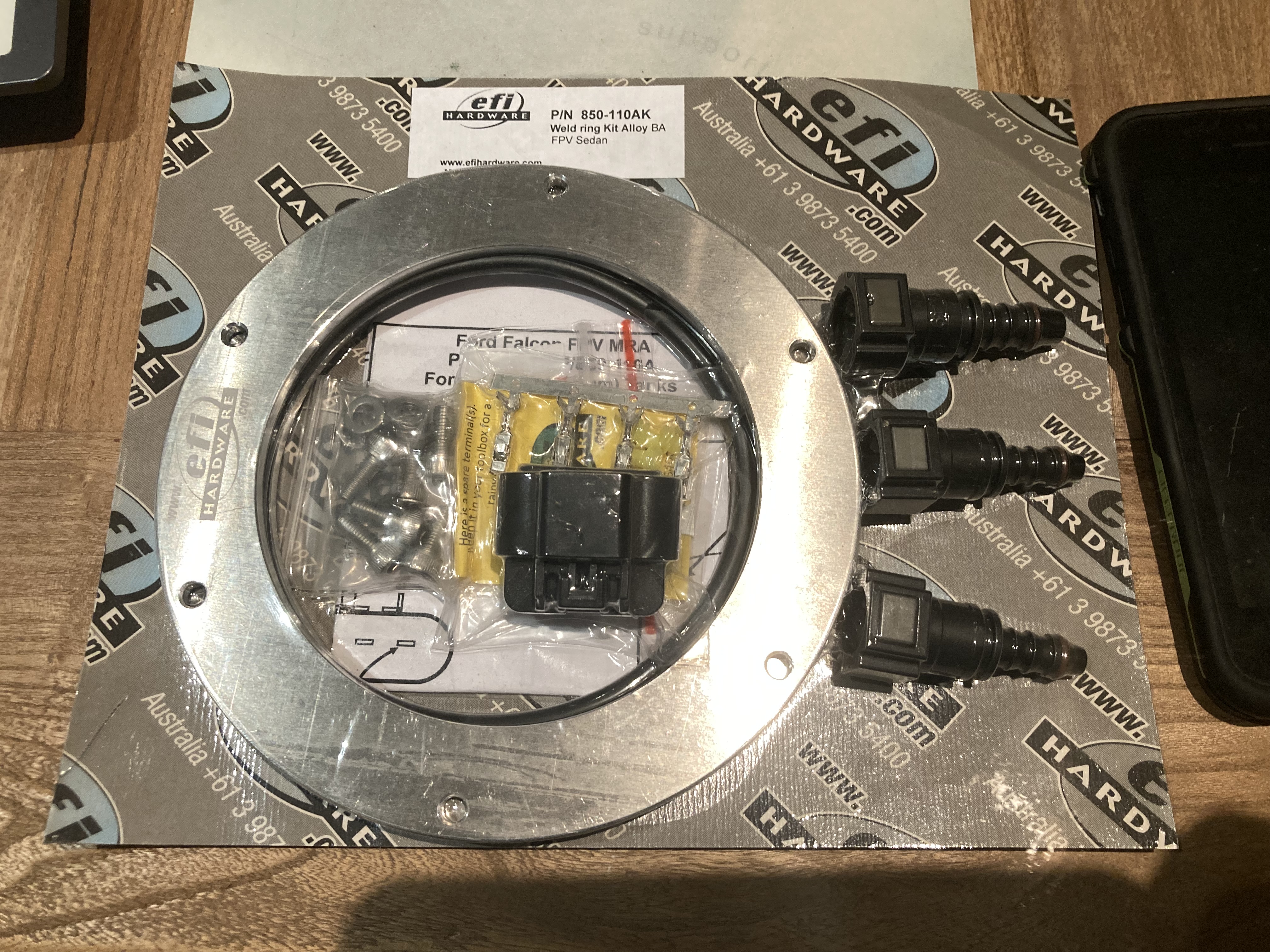

Got more goodies todays,
This is a weld on kit to suit the BA falcon pump.
It comes with weld ring and top ring to secure the pump, clip on cable adapter, fuel clip barbs gasket and all the screws.
Comes from EFI Hardware Melbourne. Just need the tank now so I can start chopping it up !!!!

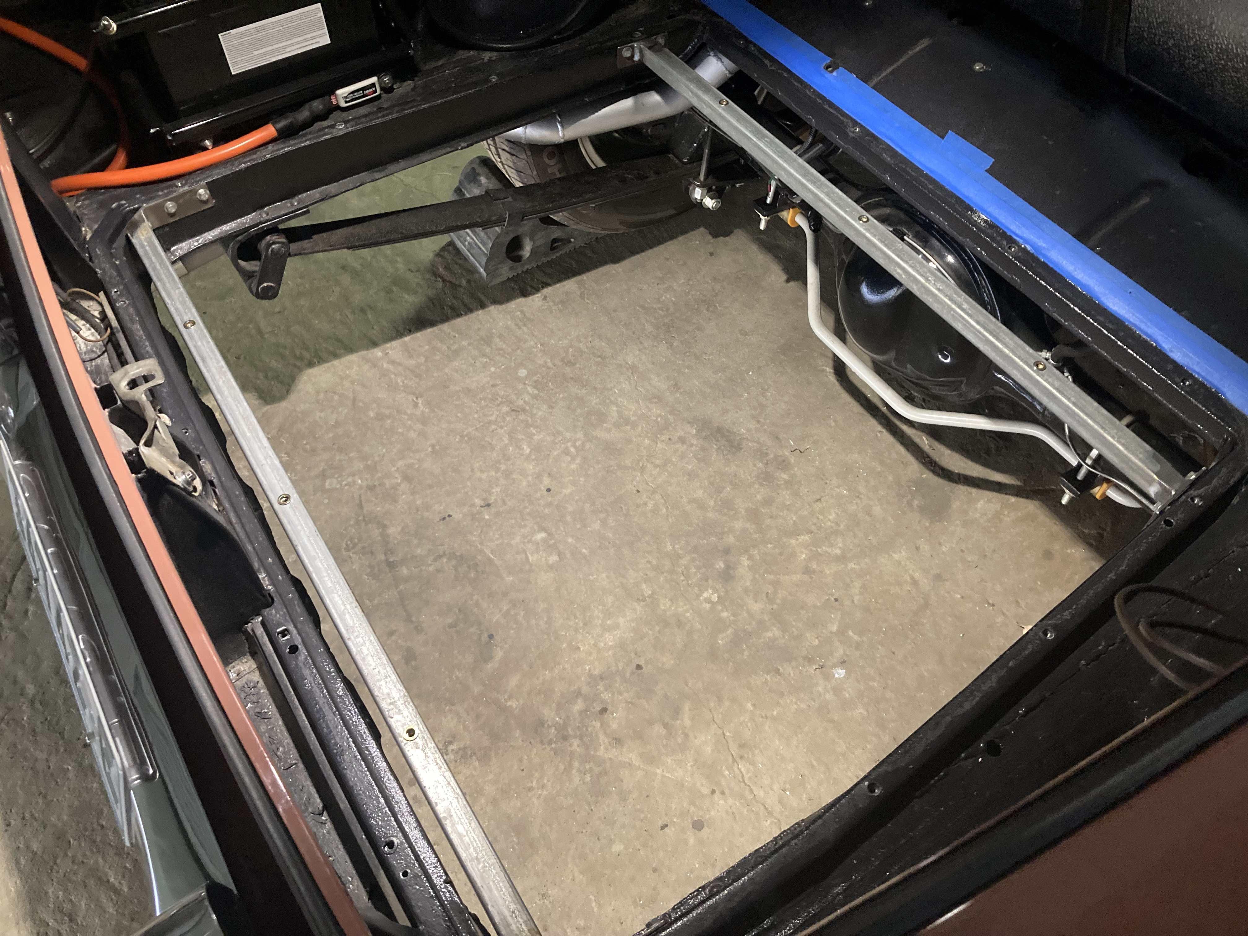

So some bracing in the boot and the new tank.
IMG_2281 - Copy.JPG (5.25 MiB) Viewed 2811 times
Out with the old in with the new, Ive got a bit of plumbing to do as well as some more wiring so a couple of days in the shed.
Brand new Holley sniper 2, I am also going to change the distributor to a full electronic that is controlled by the Sniper computer.
I have my fingers crossed that this system works without the issues the old Analogue system had, some say the carby is better but I can't help myself I need to tinker !!!!
