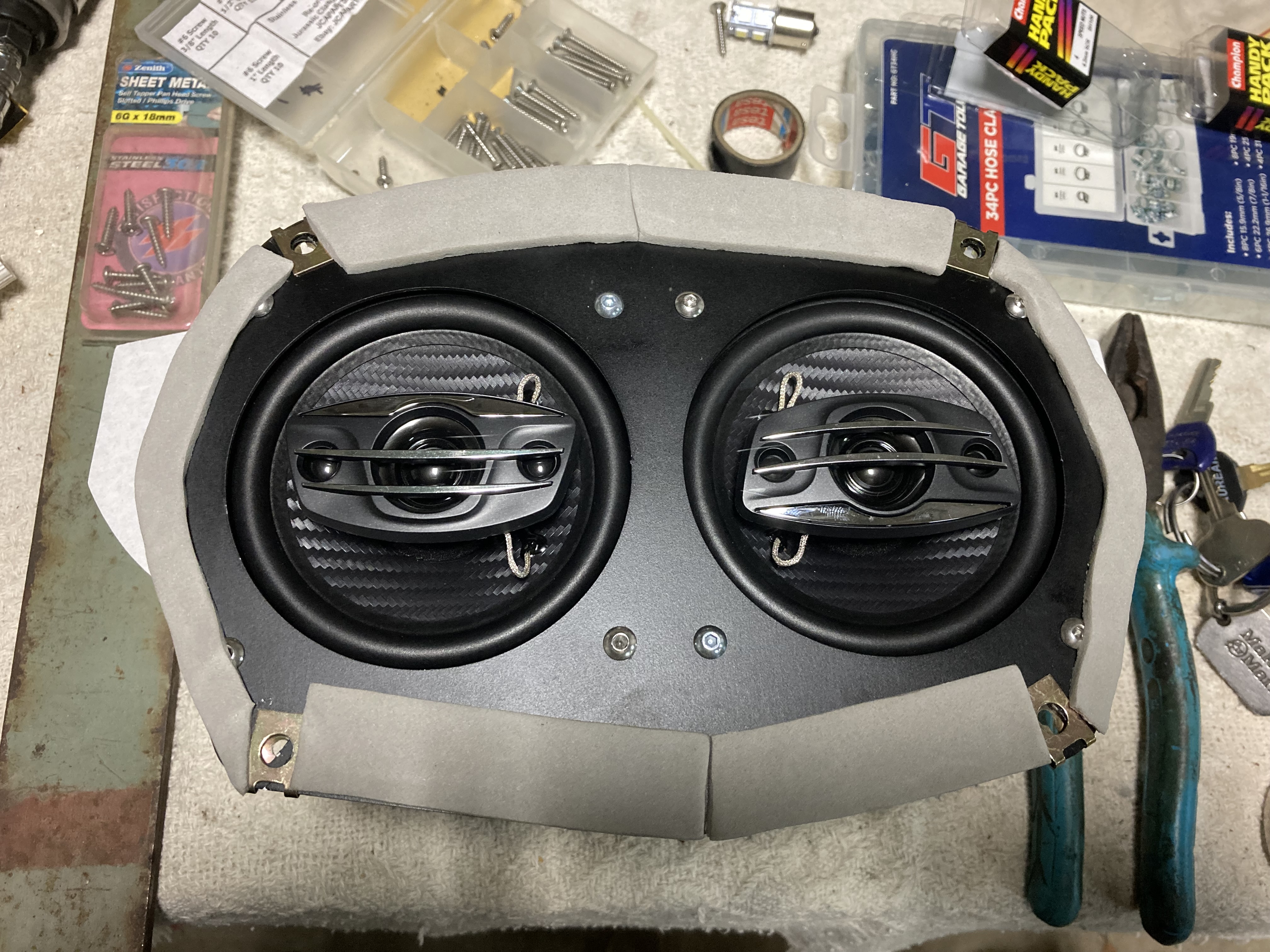

I was thinking how i could blue tooth a speaker to my phone for long trips and found these, they are made to fit into the old speaker hole then operate via a blue tooth control box, nifty i reckon. Sound is quite good although not going to break any sound records ! You can adjust the graphic equaliser on your phone to achieve the tone you like, oh and its stereo to boot.

That’s pretty neat Greg

I did a similar thing with speakers in my ute when I built it , didn't want to cut holes anywhere or put them in the door trims
, just used the old stereo in the glovebox trick though , and i plug my phone into the USB port on the stereo for tunes across the Nullarbor etc.

That’s a great idea
