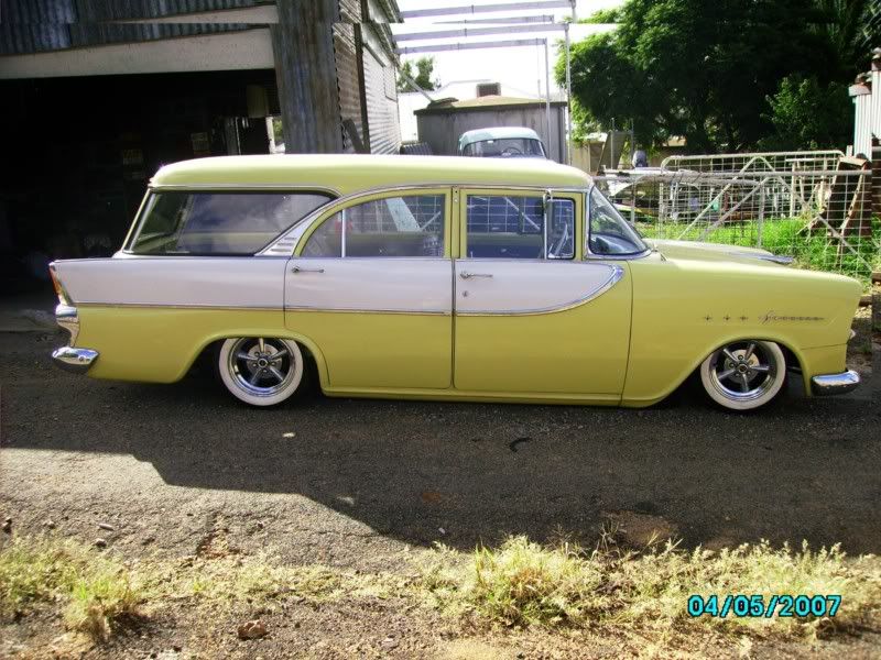

Id imagine this picture I did for you yonks ago may be giving you some inspiration Mark.
And here the original
Guess who's coupe is in the background :)

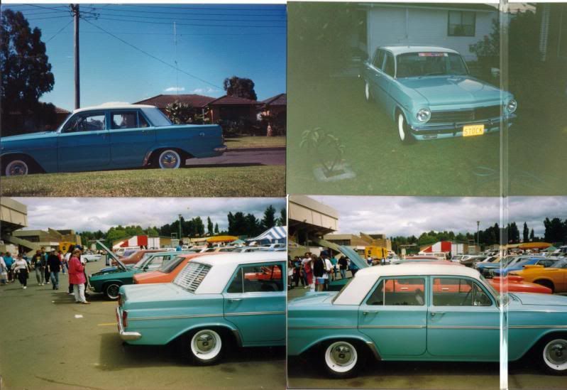

Some cool cars come outta Junee ,
For anyone else tuning in this is my brother in laws EH that we brought from Marks house long before Mark had bought the house and it was my brothers Aunties house.
He forgot to grab the front screen when we picked it up and ten years later when Mark owned it the windscreen was still there in the shed :) Spooky stuff

Nice photochop and anecdote Harko 8)

that photochop is freaking sweet.
