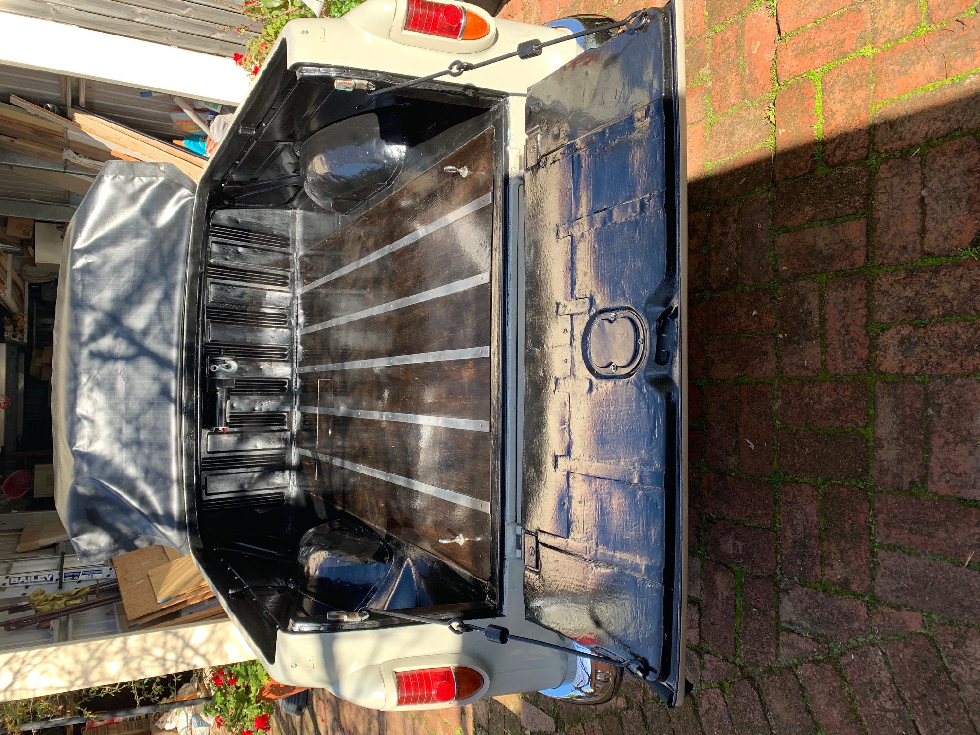

Been a bit slack in not uploading some further pics of my ute after tidying up the tray. Did some repairs to the side panels with my oxy set as I don't have a mig welder (yet).
Used the KBS chassis coating kit in satin black which worked out good. Also repolished the timber and the aluminium strips as well.
Also tidied up the remote control for my electric winch that is mounted under the parcel shelf. Used a trailer connection to keep it tidy.
The winch makes it a breeze to load the bike on my own although don't really need it for the lightweight jap stuff mainly the heavy British stuff :lol:

Nice work Stephen. Those little trailer plugs in cast alloy look great. Jap bike?!

Errol62 wrote: Tue Feb 16, 2021 6:23 am Nice work Stephen. Those little trailer plugs in cast alloy look great. Jap bike?!
FB ute driver, EK van project
Yep Clay, a neat little Yamaha with a few modern features that I'm not use to! Mind you it is now 25 yrs old but has only travelled 6600 kms in that time.

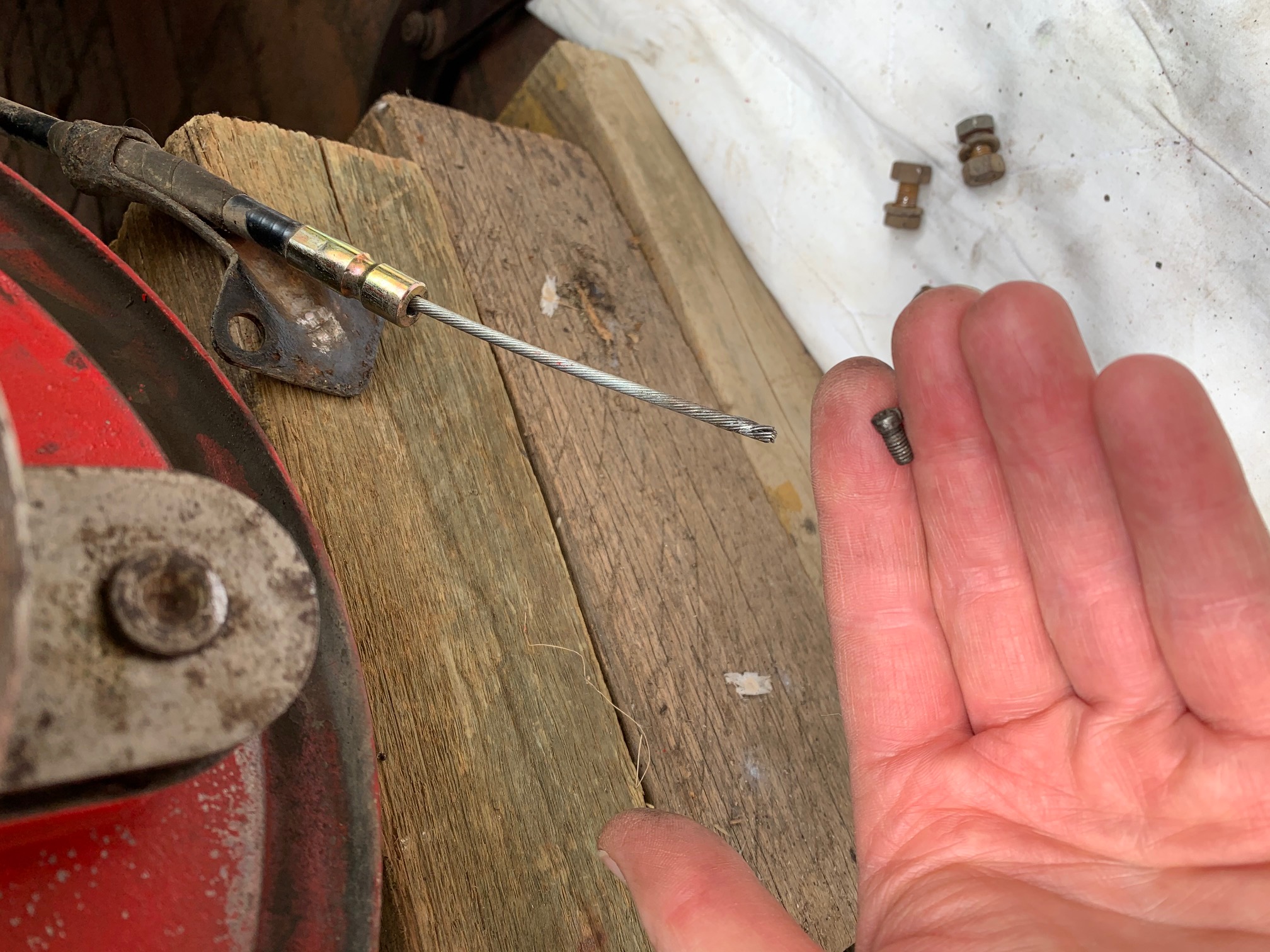

After driving the ute for the past 8+ yrs with no handbrake decided to pull the wheels and have a look. Passenger side looked ok.
Passenger side all OK

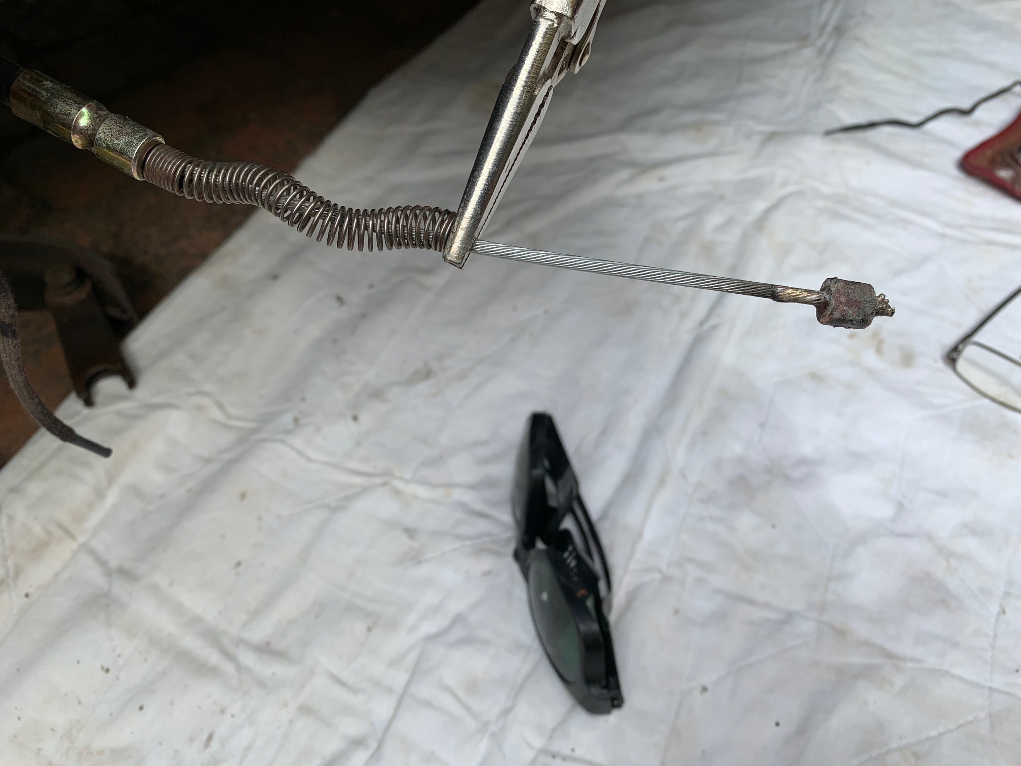

Drivers side a different story. All I found was this screw, dunno where that came from but hex nipple (as per passenger side) no where to be found?
Drivers side
Drivers side
Made up a brass nipple and silver soldered it on. That won't come off anytime soon. I can now dispense with the block of wood that I have been carrying around as my wheel chock (aka handbrake).

Isn't it funny how you will put up with a niggling problem like that for years only to find its a simple fix :ebiggrin:
Posted: Tue Jun 22, 2021 11:22 pm
Must be a reproduction cable I think with the brass hex end Stephen. You’re a better solderer than me I’m sure. I’d say the originals have a swaged heavy alloy ball on the end. My retrocables fb hr one had cylindrical swaged stops.

Yes that was my thought Clay, a repro cable. Probably why it failed!
Yes, got another couple issues to fix........... one day🤨
