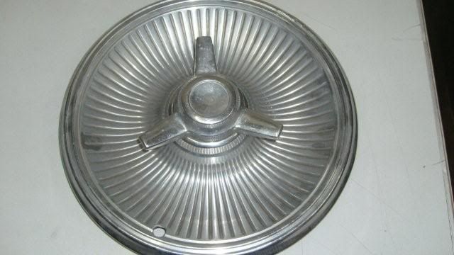

I picked up a set of "H" emblems a while back, but am not sure how they attach to the hubcaps?
Does anyone have fitting instructions for these by chance? (Did Nasco produce fitting instructions for these?).
Failing that, could someone pls post a pic of the rear side of their hubcap, showing how theirs is attached.
Jamie.

Single screw according to current ebay listing with pictures

hmmm ....
Thanks - yeah I saw those ....
But that sort of contradicts what I can see on mine (my h emblems have a threaded bolt on the back of them).
And, Im not so keen to take eBay as gospel ...
Would prefer someone/something a bit more authoritive - ie. FB EK Forum Member / or / Nasco Fitting Instructions.

Jamie, Just pull out the thread and find a short screw to fit. The flat head of the screw wont interfere with the grease cap on the front.

Just adding to Theo's note, make sure you use some locktight, you don't want to loose those emblems, whilst cruising along.

Losing the emblems whilst cruising along is definately my biggest fear!
I'll give your suggestion a go Theo - thanks mate.

I just use spring washers on my tri spinners!
