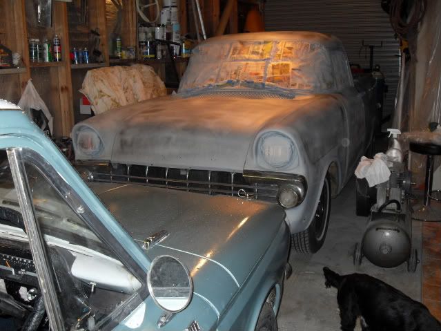

Today was 83% humidity so at the moment the old girl is all dressed up with nowhere to go. I have a few days before I have to change the masking tape round the windows so fingers crossed for tomorrow. If it is situation no change, then I will spray towards sunset a couple of coats and thin it down just to get a sealer over it all.

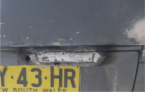

Sadly I had to weld in a lot more than I had bargained for but its all good practice. The only issue I had was when welding in the below patch, I blew a nasty hole that I thought was solid. I was able to put a smal patch in and just mig around it rather than oxy which is what I used for the rest.

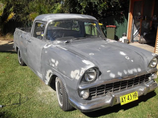

I had to take it to metal in the rear half as by the time I had chased down the rusty patches it was very bumpy. Such was the ammount of hi fill that had been placed on her a long time ago
I couldnt wait any longer so started rubbing back the light coats I put on the other day to see the highs and lows.

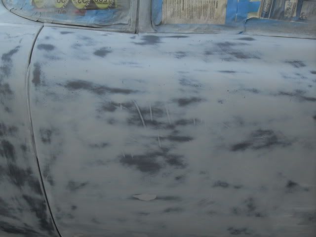

Should I rub it back to metal or leave it? When I run the flat of my hand across it I cannot feel it at all and even when I try to pick it out with my finger tips, I still cant feel it. I can only see it.
What should I do? Any help is greatly appreciated.
Give it another light coat and block it back, I bet it disappears. Looks to me like the primer has filled all the marks already, hence why you can't feel it.
