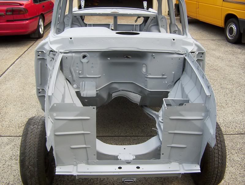

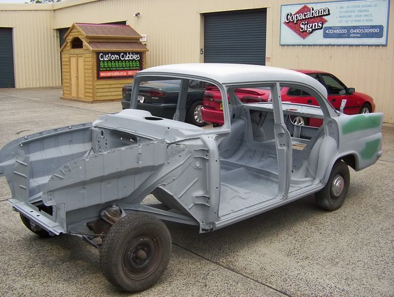

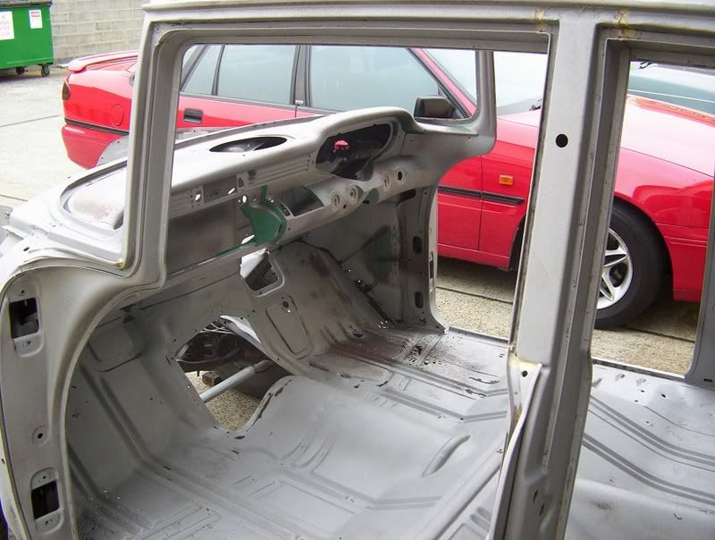

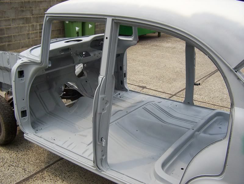

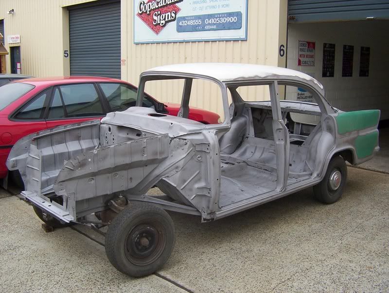

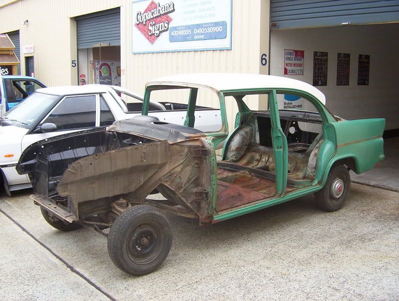

Hi again everyone. Just a few photos of the car after sandblasting, and now in primer. Four hours to sandblast and two days to get all the glass out of the car :twisted: :twisted: . Anyway, its now in primer, so I can see the rust properly, not as bad as I thought it would be. The front subframe comes off tomorrow to repair the firewall. New front floorpans and CRS tunnel hopefully next week. All is looking good so far, will post more pics as it develops. Regards, Steve
Off to the sandblasters we go !!!
Back from sandblasting ready to be cleaned out :evil: :evil: :evil:
All cleaned out and in primer. Now the fun begins !!!!!!!!!!!!!!!!!!!!!!!!!!!!! :lol: :lol: :lol: :lol: :lol:
