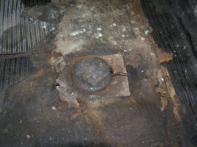

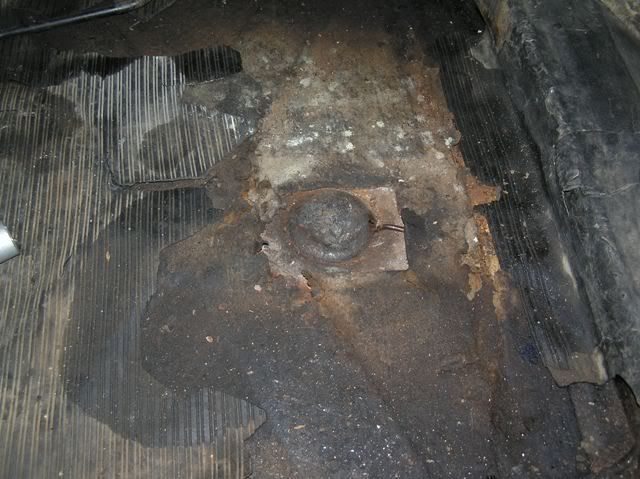

My problem is similar to the one in the first link, and I have had fuel leak into the boot and it was the cause of my boot mat being eaten away.
When I look at my fuel tank from the boot, (I have pulled up all the layers of matting & there is nothing else but flat sheetmetal on the rest of the top of the tank) all I see is this:

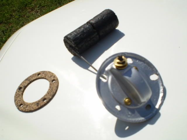

I cant reconcile this to the pic I got from Stingray's post (the second link above) of his fuel sender.
I realise his is a wagon and so is different, but I've seen a sedan one in another pic. Nowhere on my car can I see a plate with 5 holes that would require a gasket..
I believe the fuel is leaking from here
Can anyone shed any light by relating to the picture of Stingray's out of the car as to how the fuel sender is actually mounted in the fuel tank?
I can't work it out :?
Is this the usual place (red arrow in my pic) that they leak from?
My fuel gauge doesn't work and I can't fill the tank up because it leaks into the boot, so I have to guess how much I've used and fill up 15 litres (approx. half a tank) at a time :(

The plate is under that cover, just pop the cover off and you will find it, Trev 8)

Bingo! :wink:

I scraped the rust away with a screwdriver & tried that but maybe I need to try harder.

Post by MINT62 »
if you get any crap in the tank you may want to flush it, to avoid problems down the track
id rip that boot mat etc out & freshen things up a bit in there :wink:
also i found if you put a small bead of silicone around where the tank meets the underbody, youll stop the water getting in once & for all
do it right the first time if possible
cheers ray 8)

Hi Paroharo,
as mentioned - it's under that cover-
Get your vacuum cleaner out and clean up all the crud under that cover once you get it off............ once you remove the unit anything in that round recess will fall in............ and look out for Bogong Moths (sorry- a short story I wrote some years back when I spent a week trying to get one out of my tank whilst doing the same job).......
There is only a cork gasket which seals the unit in place. I would suggest using some Permatex gasket goo to seal both sides of that gasket - it will certainly be hard to remove later - but how often are you going to replace a unit................... and cork will crumble if really leaned on.
You may wish to use a thin flat piece of wood to lever something on rather than dent your tank when you try to lift the cover.
Also - spray some RP-7/WD-40 or the like around the cover well before trying to prise it up - it will take quite a bit of force to get it out - they are usually quite firmly fitted - even when clean and free of rust.
let us know how you get on..............

When you get the cover off and clean everything up to do the job, you could try try a smear of Permatex Aviation sealant on both sides of the gasket. Works a treat for me.
P.S. Make sure there's no rust or filth on the screw threads as that's the ground for the sender.
