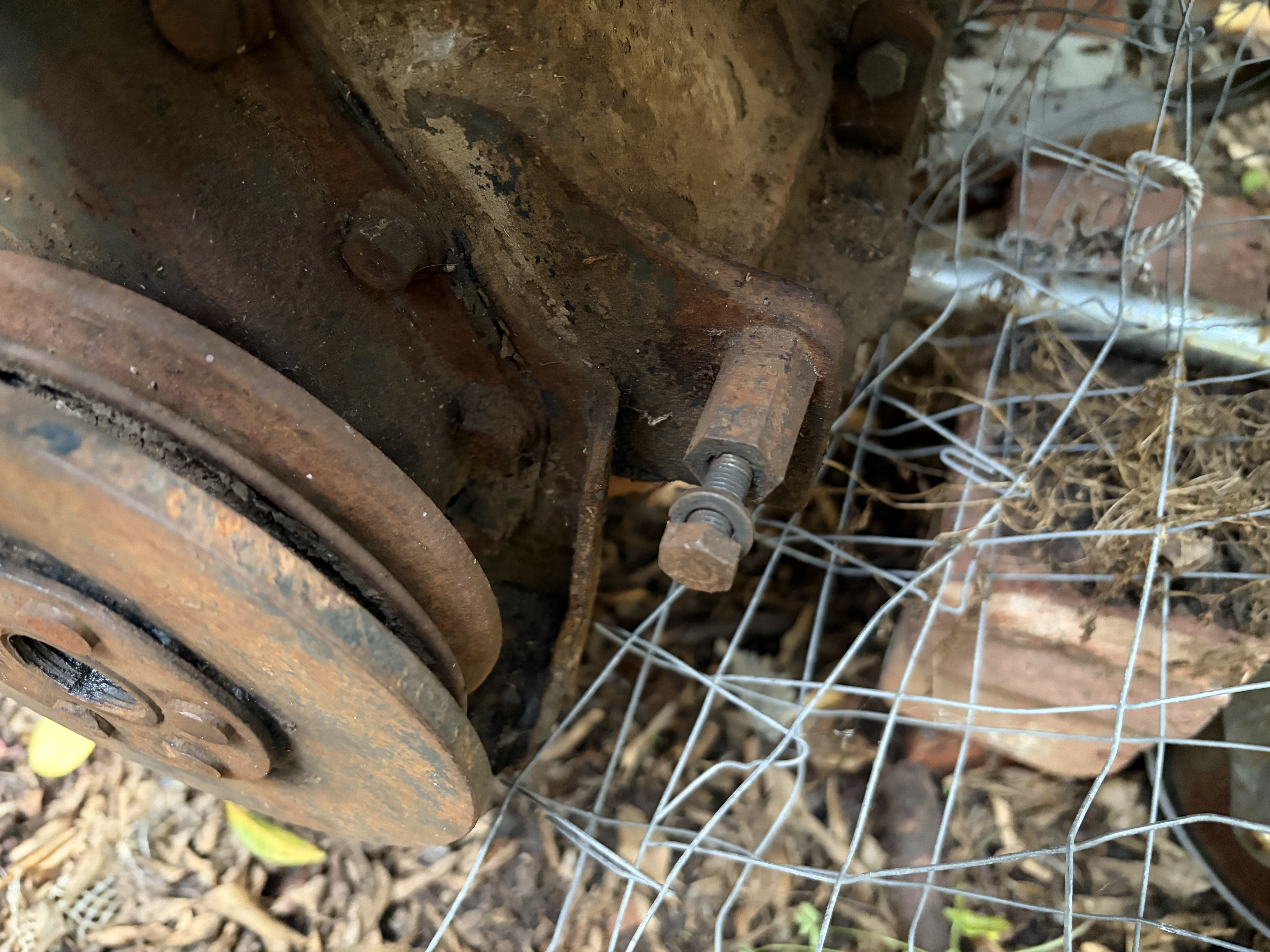

Re: Are you Bored? Bang for Buck Engine recipe required.
Hey Ed,
I think this is the hex part Rob is referring to. This is on a B block engine.

Thanks for the Photo Stephen.
I am still learning different things about these Engines.
The photo of the B Engine is helpful.
That HEX Boss appears to be quite robust, assuming that is the reason for the change.
I would think that the Sonic Injection Alternator bracket should work with all the different Grey Motor Block Castings.
Thanks Guys for the input.
Ed.
