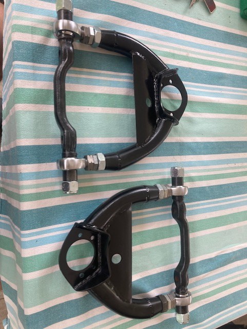

Today I took delivery of some custom upper control arms that are adjustable via rose joint adapters. This will let me align the caster / camber and lock it in on a more permanent basis.
It will also allow me to use rubber bushes on the bottom arms that will help dampen road noise. All i have to do is drop the front end out and do the replacement, argggghhh, not an easy task.

Hi BC,Bushcreature wrote: Thu Feb 19, 2026 6:20 pm G'day Greg, where did you source these upper arms from?
Thanks.
BC.
Here
https://www.facebook.com/marketplace/it ... 548b985868
Not 100% happy with the quality, i am fussy though, just little bits like welds and slight alignment diiferences between the 2 arms, they will adjust out but i have OCD !!!!

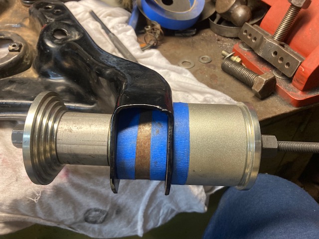

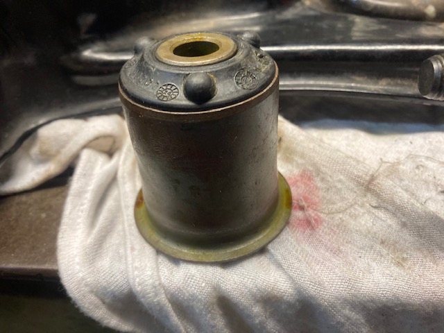

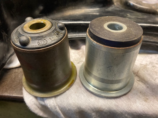

So after doing 6000 kilometers i thought its time to sort out some stuff im not happy with, mainly the wheel alignment and the way its adjusted.

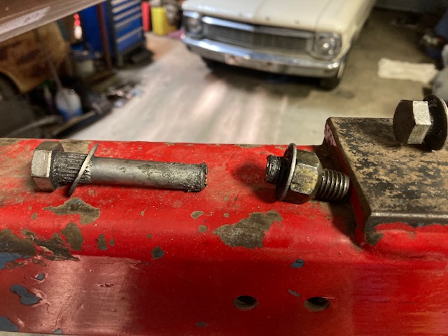

I had a custom set of adjustable arms made up with rod ends and two way adjusters to get the camber and caster right, I will put rubber back into the bottom arms and get rid of the offset poly bushes. Just too hard to keep everything aligned and lucky i checked because one of the bolts holding the arms in was broken !!!

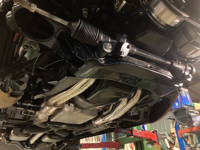

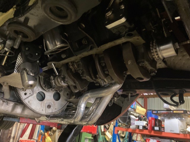

Whilst Im at it im going to remove the sump and replace the high volume oil pump, theres a bit of brass in the oil and i suspect the cam is wearing the shim behind the cam gear, notorious with HV pumps. The extra pressure on the distributor gear forces the cam back and loads up on the shim. A new torrington roller bearing has been ordered to fix this issue, and ive seen these before with the chevs. A new standard volume and pressure oil pump will go back in. Anyhow a few days work ahead of me, probably more.
Its quite dirty underneath now, but i have driven in the rain and on dirt roads, will have to scrub it as well.

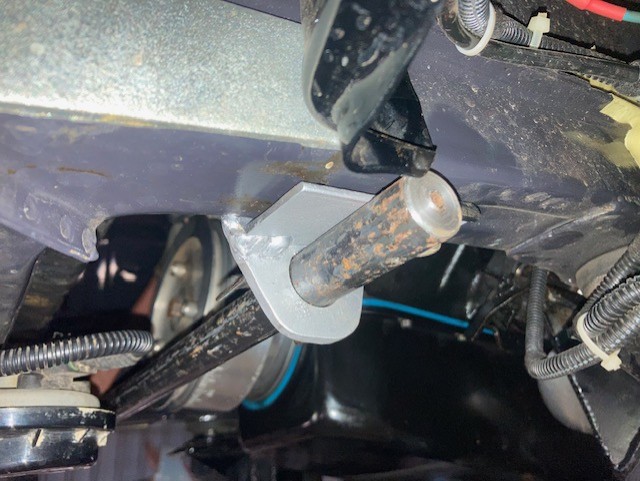

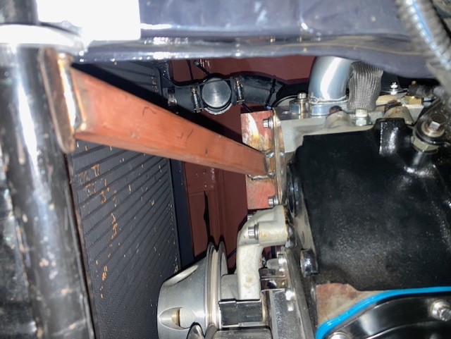

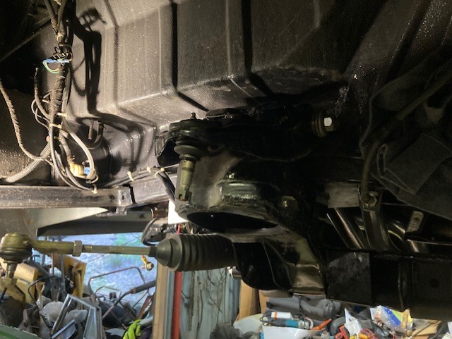

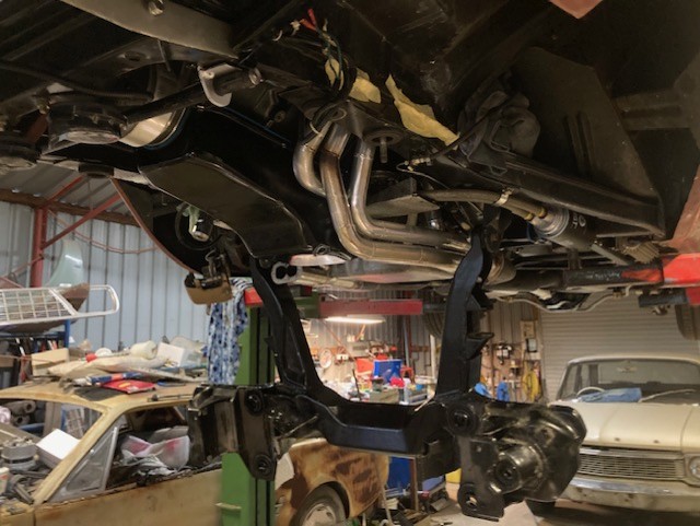

Progressing well made up some brackets that utilises the sway bar mounting position.
A bar and a couple of supports to the heads and the engine can now stay put while I dropped the front out. I had a bit of luck and the subframes swings down without fouling anything.
I've replaced the timing chain thrust bearing with a torrington roller and im putting in a standard oil pump cause my bearing clearances are at optimum gap. More work this weekend.

Clever mate. Some kooky Torana dhit going on there. Now you can drop the engine out with the pipes on if you wanted to?
Re: Chev EK
Ha, definately can't do it with the pipes on, but maybe with them off, ill look at that today, and to be honest never thought about doing it like that.Errol62 wrote: Fri Apr 24, 2026 5:37 pm Clever mate. Some kooky Torana dhit going on there. Now you can drop the engine out with the pipes on if you wanted to?
You might be on to something Clay.
Re: Chev EK
That is what I have seen people do with the LC LJs. They assemble the motor to the k frame, then drop the body on top.
