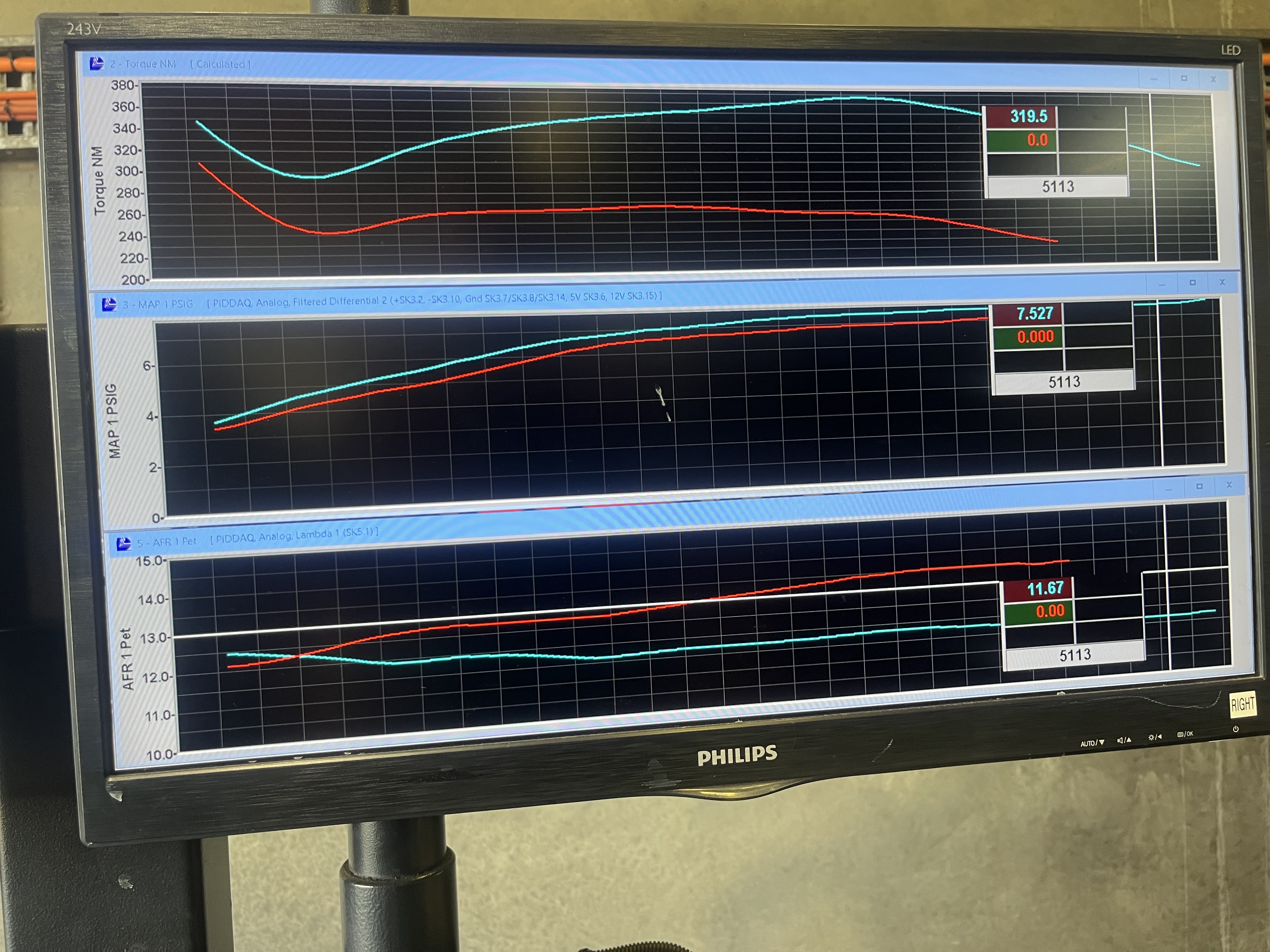

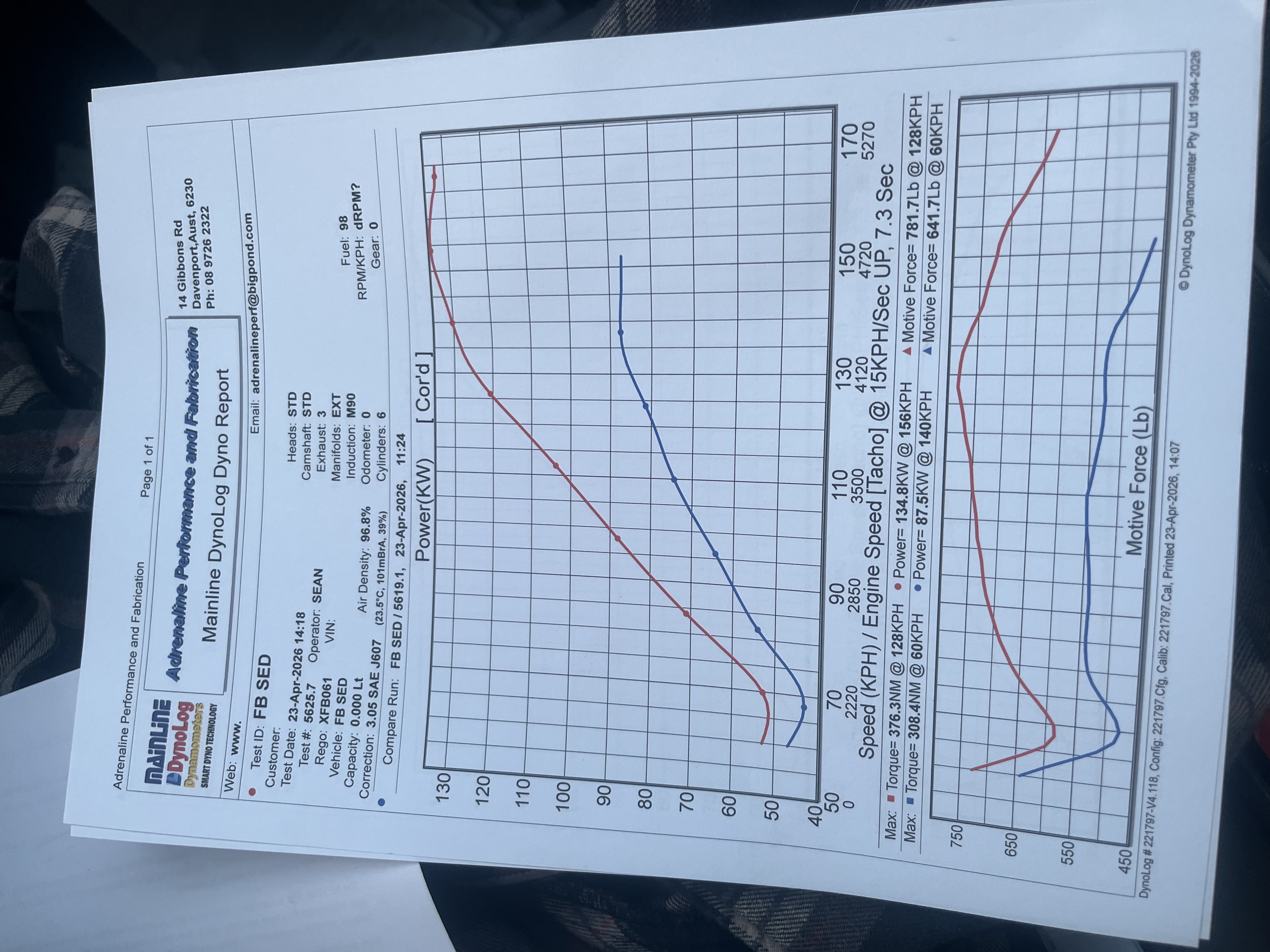

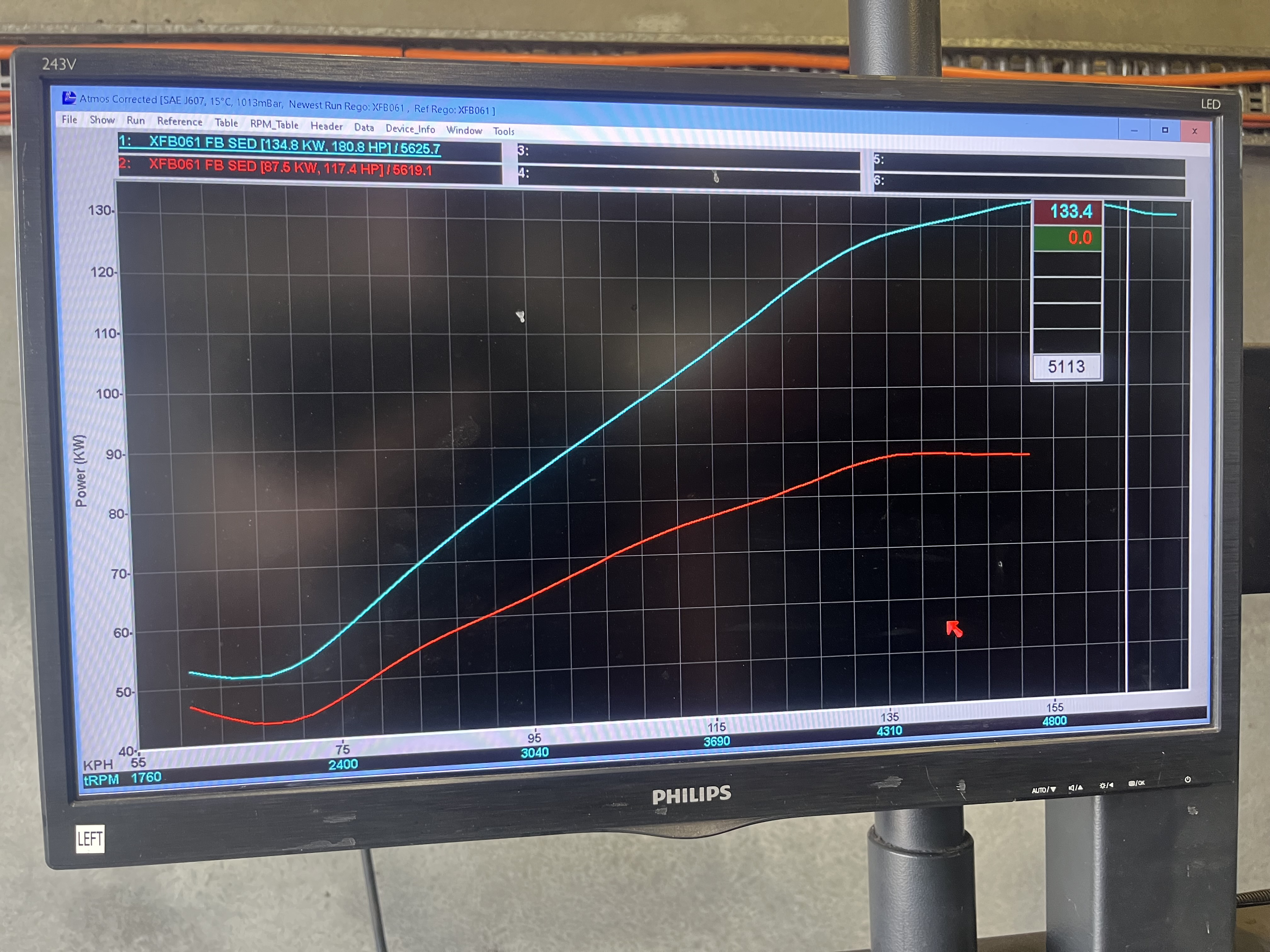

Well it’s FINALLY tuned and ready to party 🥳
Took it down to the timer in Bunbury yesterday, he reckons it would be far better with a Haltech computer in it rather than the EMS but it’s done now and will give it some time and see how it behaves.
Was a little disappointed with the horsepower number- I was hoping for 300/300 flywheel horsepower/torque , ended up with about 240 hp but was happy with the torque - it’s around 375 which is a nice bonus 😎👍 The blue lines on the pic below is what it was making at the start of the day, the red line is the final pull.

It’s only making about 8lb of boost which is probably hurting the hp numbers
