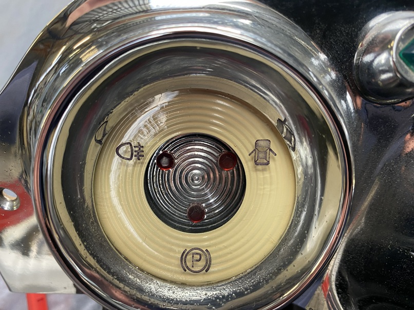

Now iI need some help wiring up the handbrake warning light. Yes
i can tie my own shoelaces but electrical wiring requires wizard grade thinking. :oops:
I'm using a HQ style handbrake which has single wire.
The warning light will been one of the idiot lights but update engraving,( P )

HQ style earth through the handbrake switch so power to the globe, then earth wire from other side of globe to switch.
simples.....

So I would like to add that the power wire should come from an ignition source and fused, probably the same circuit as your fuel gauge or something that comes on when the ignition is on.
As Blacky has mentioned power to the globe then out to the switch wire, this will ground the globe for the power to run through.
This is similar to the way horn buttons work, negative switched.
