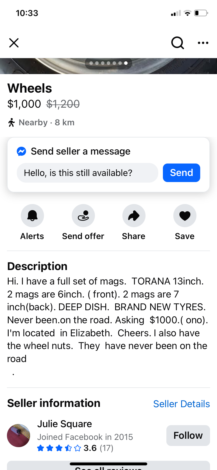

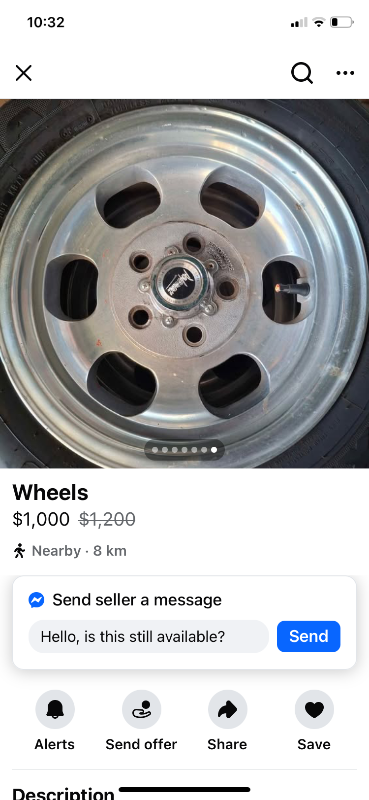

These were the wheels I was referring to, not jelly beans but Spitfires I believe.

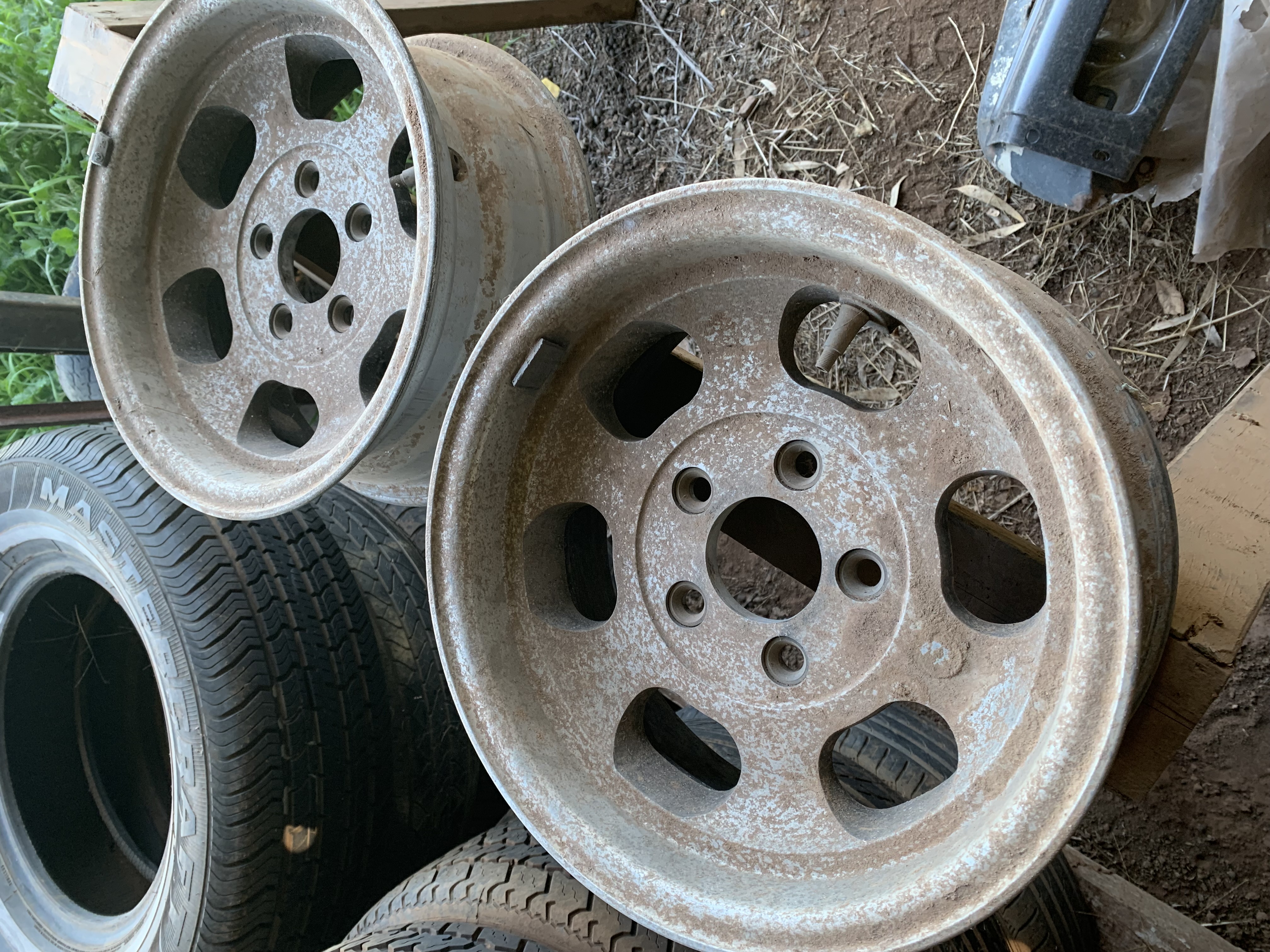

Some more schooling. Here we have a reverse stock 13”x6” on FB ute.
These are well over track and probably something like negative 15mm offset. Illegal in SA, be nice and sure footed but heavy steering and taxing on steering box etc.
These are the 13x6” on front of our HR front FB sedan.
The rim edge is close to the top control arm end and they are about 5mm within legal track, +8mm from memory. They fit perfectly. I got them made in about 89 at Adelaide wheel and rim.

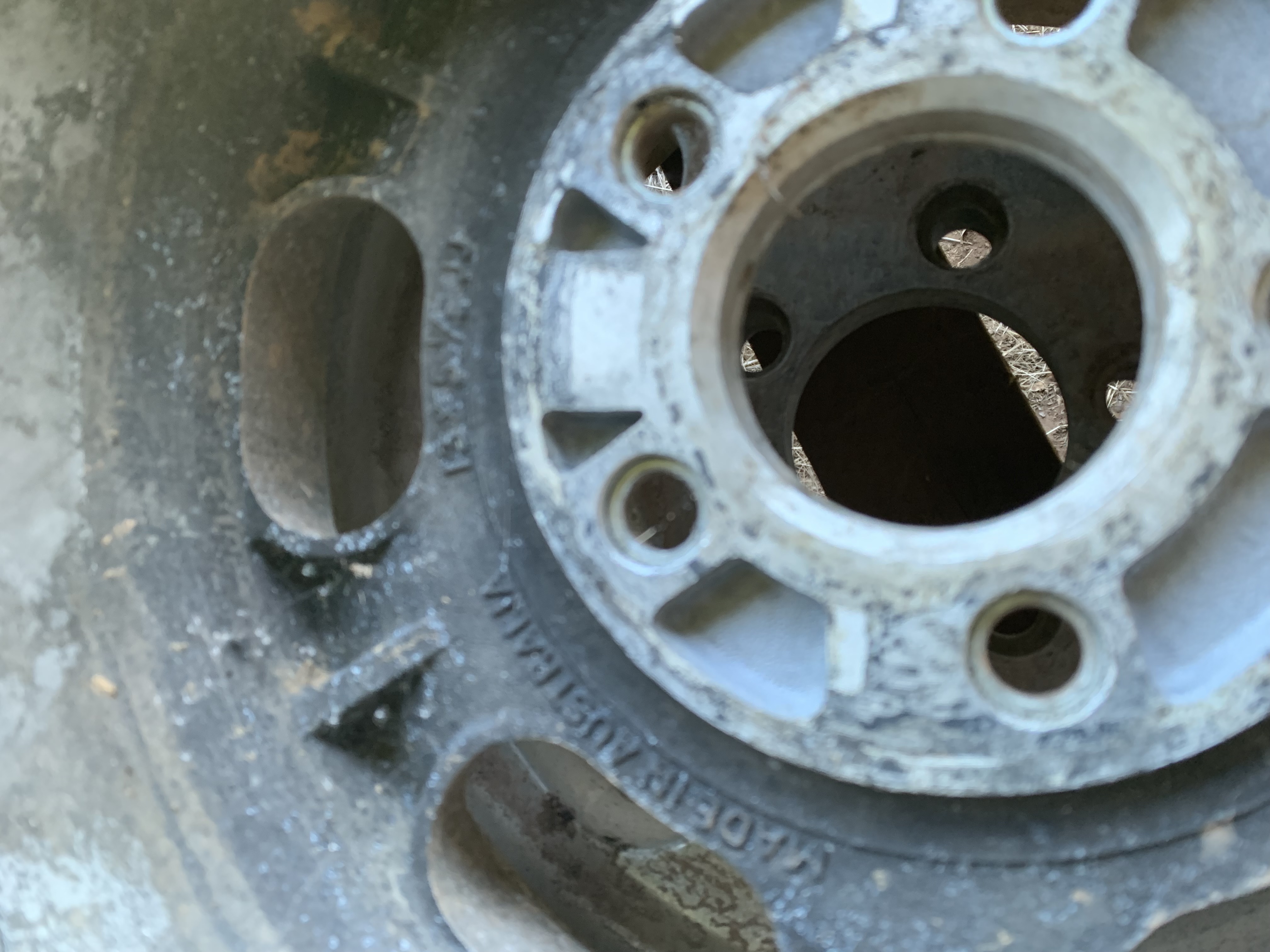

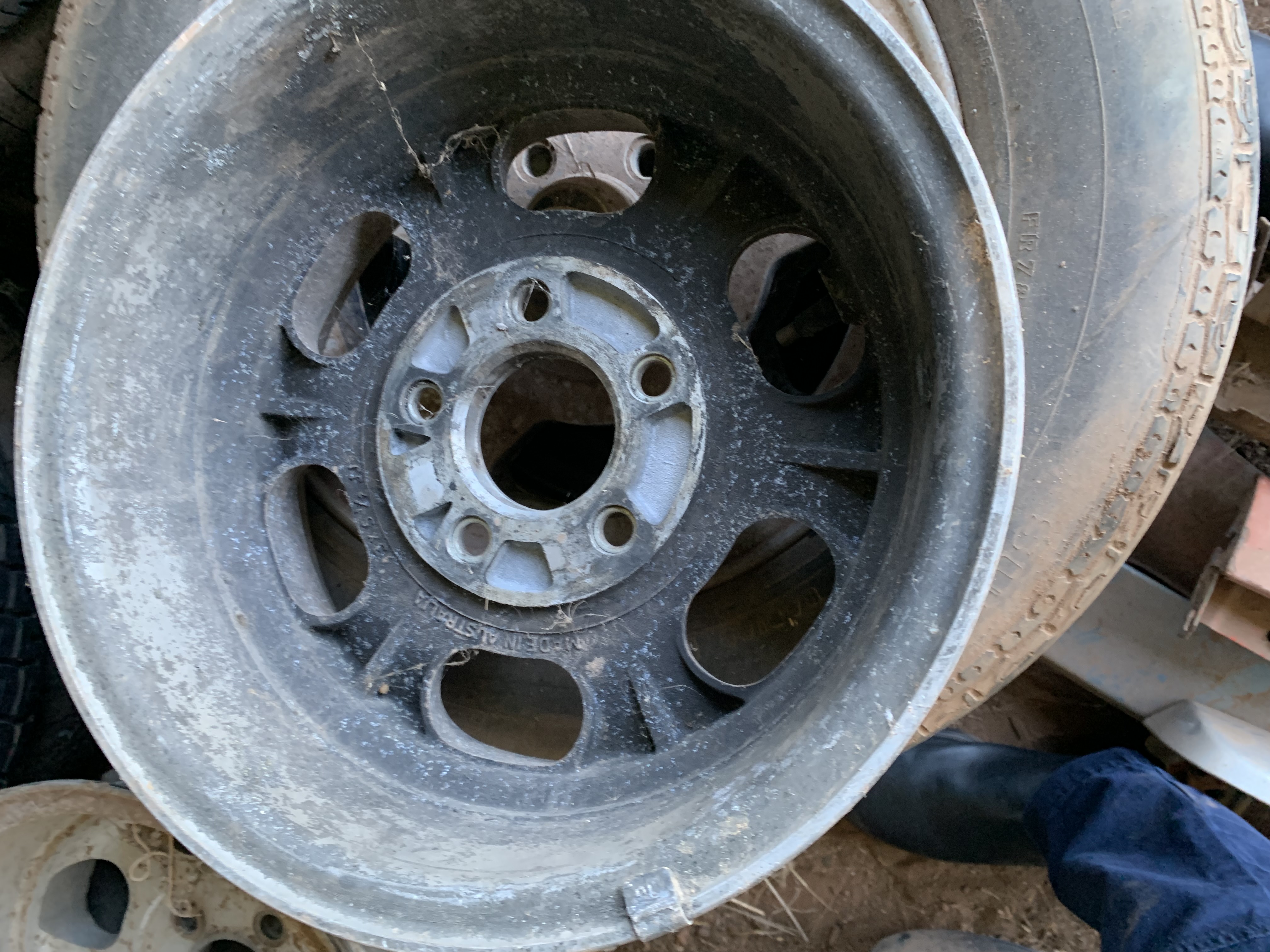

You know wheels, are these jellybeans any good for a standard king pin front end? They are 13” 5 stud but I don’t know if they are early Holden stud pattern? The backspace looks ok but I have not measured them.
John
Is this the sort of profile you have? If these fit you could run them on the front and deeper backspace on the back???
John
- IMG_5317.jpeg (2.16 MiB) Viewed 2307 times
- IMG_5319.jpeg (1.58 MiB) Viewed 2307 times
- IMG_5320.jpeg (3.16 MiB) Viewed 2307 times
- Posts: 2215
- State: SA
- Location: South Australia
Re: FB wagon front wheels
Correction, just realised they are 6 hole spitfires
