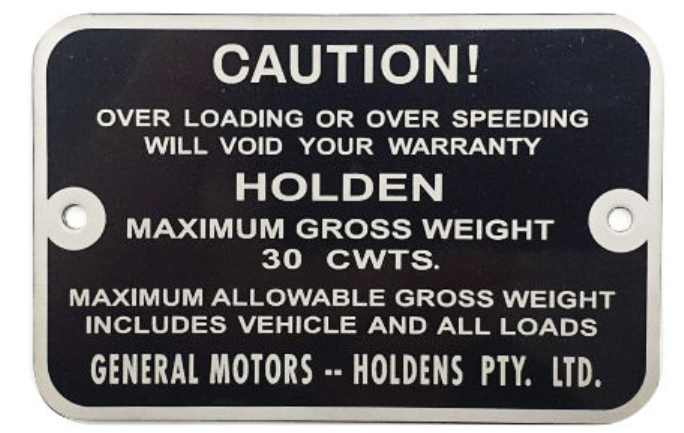

I think the only place I have seen the numbers listed is on the inner guard plates, that look like this:
These plates are being reproduced, and the various sellers list them differently (eg. one seller says 30cwt applies to a vehicle, another seller says 29cwt does). When I get home, I can see the unmolested plate on Grace's FB ute. If anyone has an unmolested plate from an EK ute, FB van or EK van then please post a photo here.

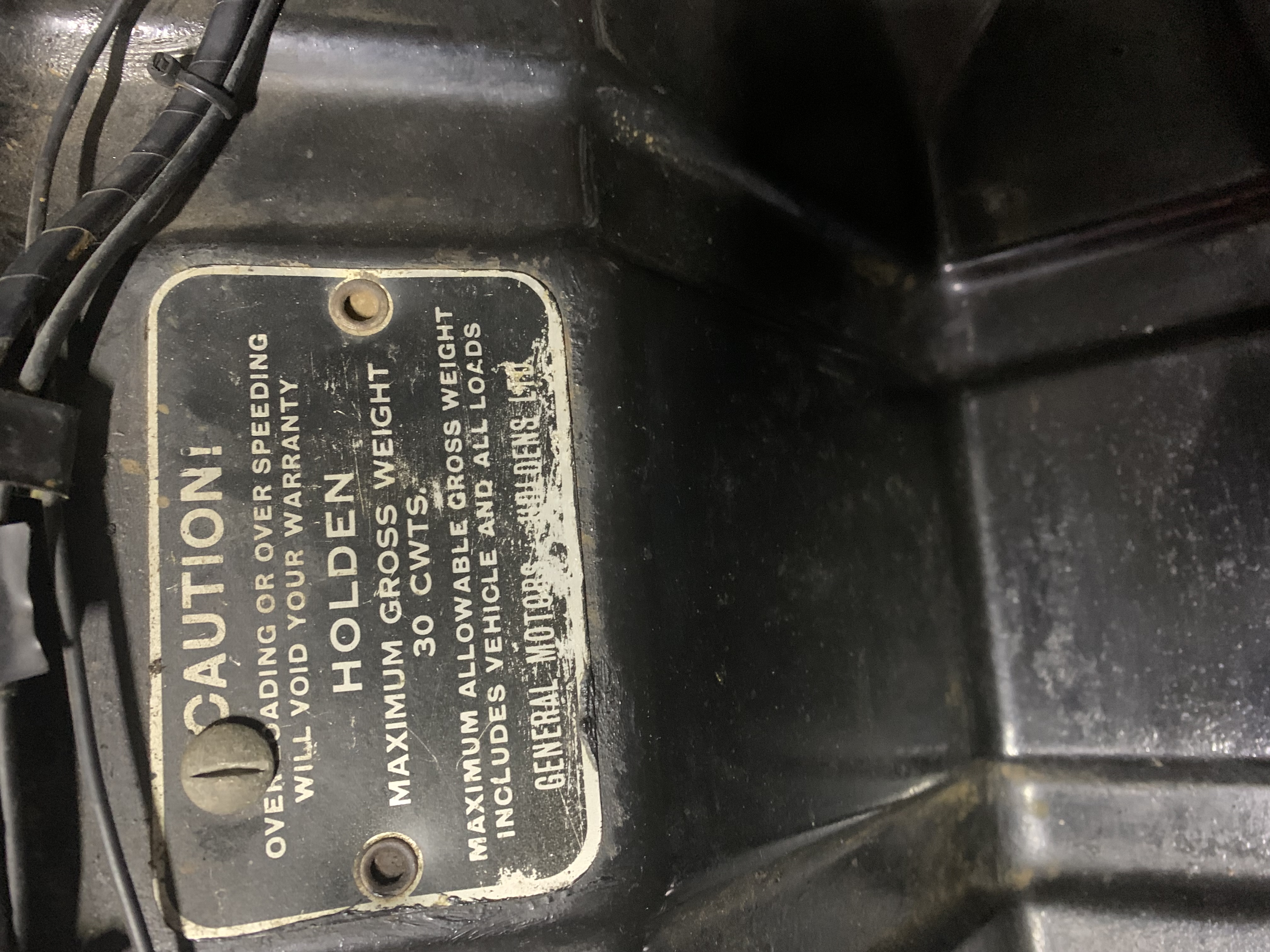

Re: FB/EK commercial maximum gross weight
You can just read it in this photo.

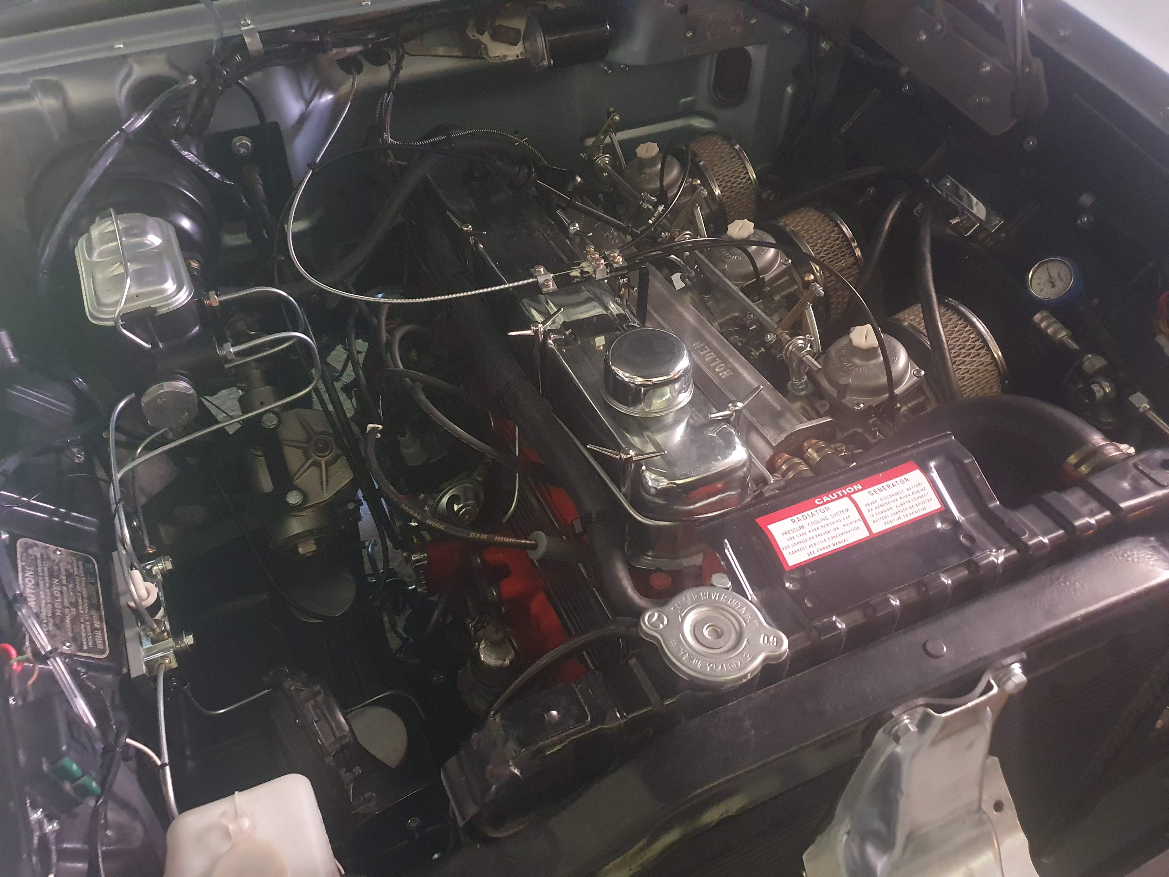

Here you go Harv, on my EK Ute
Omitted to add it has a FB subframe
My head hurts ….. but here is the tag on the ute - hard to read but not impossible
