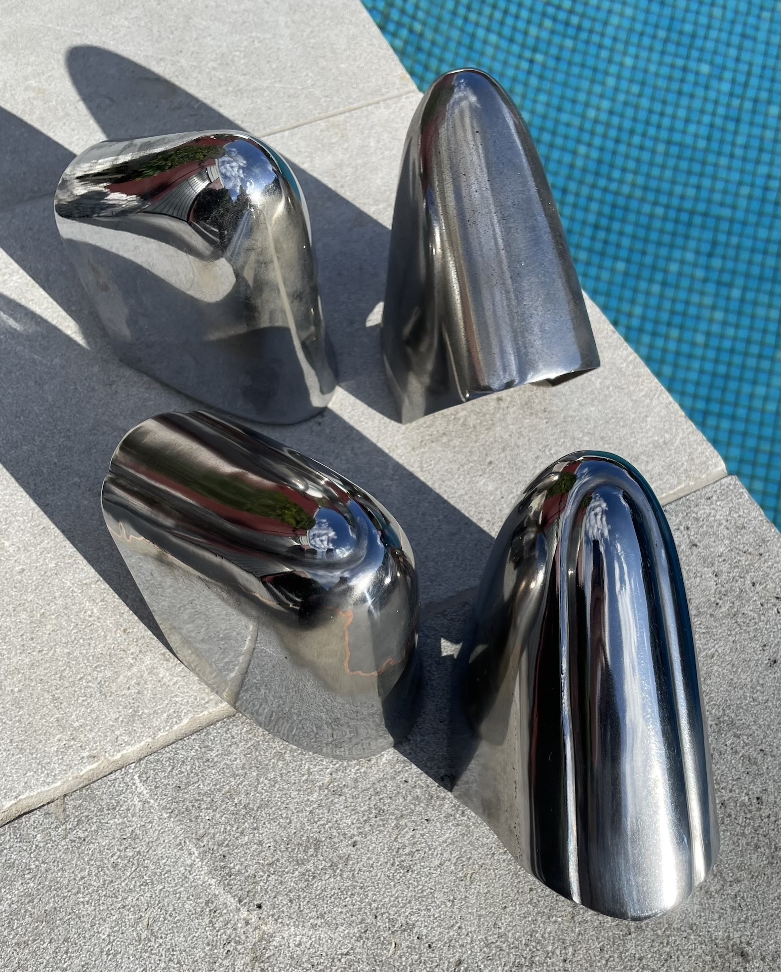

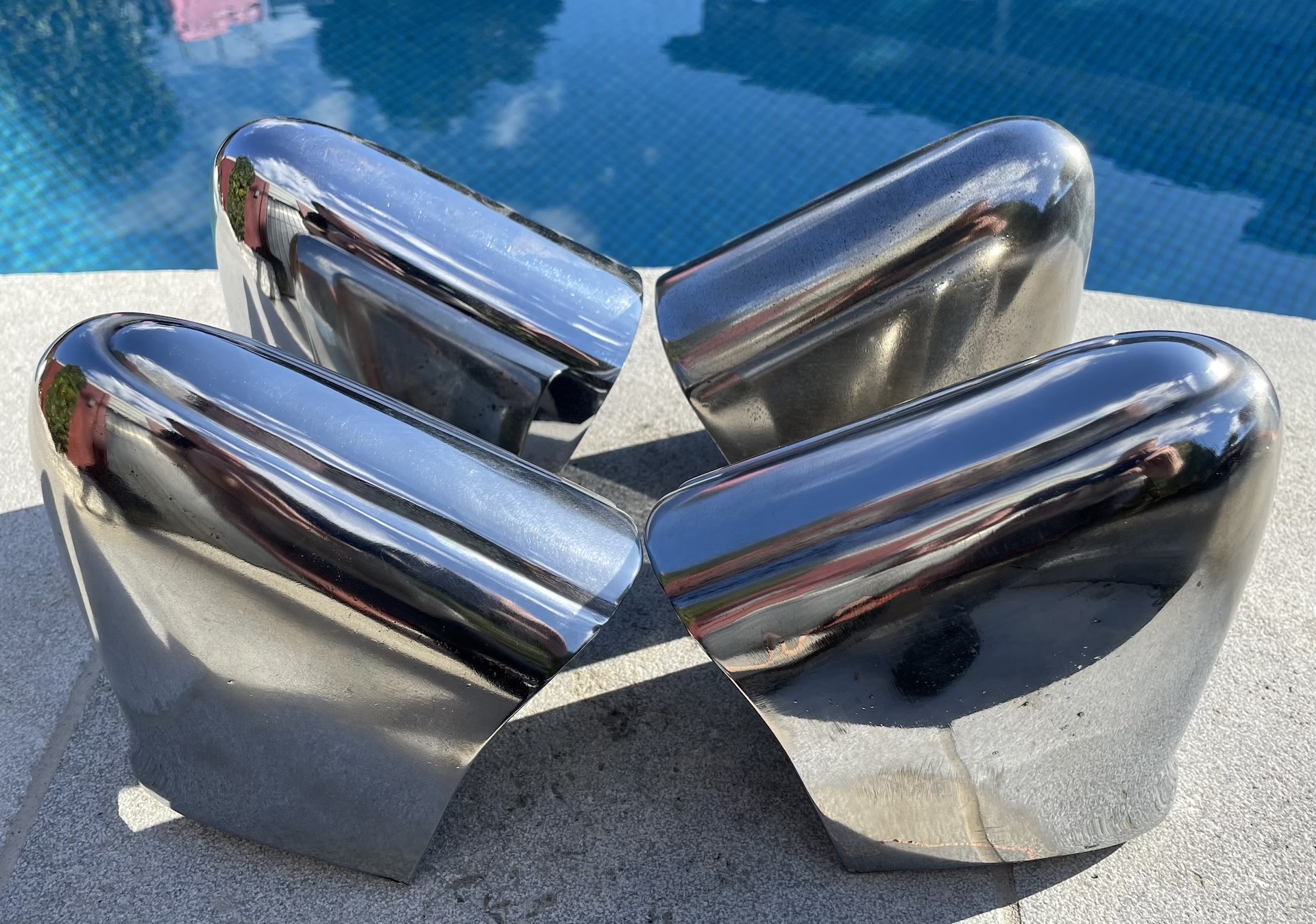

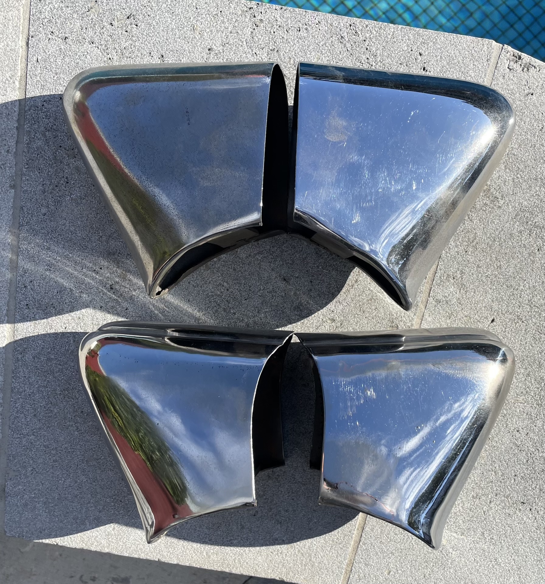

Did a separate post on how I made these overriders - https://www.fbekholden.com/forum/viewto ... 61#p275061, but I'll put the final results here as well as a reminder to me :roll:
Scott
