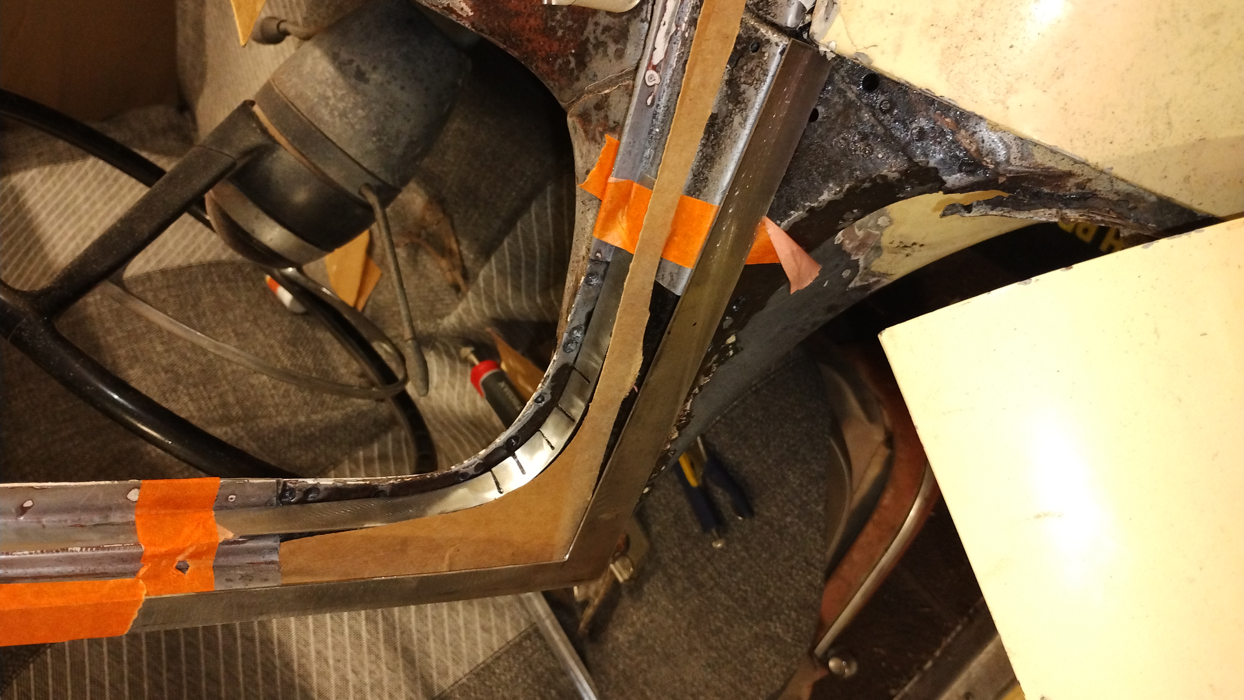

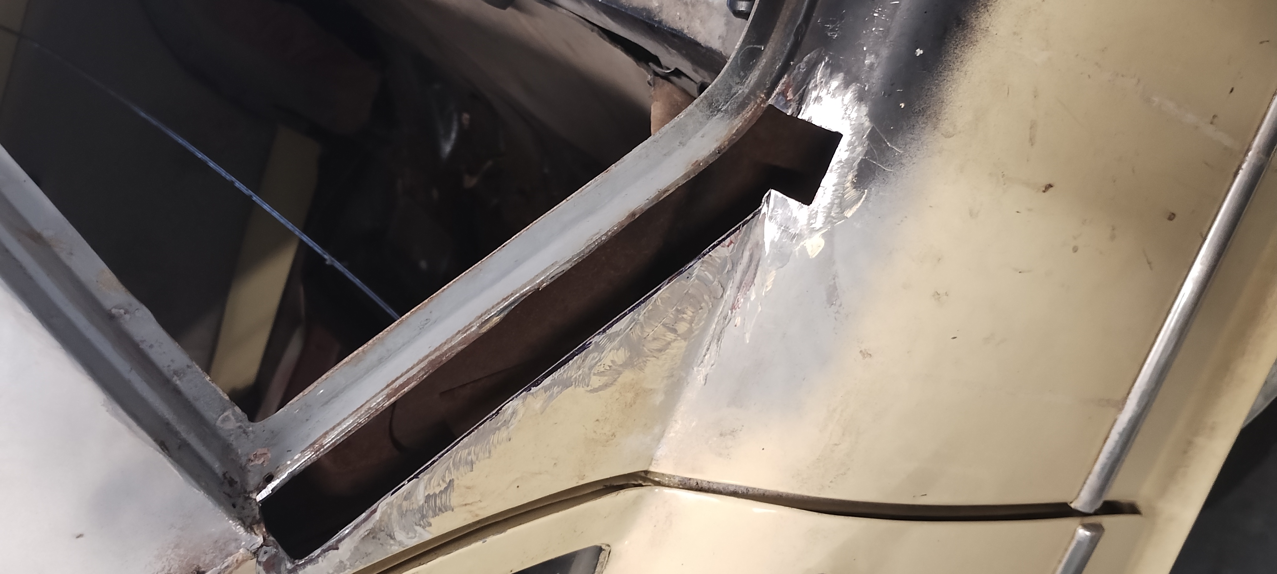

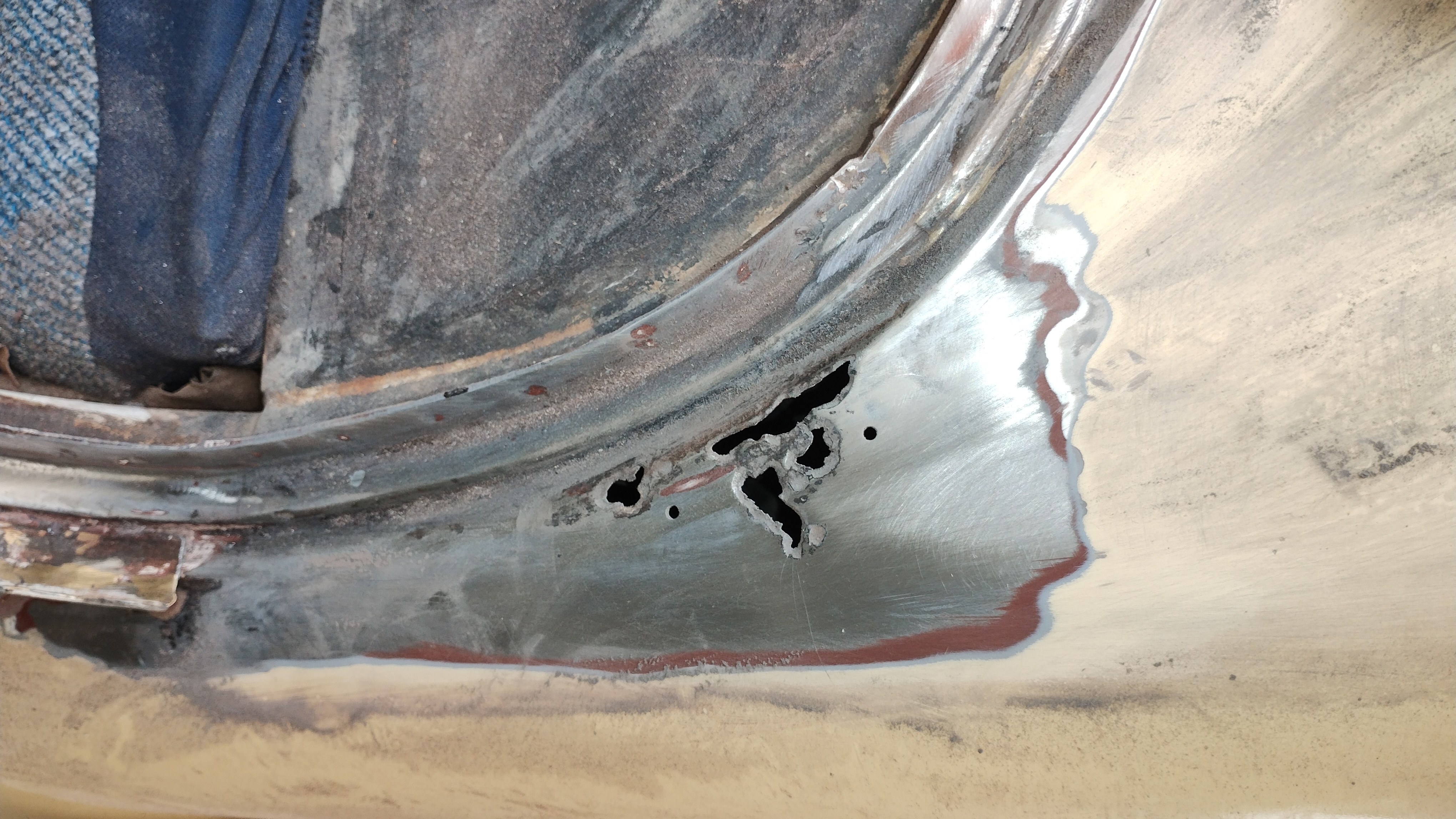

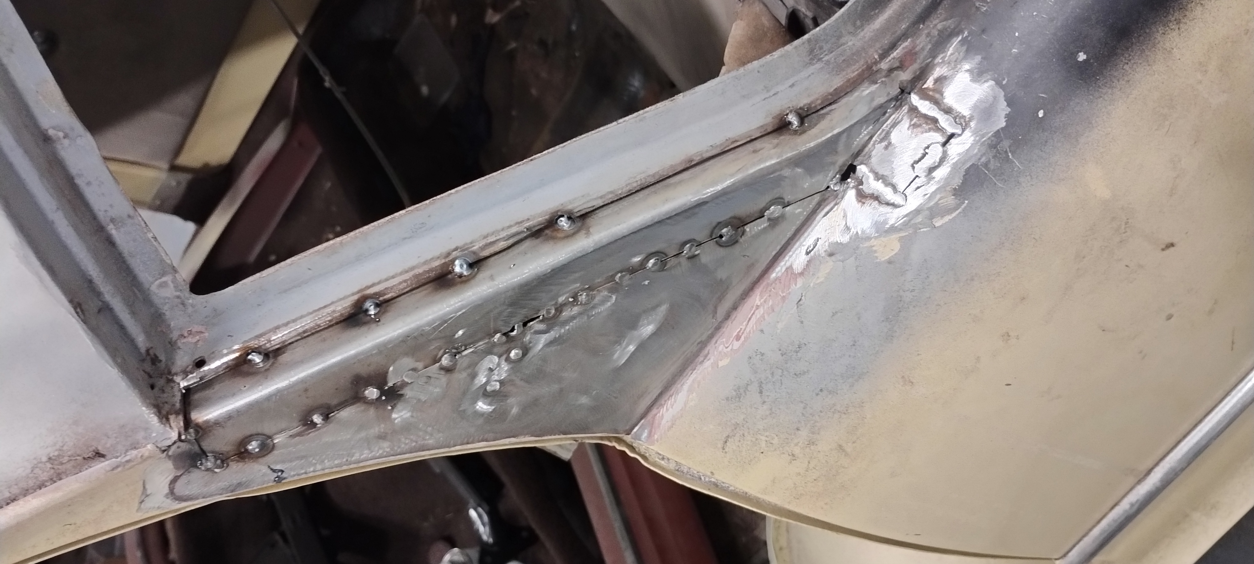

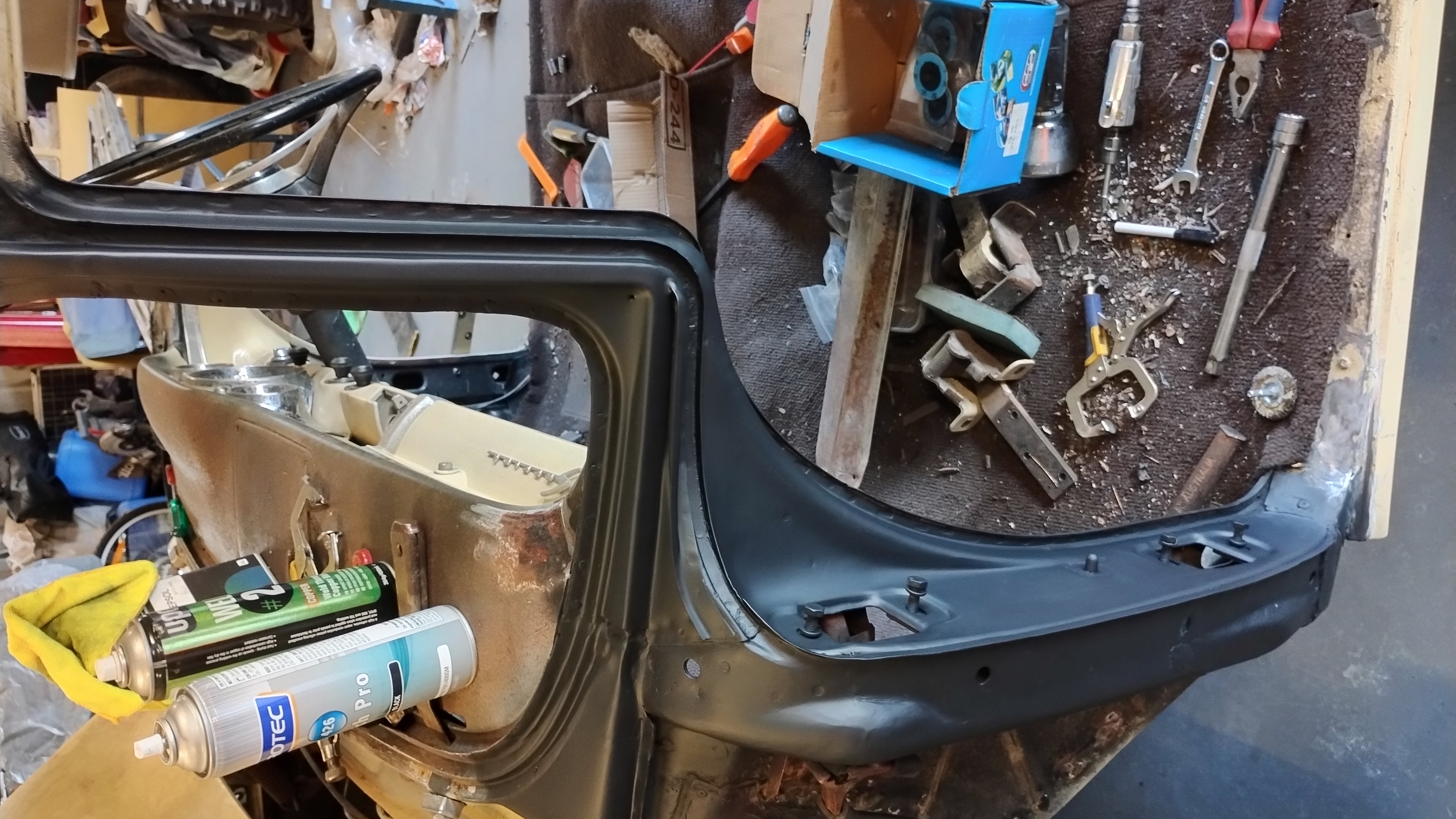

Just an update on some more rust repairs that I've been working on moved on these last few months.
Completed all the rust around the rear window. Next came the biggest job. Replacing the passenger side lower A Pillar and complete inner and outer sill. Man what a job but it's finally coming back together.
