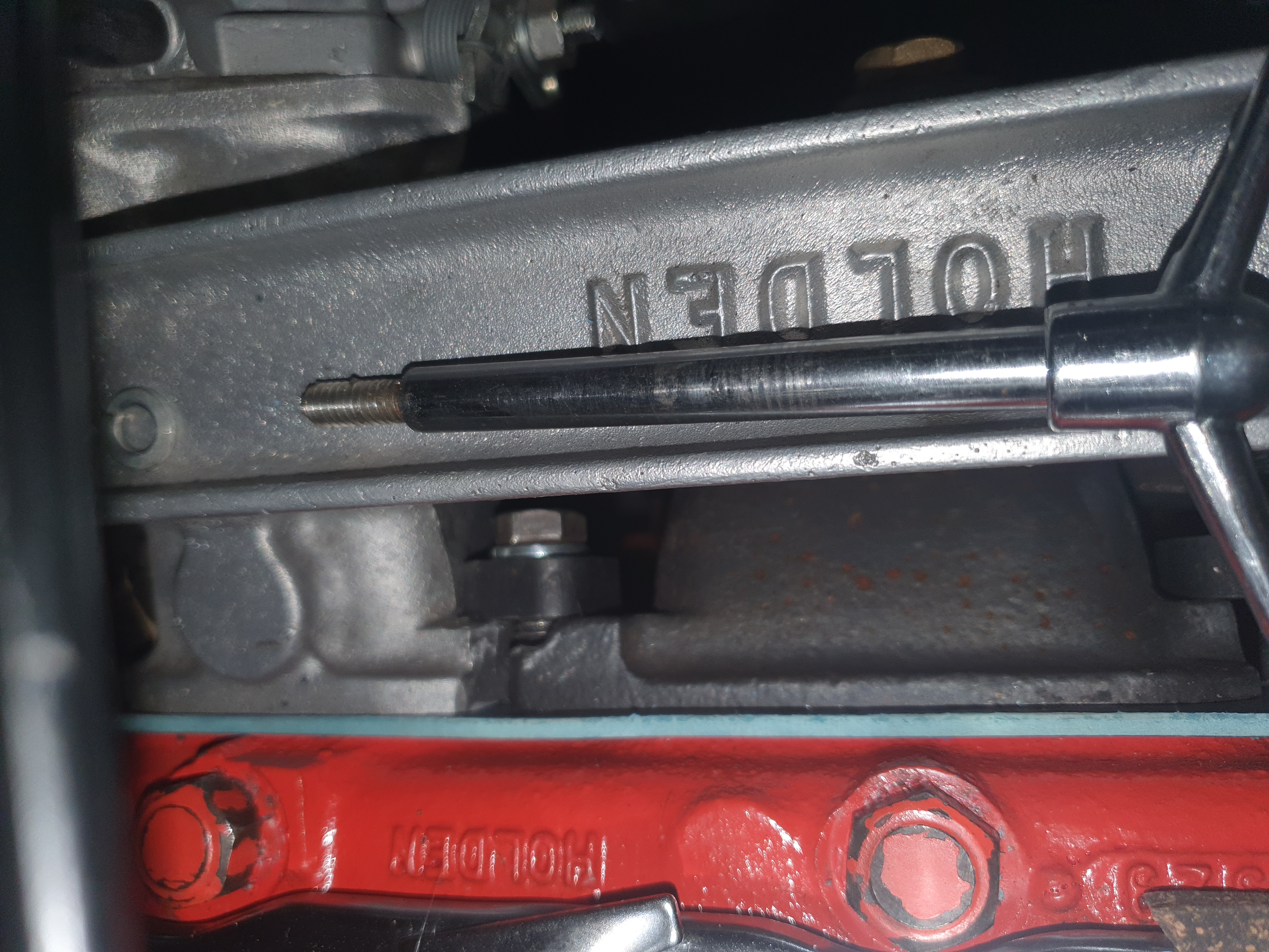

Hi Clay, I reckon you are using the wrong gasket. Get an extractor gasket from Rares. Very thick composite and can handle the variation between manifolds well. Highly recomend them. I have a set of solid steel manifold washers (I think from ebay). You can put a bit of pressure on them! - but I really think the gasket is the problem here.
Posts: 11599
Thanks for the tip Brett. I do have the correct washer in there now. It was pretty obvious that the smaller one wasn't clamping on the exhaust manifold at all. If it recurs I will chase up the extractor gasket.
Posts: 5722
The different heights/thicknesses of the two manifolds don’t help the washers. I use the bench grinder to step one side until the washer sits flat… then tighten well.
RAG but it works.
Posts: 11599
I levelled the intake to match the headers prior to installation. The main issue is the curvature on the 1-2 and 5-6 intake runners, which requires clearencing the washers. The gasket I used was recommended as the one all the HQ racers were using, but both offered were the composite type.

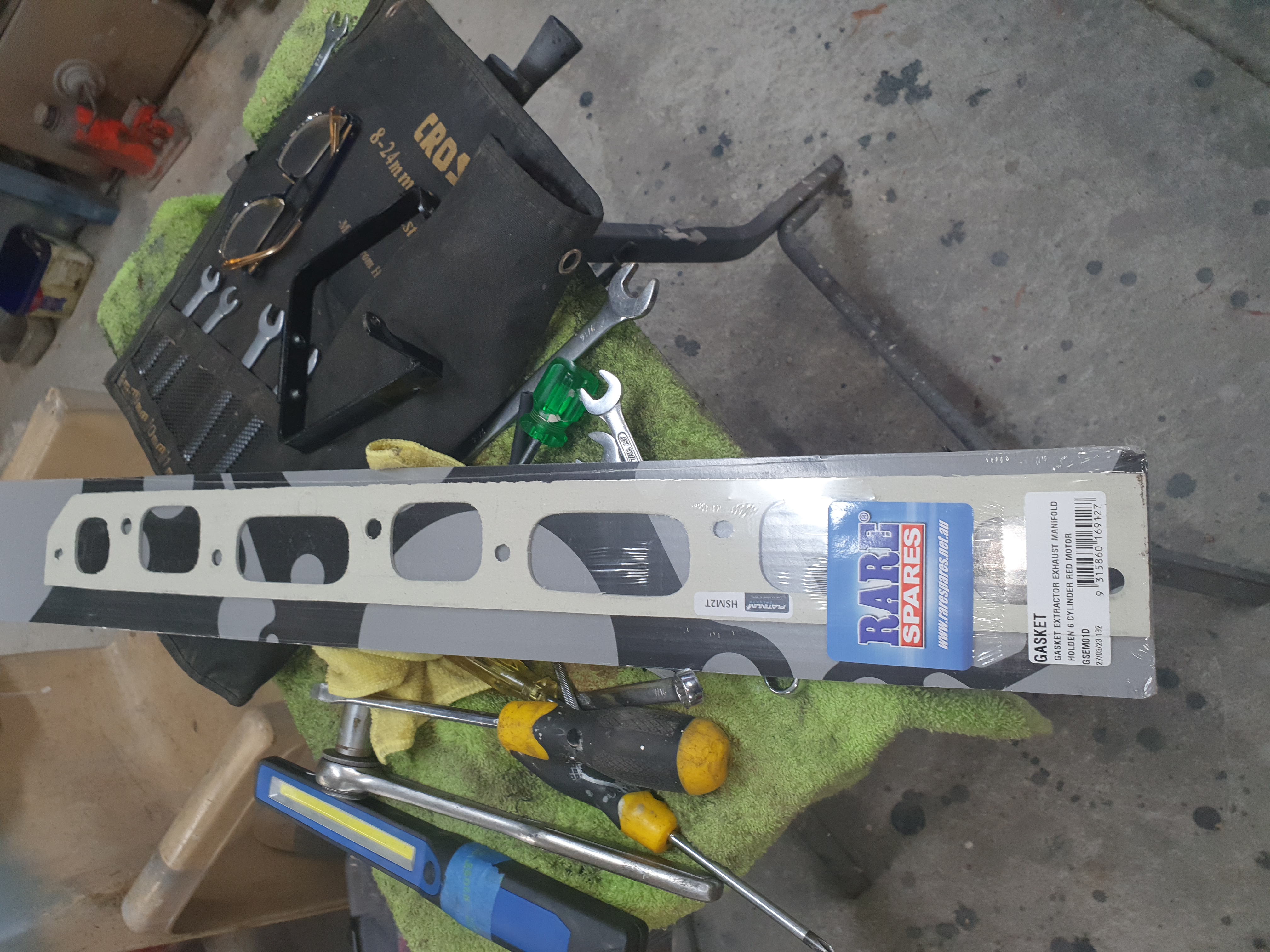

Posts: 2517
A few photos of what is working for me. Fortunately using Holden headers and intake manifold means everything is pretty level. However, the solid metal washers I have used allow you to take cuts off to level if need be. Photos of Rares gasket that works well and Permatex extractor gasket with metal covers. My own preference is for the soft sided Rares ones.
