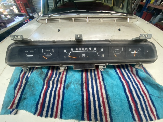

Was cleaning out an old Viscount caravan yesterday that I’m getting ready to flip and found this dash in the wardrobe.
Anyone recognise what model car it would be out of?
Gonna sell it I think.

Dunno , at first I thought Valiant but maybe its Japanese, any clues on the back of it ????
Re: FB Standard Wagon
VJ-VK Valiant.

No clues other than a stamp saying VDO AUSTRALIABlacky wrote: Tue Feb 27, 2024 10:03 am Dunno , at first I thought Valiant but maybe its Japanese, any clues on the back of it ????

Cheers Harv, it’s certainly no good to me so I’ll research what it’s worth and put a for sale post up on a Valiant page.
Thanks mate!

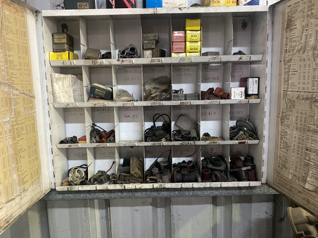

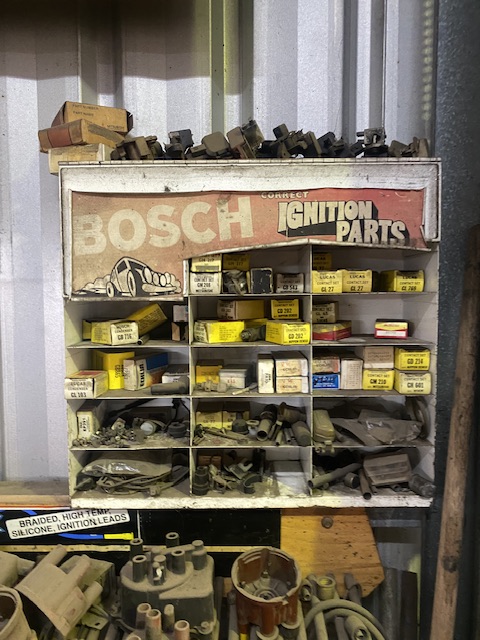

Hey guys. Thought I check back in.
I did something a bit risky and exciting today.
I went to a deceased estate workshop sale and came home with a shelf load of new and NOS parts.
Holden, &*#@, VW and god know what more.
Took all day to load it up and there is a lot there, it will take some time to work out what’s what but I can see there is some good stuff in there.
A couple of photos and I’ll post more when I get it layed out.
